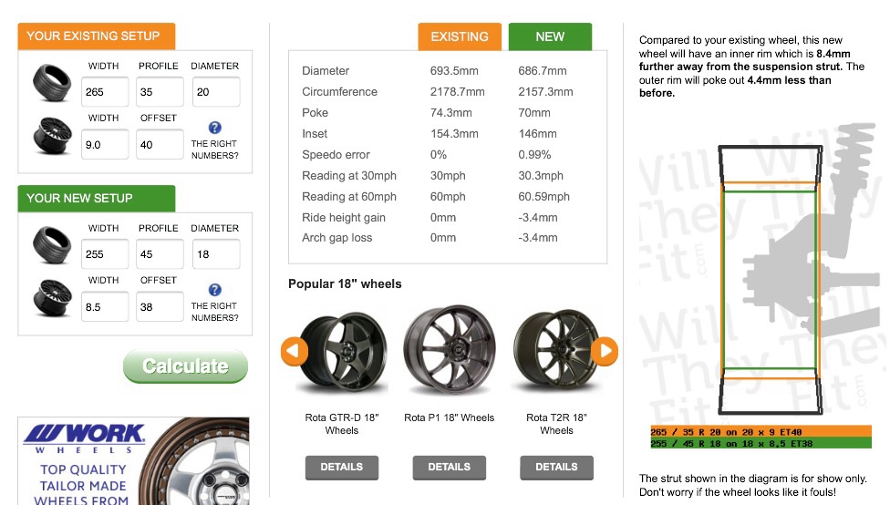

Apologies for the sudden barrage of questions - I've had an S8 looked at by the RAC and it has thrown up an issue with the tyres, and also the spare.
The report tells me that the tyres on the car are shod with 265/35/R20 tyres, as they should be.
But the spare is said to be a 255/45/R18.
I thought running different tyre threads by 4mm or so across the same axle was supposed to play havoc with the Quattro diff. By my sums, the spare will 6mm shorter than a regular wheel.

Old 16th August 2014, 07:47 PM
To be fair, apart from the wheels physically being such different sizes as a spare wheel it will work because the rolling radius is very similar as you will see from the attached, and that's what is important to quattro not throwing up any faults

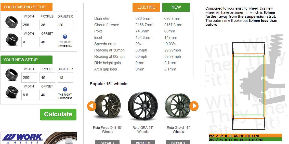

Old 17th August 2014, 03:40 PM
All D3 8s I've see sat either on 255/20 or 275/20
I've got 255/35/20 on 9J and as a spare 255/45/18 8.5J so they are identical
