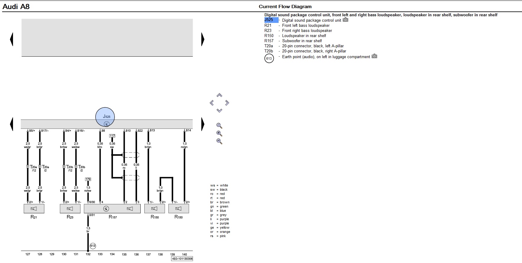

Old 30th September 2014, 09:56 PM
This ???
see attached

Old 30th September 2014, 10:00 PM
See attached

Old 1st October 2014, 07:19 AM
gadgetmind gadgetmind is offline
Posts: 21
That looks like it could be the one! I'll have a furtle this weekend.

Old 24th October 2014, 01:43 PM
Posts: 21
Hmm, no, not the right one.

Old 24th October 2014, 03:14 PM
Are you sure it is a 21pin connector?? I cant find such a connector on the drawings, T21 (21pin=3*7=21)
Anything specific mate coz there is a ton of diagrams for the amp??
