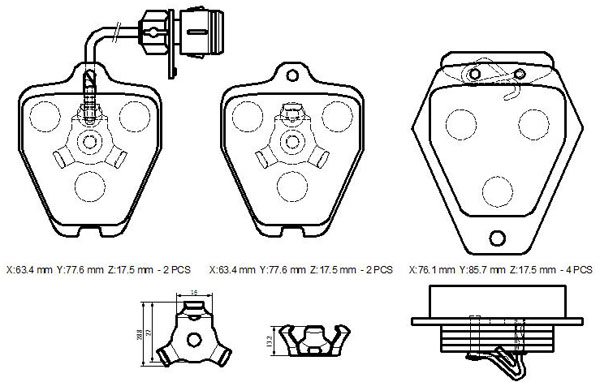

I use these on my 323mm brakes: http://www.ebay.co.uk/itm/BRAKE-PADS...obbuo21c5NWw0A
314mm and 323mm does have different part numbers but the pad itself is the same, it's just that the ones for 314mm have extra counterweight to reduce vibration, noise & squealing but 323mm doesn't to save the space and not rub on 16" wheel as the pads sit further from centre on 323mm brakes.

So in theory, could my A8 run the 323mm rotors? I'm running factory optioned 18's, .... just that the 314mm were a pain to locate (here in australia anyway) and the 323mm was everywhere pretty much
Still waiting to hear from Winmax Japan to see if their WMP326 pad is the one I have, ... as its listed as the ATE S8 Pad, .. but no diagrams to be found anywhere
