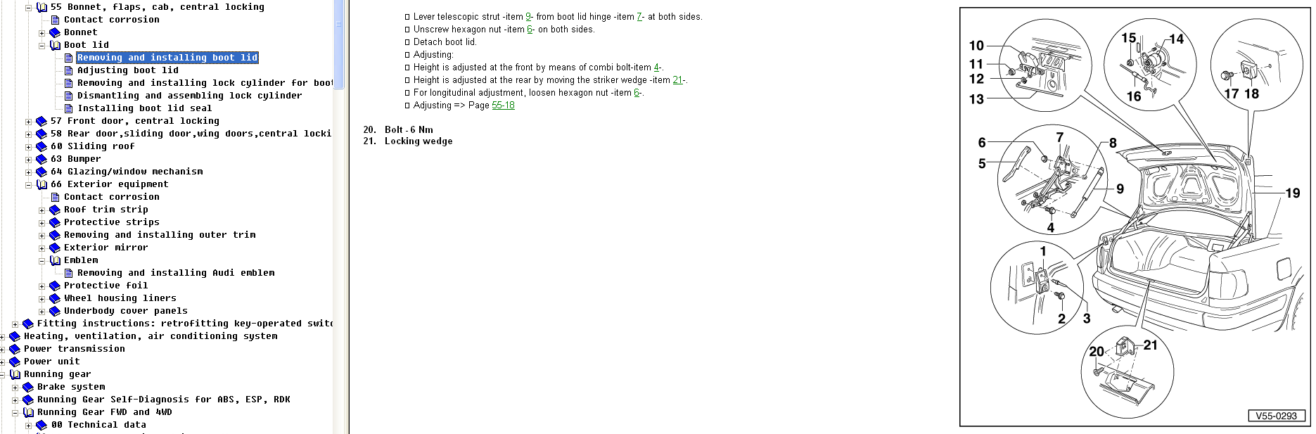

Resurrecting an old thread, as the boot lid on my A8L D2 needs adjusting.
See attached pic that I snaffled from ELSAWIN...
Name:	Screenshot from 2015-06-28 15:56:10.png
