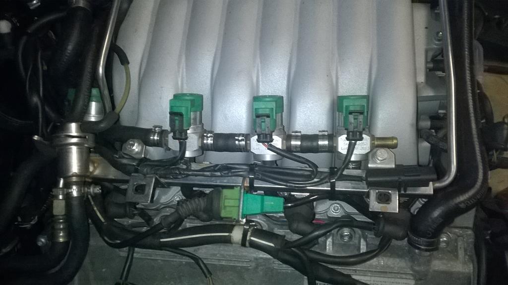

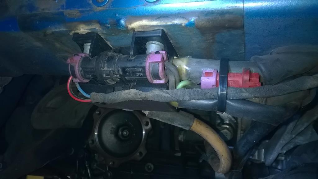

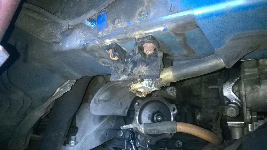

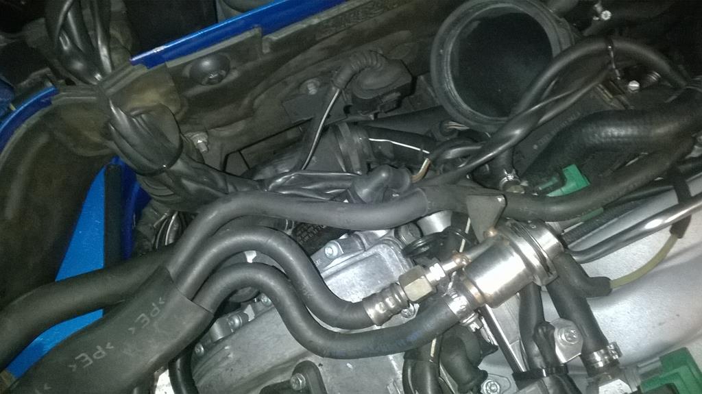

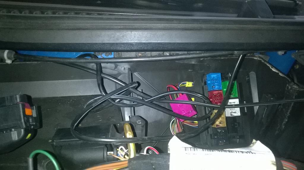

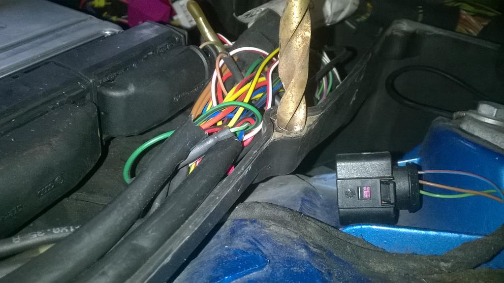

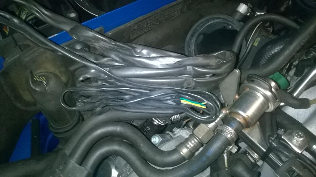

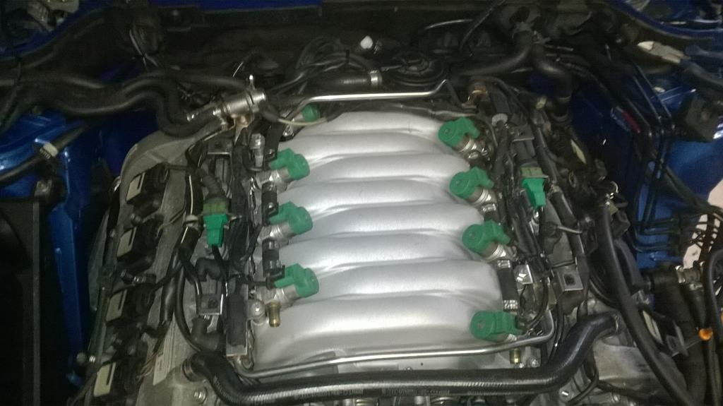

I spent some time tidying the LPG wiring. The injector rails are nice and neat.
I didn't much like this big bundle of wires
So hid it in the e-box The LPG wiring mostly follows the route of the factory harness now.
Nice and tidy

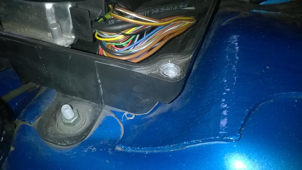

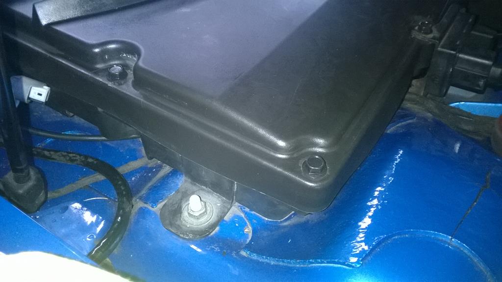

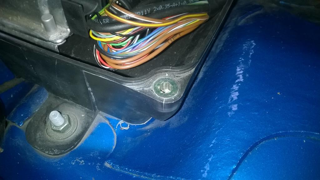

I noticed the washer jet pipes and wiring were hanging down and getting in the way of the e-box lid so removed the scuttle trim. I'll fix that later

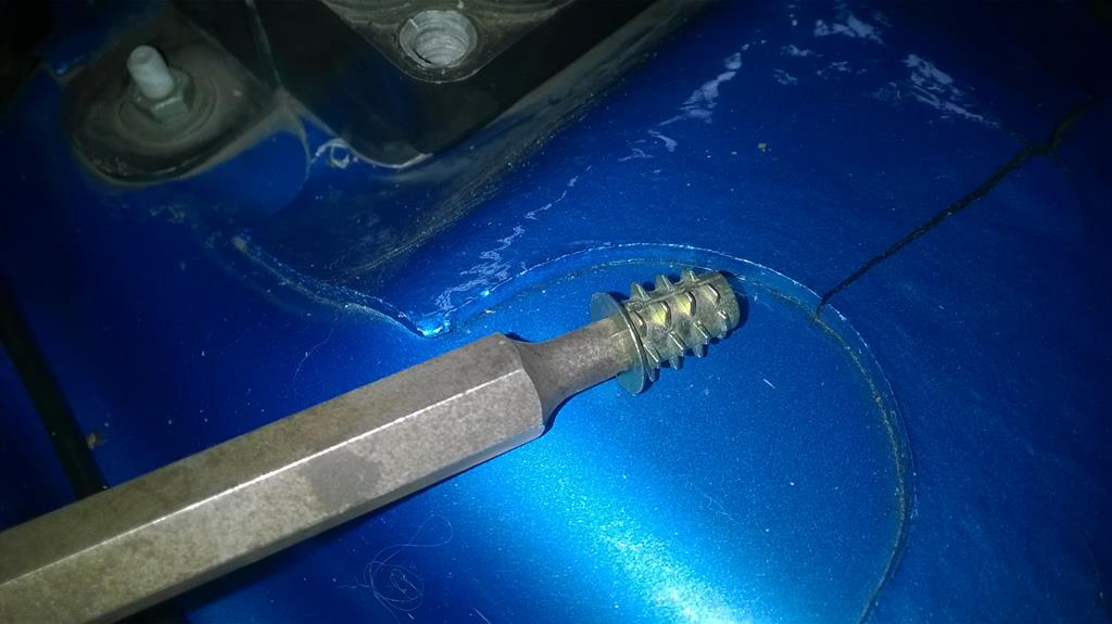

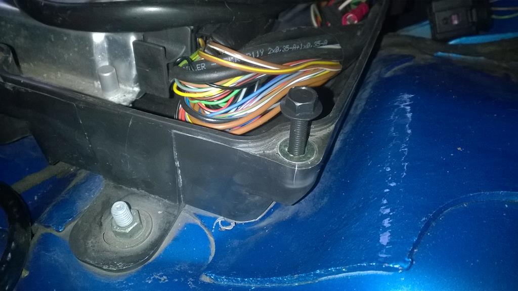

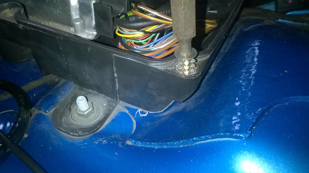

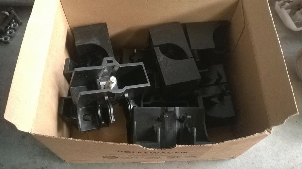

Of course the e-box screws were all seized as usual and had stripped out the inserts
Apply the usual fix
Countersink
Insert the D-nut
Insert inserted
New bolts
Sorted
Ready to put the front panel back on

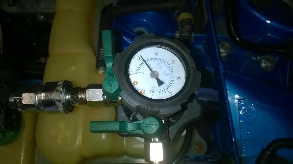

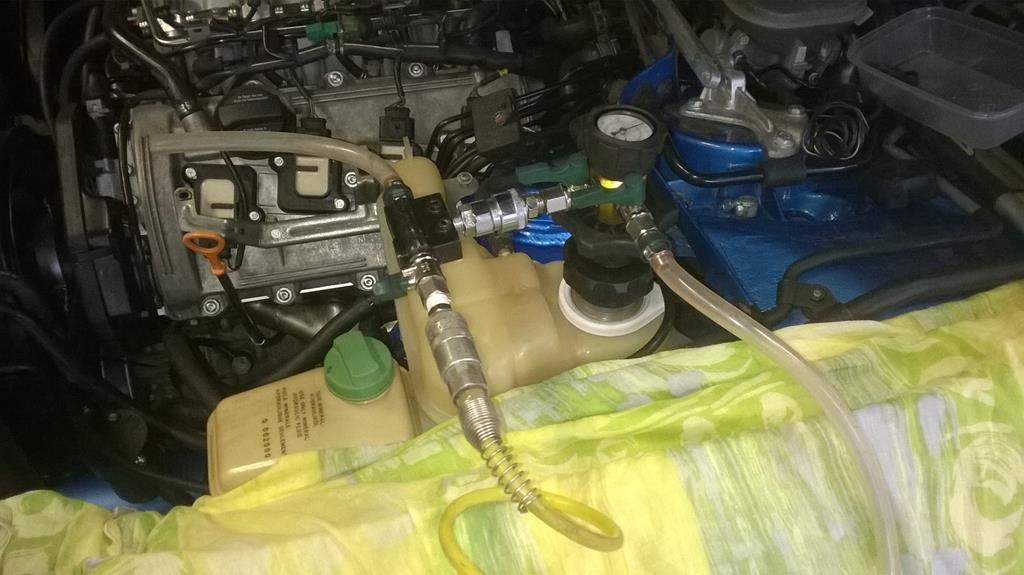

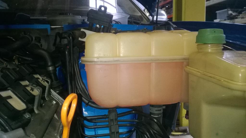

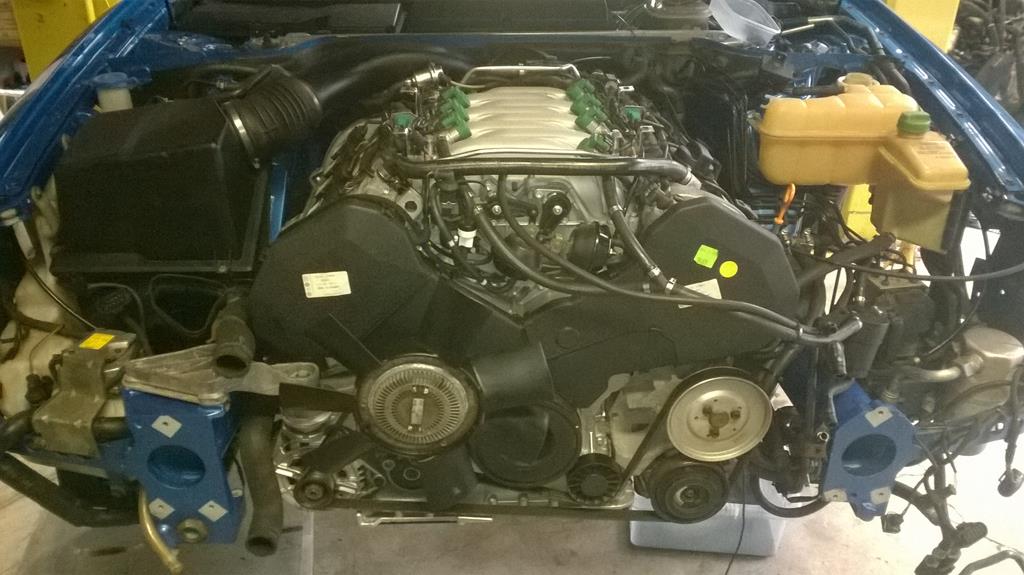

I'm using a vaccum tool to fill the coolant. Normally a V8 will fill easily but with the aux heater and LPG I want to avoid any chance of airlocks. This tool uses compressed air passing by a venturi to pull a vacuum on the cooling system. Once it's got a decent vacuum you can leave it for a while to make sure it holds (therefore checking for leaks) and then open a valve to suck in fresh coolant.
Partial vacuum held for about ten minutes
Much gurgling later, 10 litres of coolant sucked in

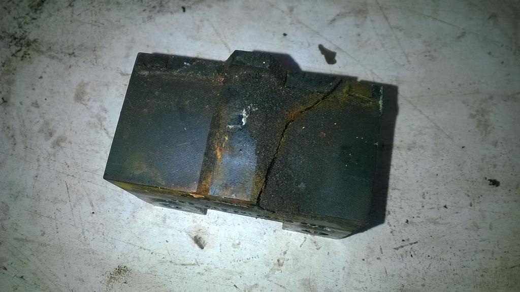

Moved on to the starter junction box

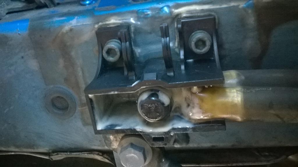

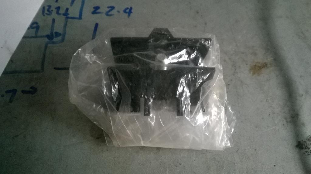

Cracked as usual
This is the last ever prefacelift junction box
Luckily I have plenty of facelift versions which are actually better as they are closed at one end so I will fit one of these instead
Filled with spray grease
Fixed

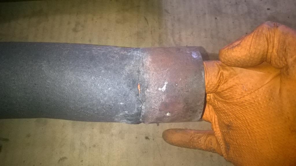

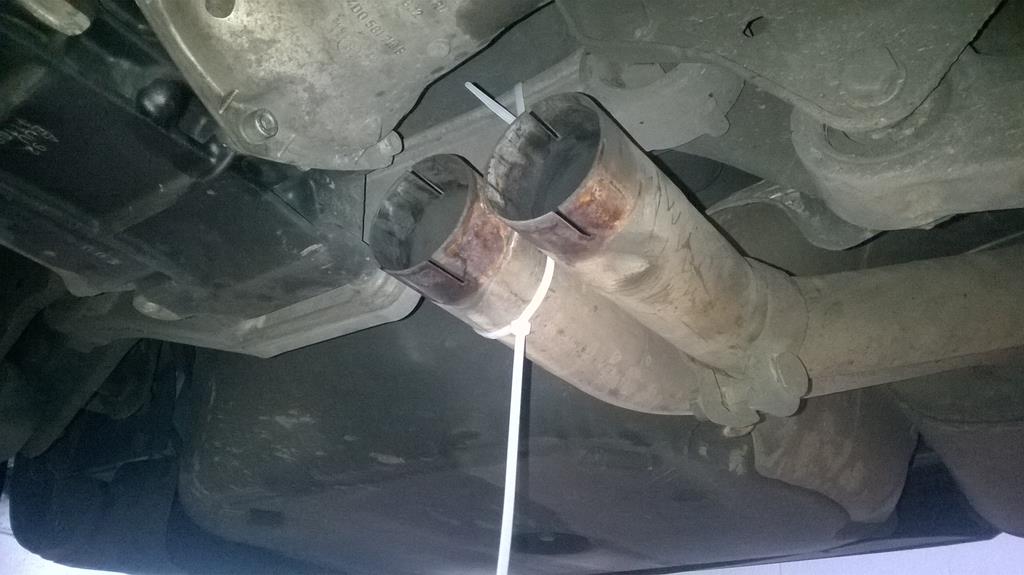

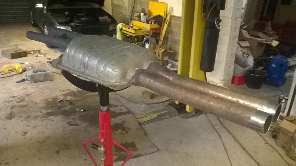

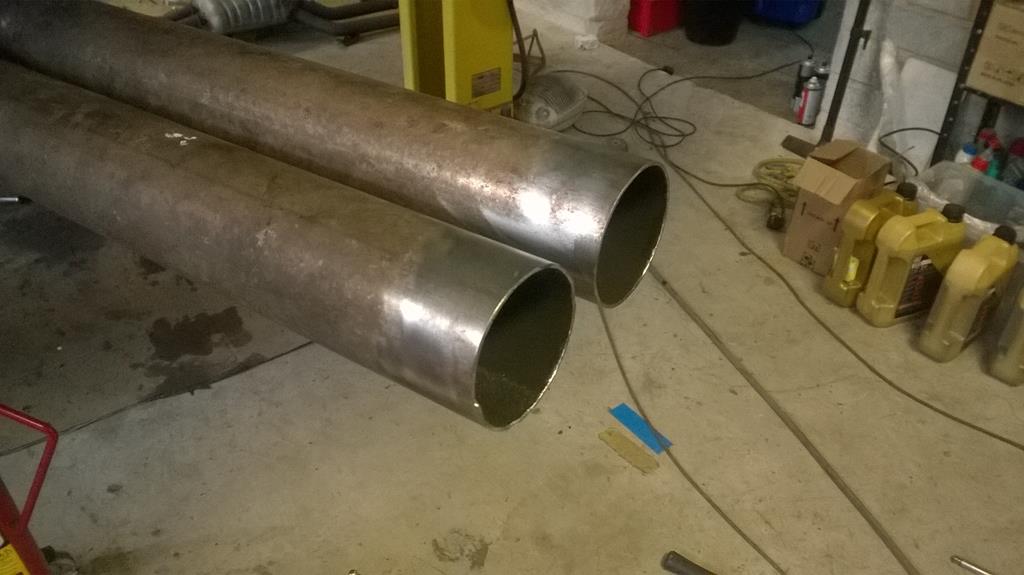

The centre silencer had a large crack where it joined the downpipe
The lovely team at A8parts sent us another one Cleaned the ends up so they would fit the Supersport backbox

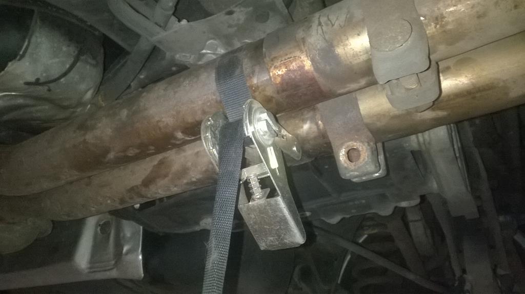

Unconventional fitting (for an Audi) on the backbox. This was not fun to reassemble!
On the transmission jack ready to go back on
Had to squeeze the pipes together by 2mm to get it to go back together!

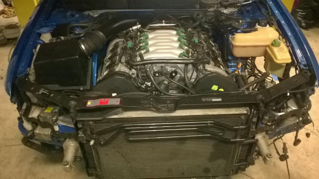

Engine complete and running

Even the LPG Installation is now neater than before
Usually noone else would've strapped those exhaust pipes together but rather pushed and pulled around until coincidence would've been on their side?
