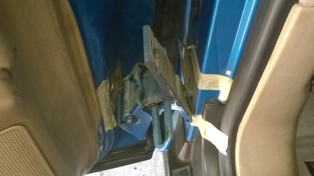

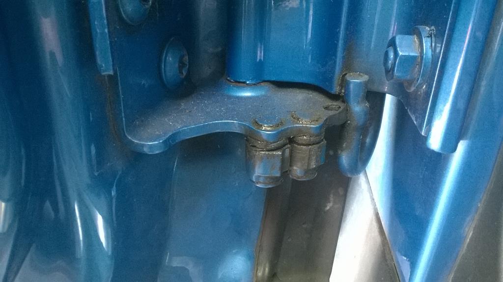

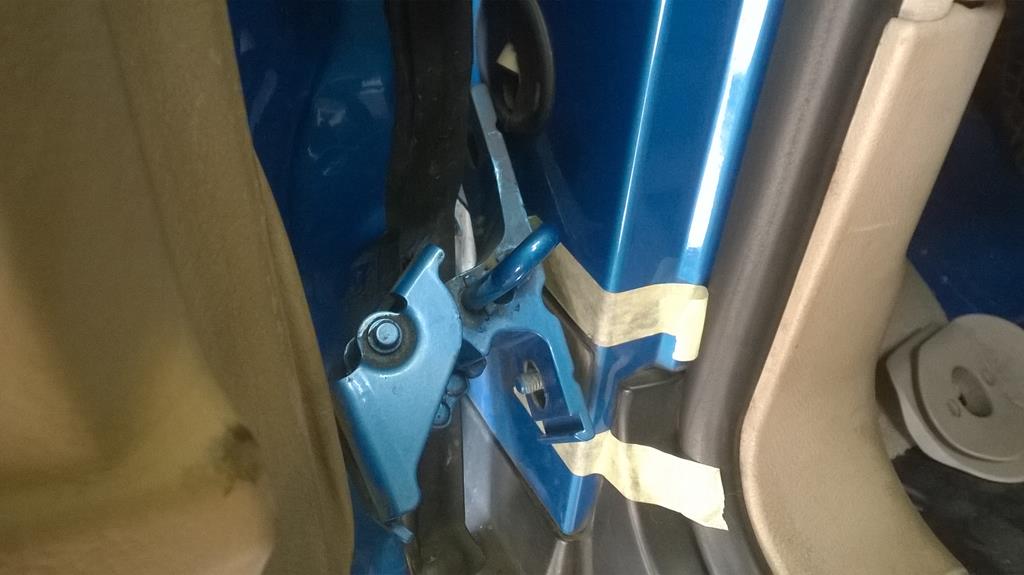

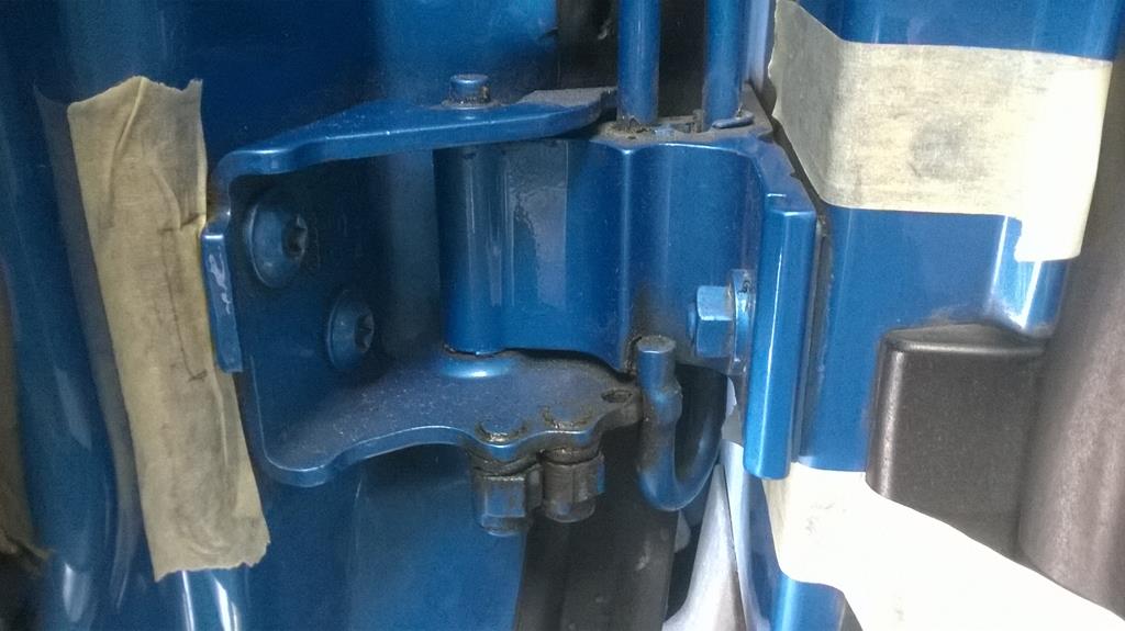

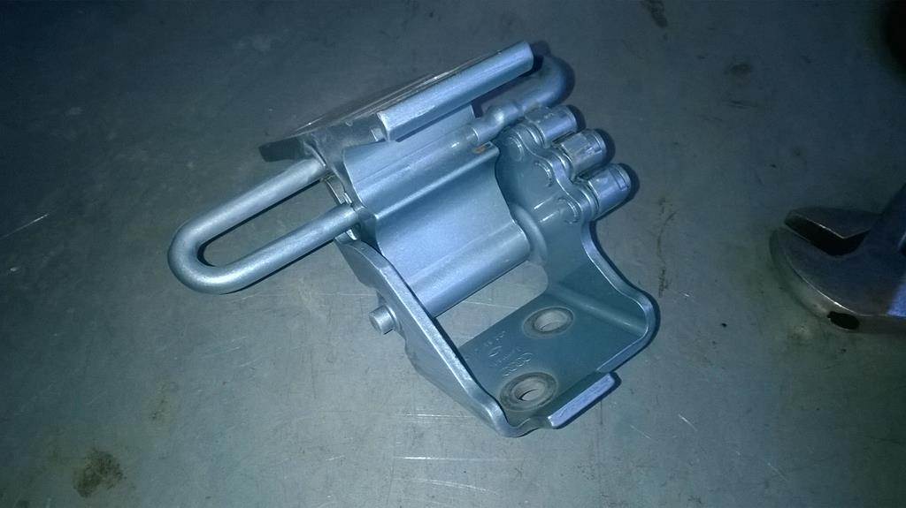

Only a couple of jobs today as I had to wait at home for a courier and do some housework!

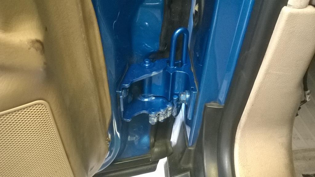

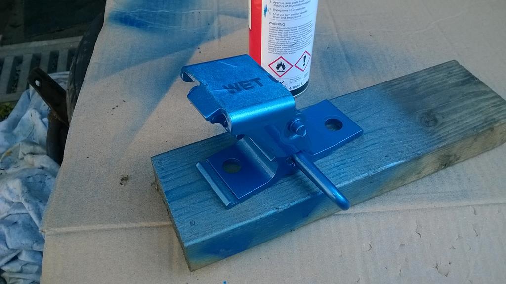

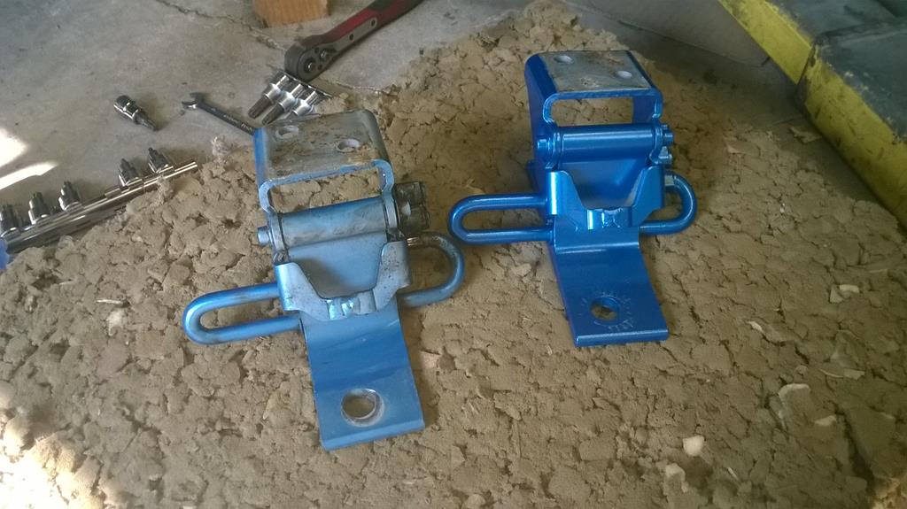

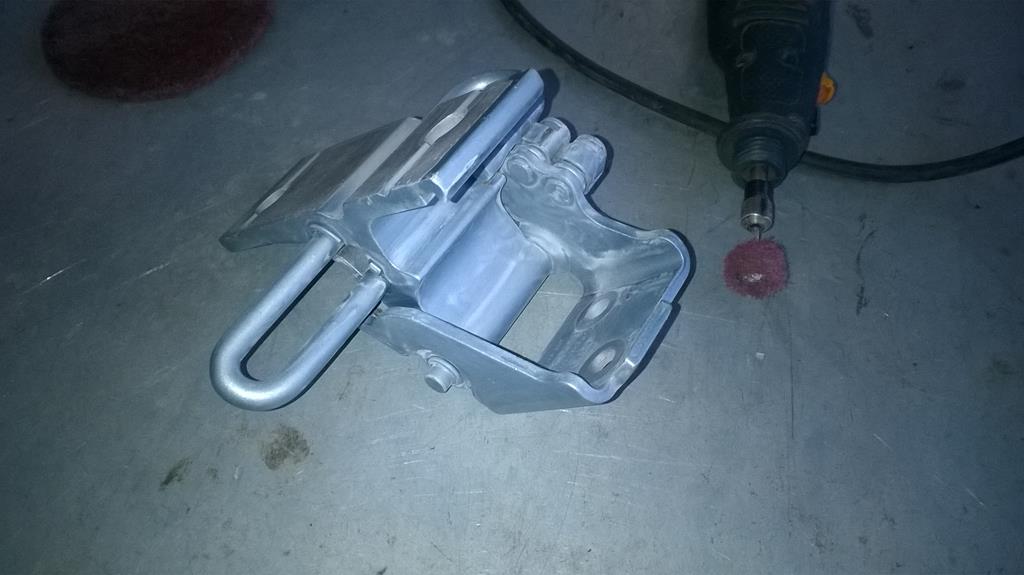

The driver's door lower hinge is missing one of the pins that holds it open. This is particularly vexing when lying upside down in the footwell and the door keeps closing on you so I fixed it.
Kaput:
A8parts supplied a crystal blue replacement
Rubbed down
Now Pelican Blue
Marked up with tape to give an alignment reference
The old hinge rotates upwards to come out
Old and new
Fixed

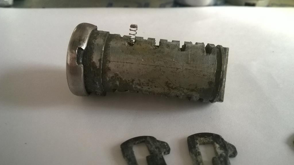

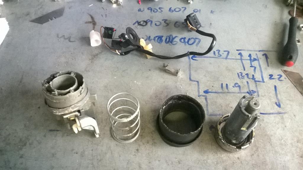

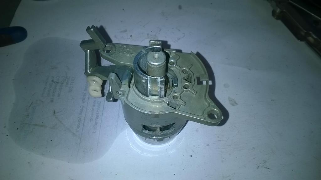

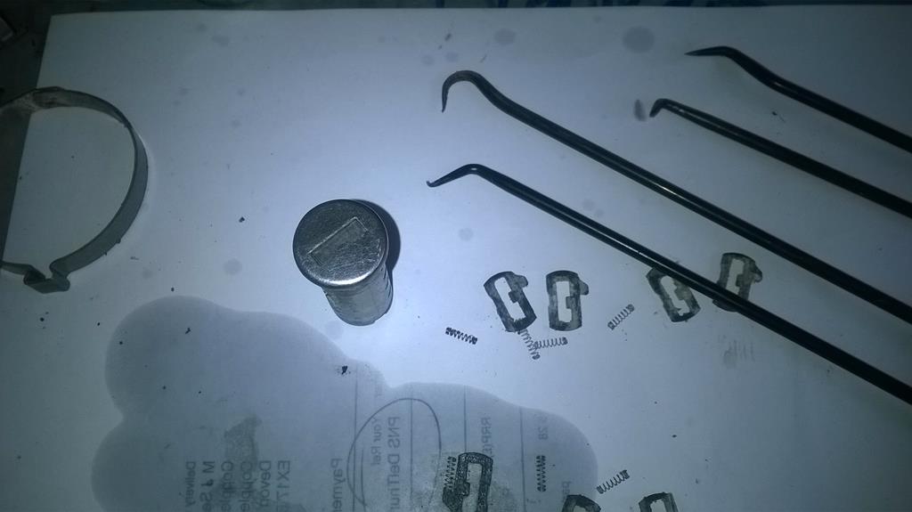

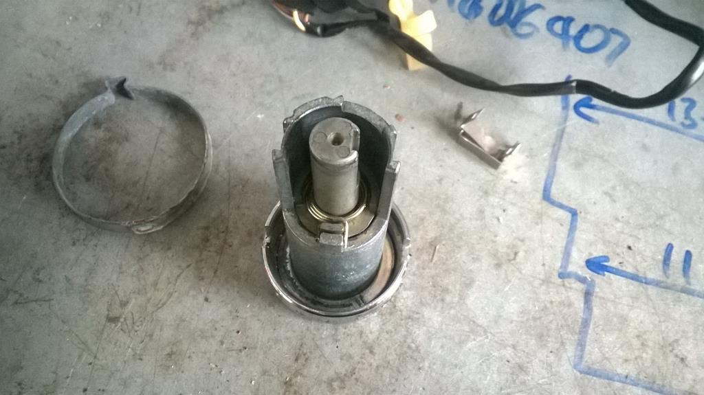

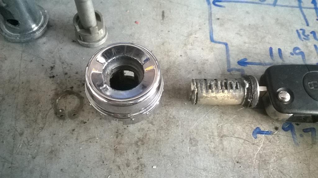

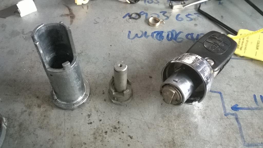

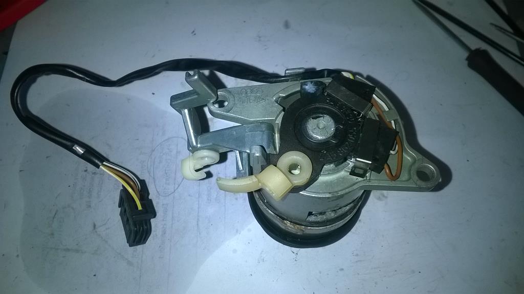

Also fixed the boot lock since it was seized completely solid

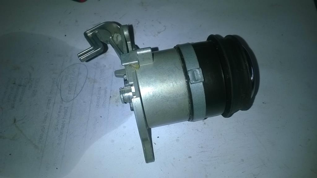

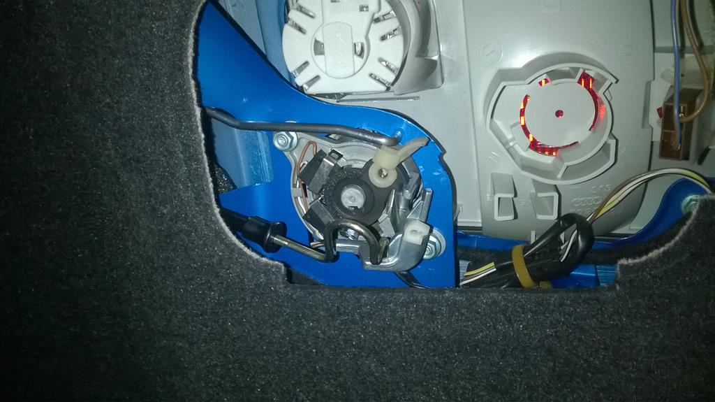

Removed via the door for for the light cluster

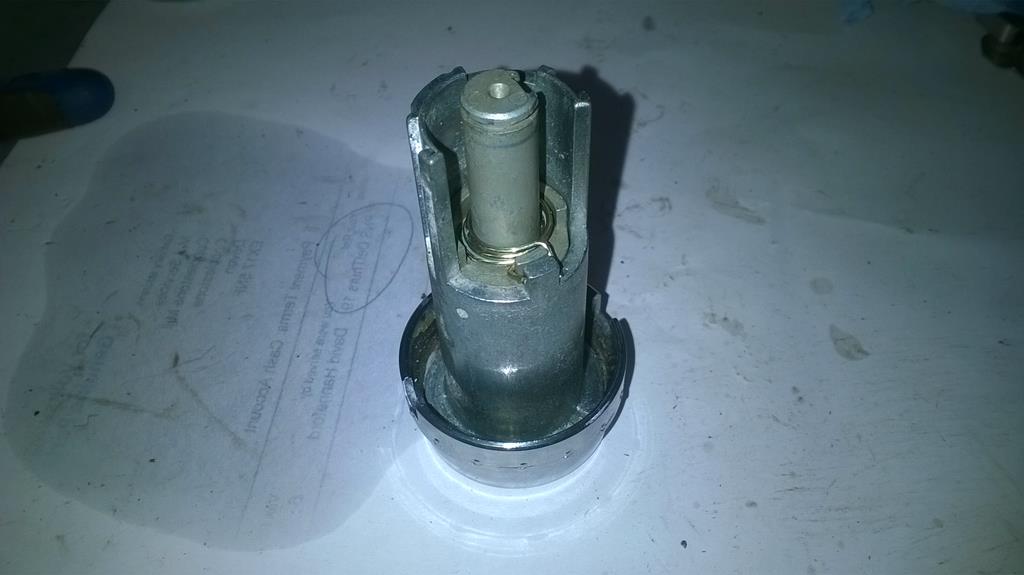

Disassembled the main body

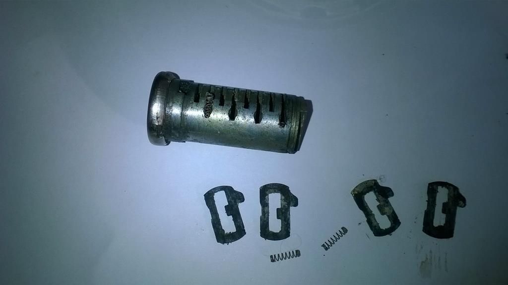

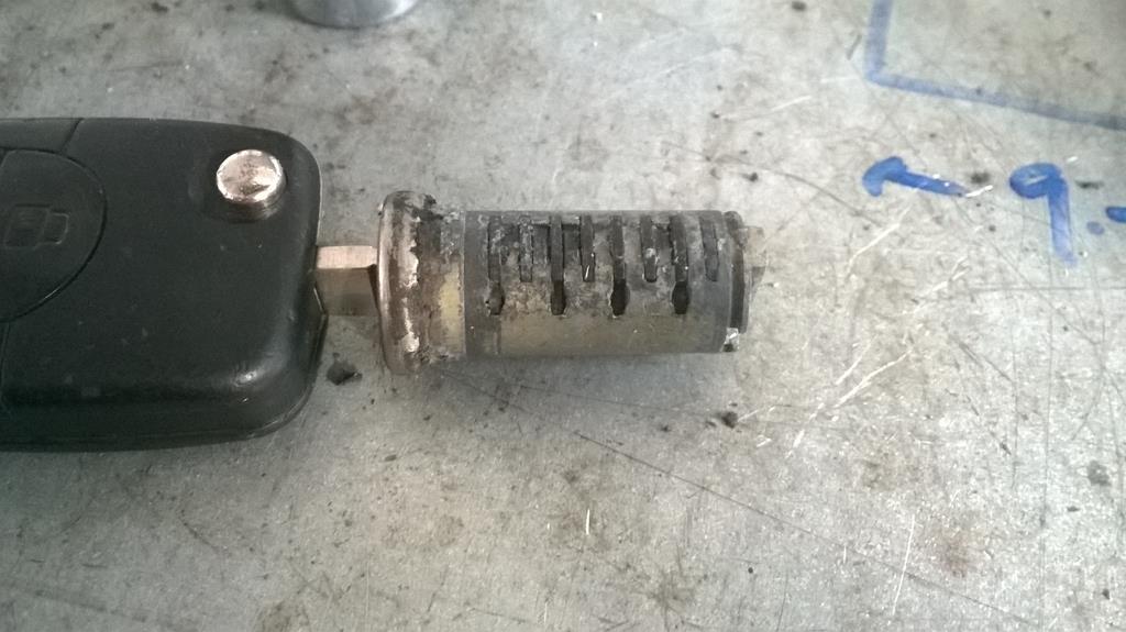

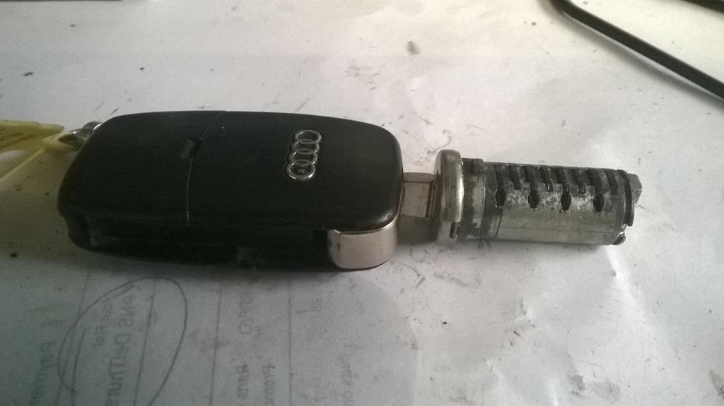

The lock barrel was completely seized in the housing. Lots of WD40 and wiggling and it finally came free.
Crusty!

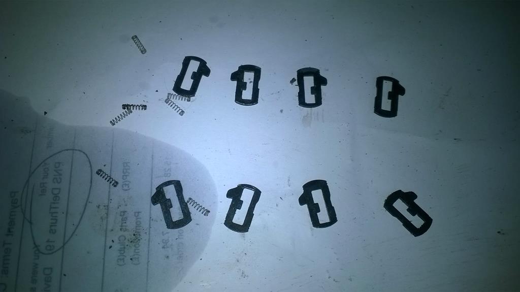

Started removing the tumblers
All disassembled. It took about half an hour cleaning schmutz out of the barrel with an assortment of pokey tools, degreaser and compressed air before the little door would close again!
Cleaned all the tumblers up
Reassembled prior to re-greasing
Going back together

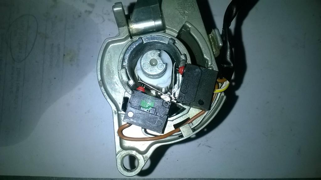

You can see the cam which operates the central locking here via these two microswitches
All back together and ready to put back in
I suspect that I have this problem on my car. But taking the lock apart looks really scary
Johannes
_________
A8 32V engine
Jeep Grand Cherokee -98
  #126
Old 21st April 2018, 09:36 PM
Its pretty straightforward really. The two tricky bits are two circlips and the lock barrel itself. The circlip you can see on the end in the last picture needs really small circlip pliers. The slightly larger one that holds the barrel in isn't so bad.
The lock barrel needs a delicate touch to take apart as the tiny springs have a habit of first getting stuck, and then escaping when you poke them, but if you're careful and methodical its not too bad. If you keep the key in the barrel it will hold all the tumblers in place until you're ready to remove them.
A new lock is £200 or so and has to be ordered from Germany using the VIN if you want to keep the same key so its well worth taking the time to fix the old one

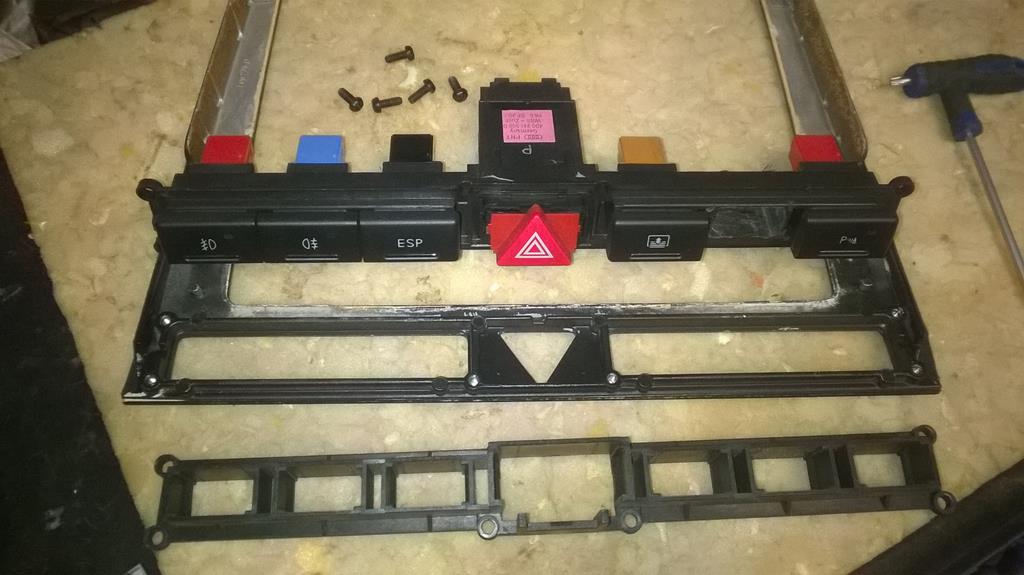

Tinkering tonight, putting things back which have been removed for fixing other things.

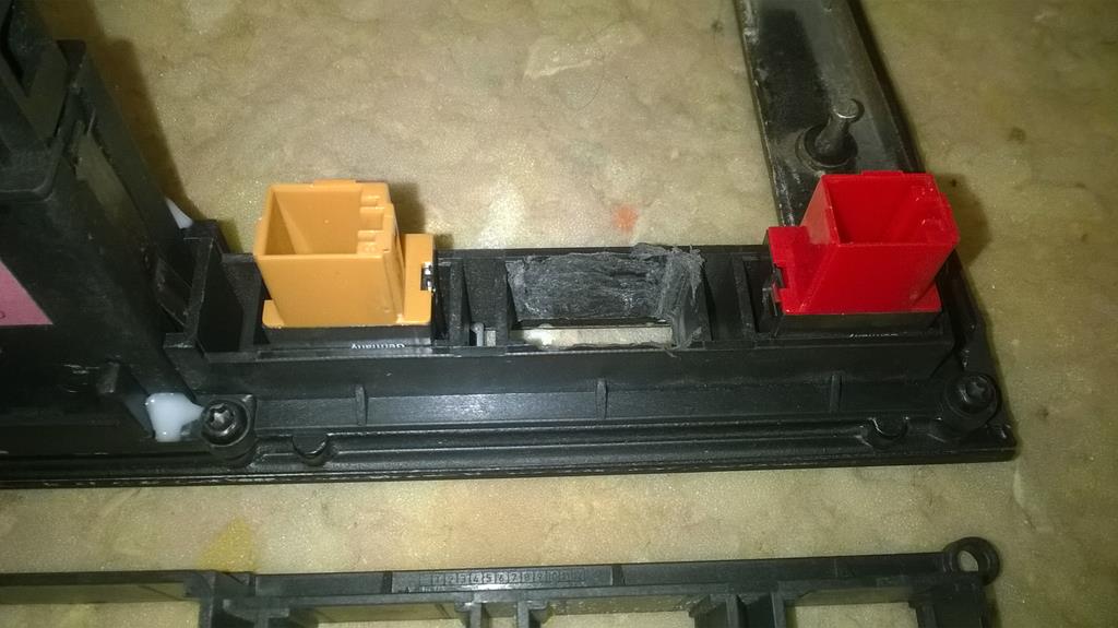

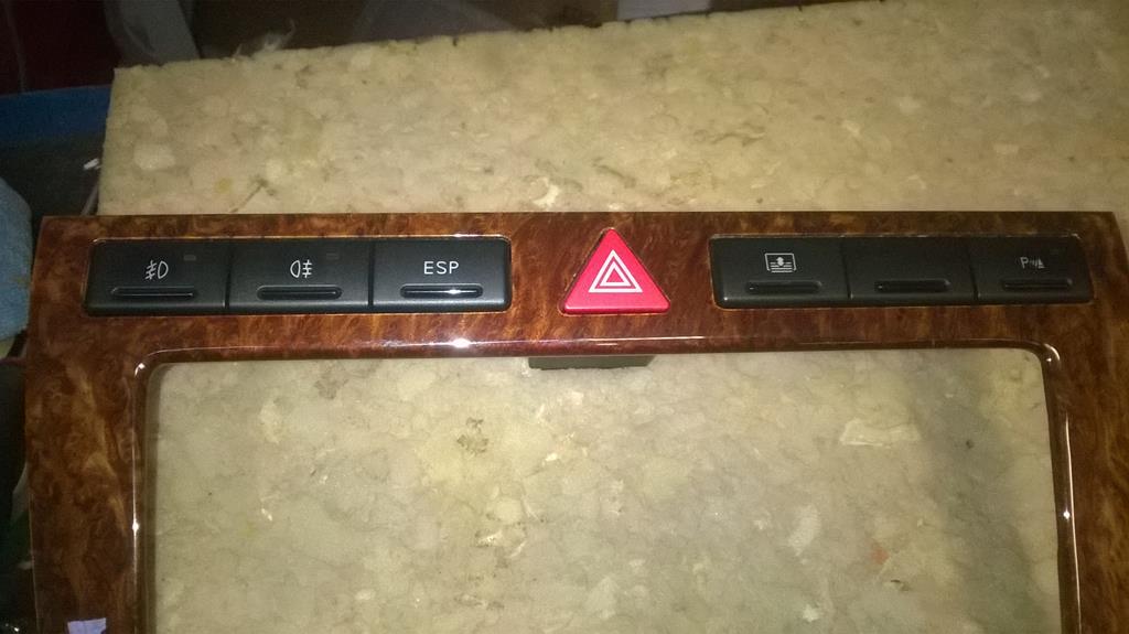

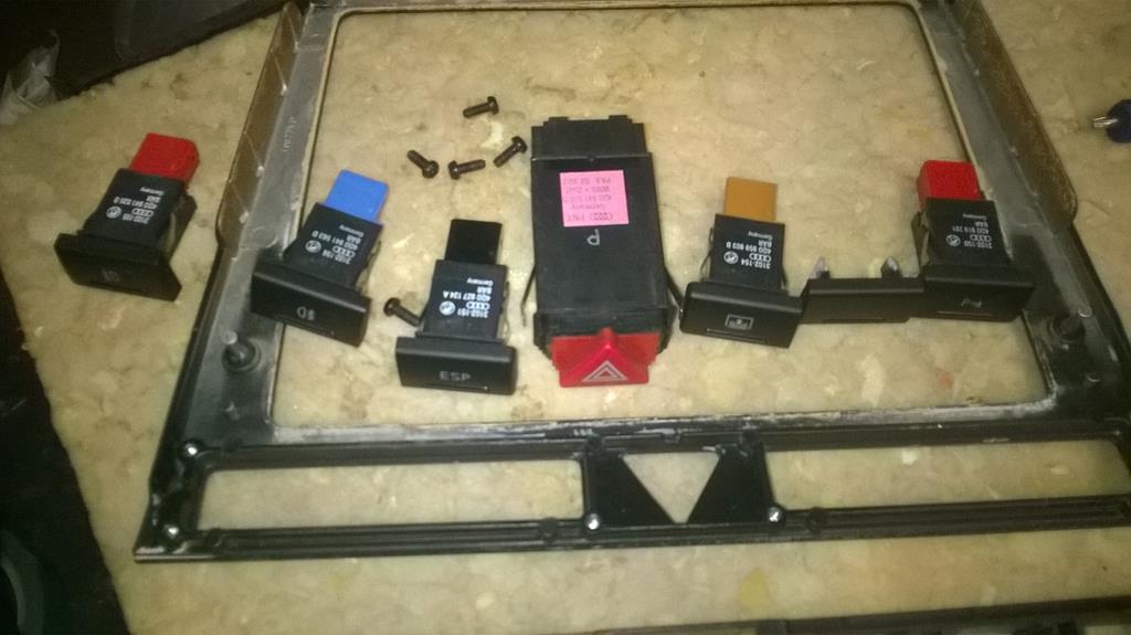

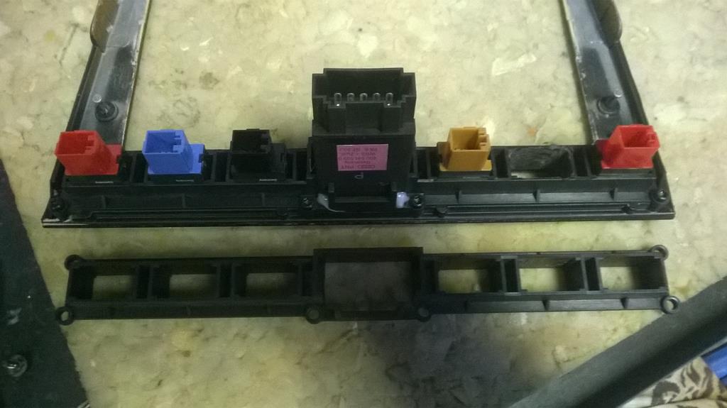

For some reason the perpetrator of the wiring mess ground away the inside of the switch blank hole I can't figure out why, since there was a standard foglight switch in there! With it like this, a stock blank just falls out of the panel.
Meh. We have spares!
Remove the screws and the plastic switch holder comes away from the wooden trim
Pop the switches out to transfer to the new holder. The switches at the sides will come out with the panel assembled, but the hazard switch only comes off with the plastic holder removed.
Reassembled with a blank and ready to go back in

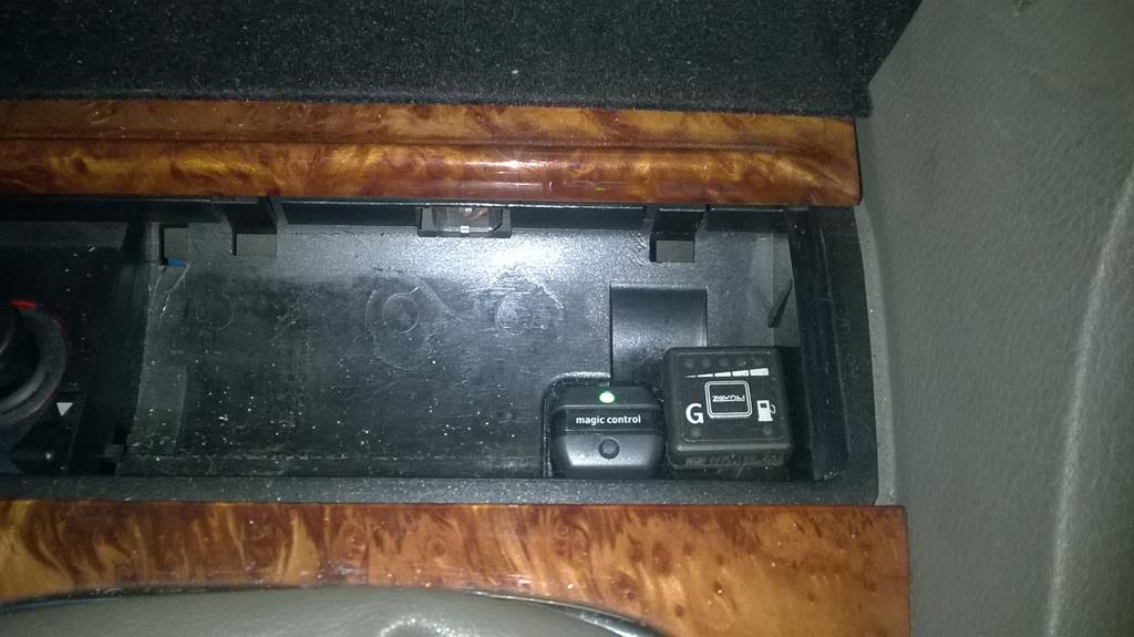

I also got the TPMS working again. Said perpetrator had wired it to the wrong side of the hazard switch so with the switch removed for tinkering the TPMS had no power. I had tidied up the wires and just put them back where they came from, assuming (foolishly!) that the perpetrator had got it right. Alas no The TPMS was drawing power through the electronics in the hazard switch, so while it worked with the switch plugged in, it stopped working as soon as you turned the switch on!
Wired up properly, it fired straight up with the ignition. It powered up with a red light then flashed red/green for a while as it detected all the wheel sensors (presumably since the battery has been off for a while), then showed me a green light to say all was well. I tested it by letting a tyre down, since neither Vera nor I knew what it would do in response to a flat! It flashes orange at ~1.5 bar, and goes solid red at ~1 bar. If all is well it turns the green light off after a few minutes unless it detects a fault.
