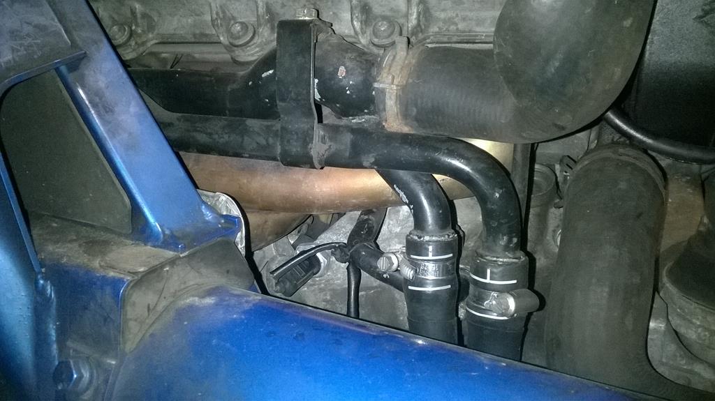

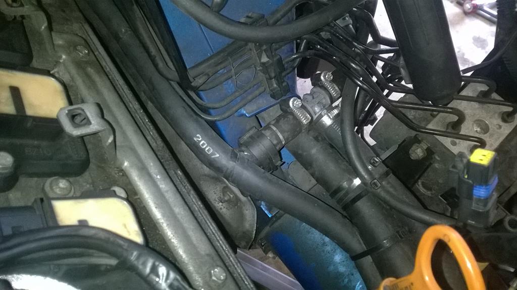

Extra plumbing for the auxiliary heater:

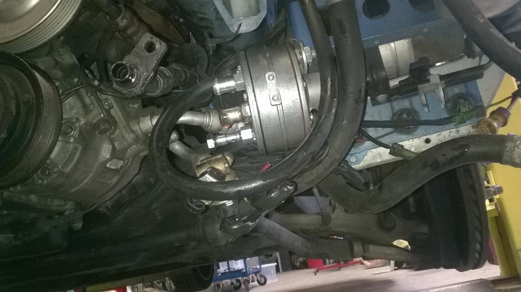

Plumbing - LPG evaporator down by the AC compressor.
Plumbing - tee for the coolant feed to the evaporator (which uses the heat from the engine to evaporate the liquid LPG in to gas)
Plumbing - an interesting valve doodad for the aux heater on the right hand side
Extra wiring for the LPG system
Lots more wiring for the LPG system
Wiring disconnected and ready to remove

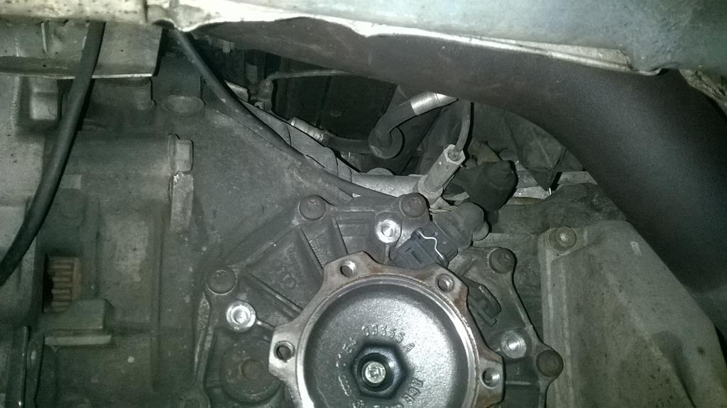

Here's a bonus complication of the manual - the clutch slave cylinder hiding on top of the gearbox. Slightly challenging to remove, extremely challenging to refit!

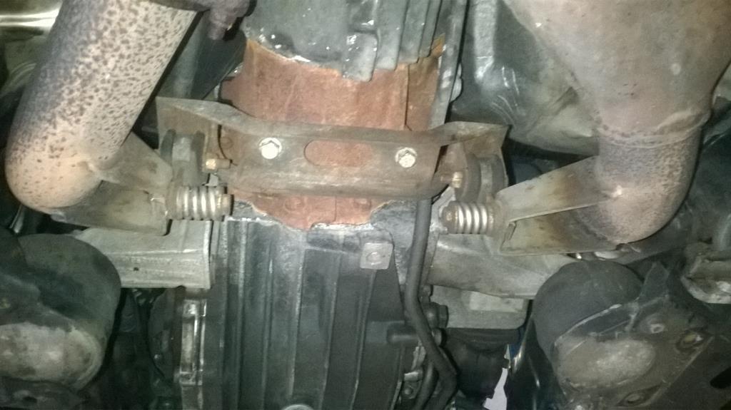

The manual exhaust support bracket is quite tidy with both of them attached together under the gearbox.

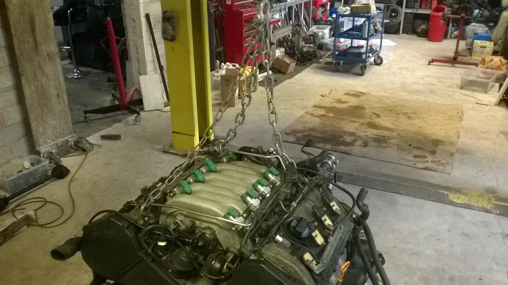

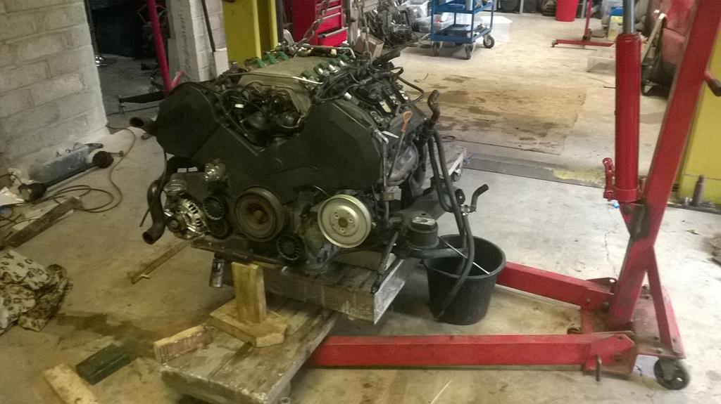

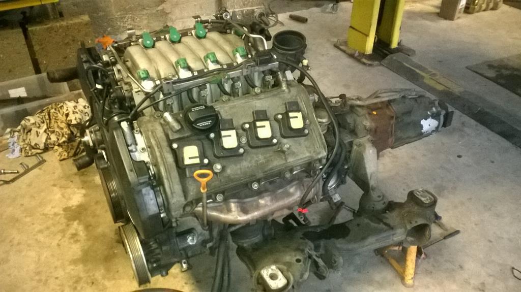

Engine out:

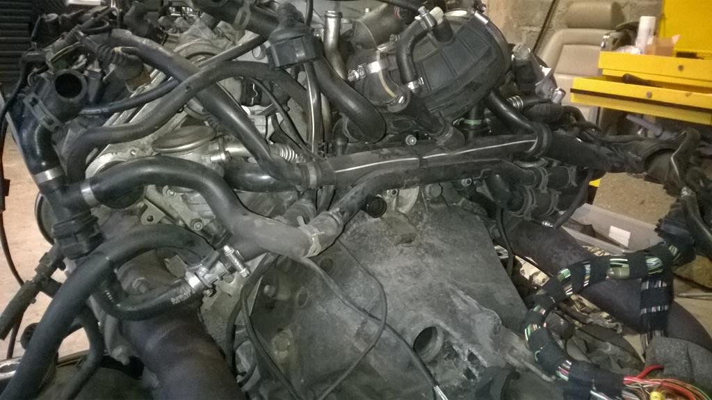

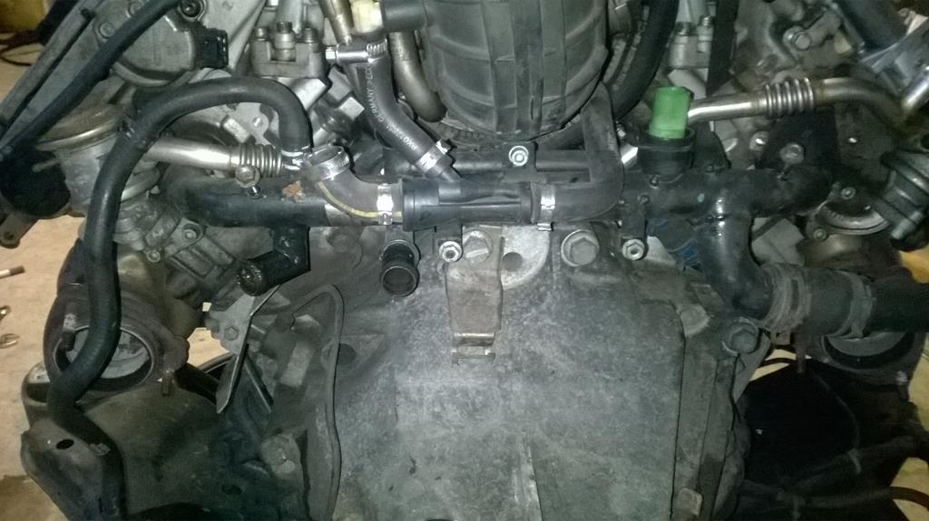

The weight balance of the manual drivetrain is considerably different to the auto. The manual gearbox is 100Kg lighter so the centre of gravity is around cylinders 3 & 6 rather than at the bellhousing, so it needs a chain on the front of the engine to lift it flat.

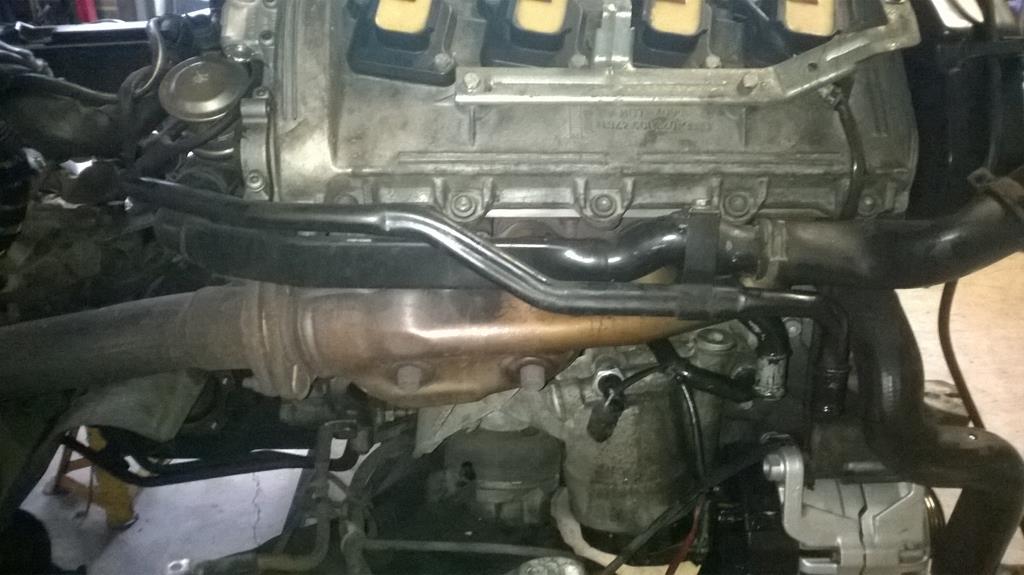

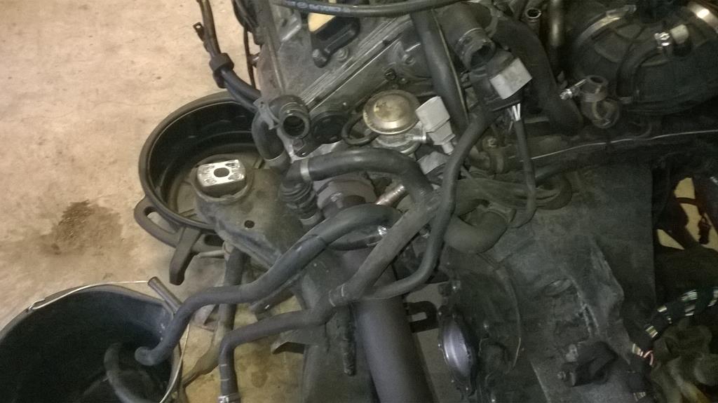

Extra coolant pipe for the aux heater
Lots of plumbing here, for the aux heater and lpg
Engine harness and coolant hoses removed

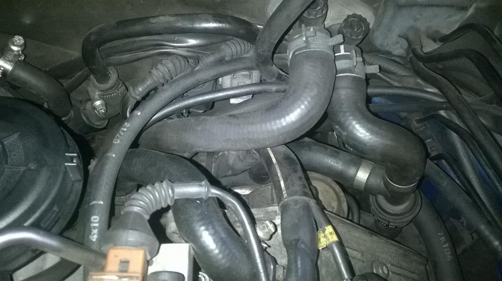

Right in the middle of this pic is a lovely bracket to hold the clutch hose. Almost impossible to reach with the engine in

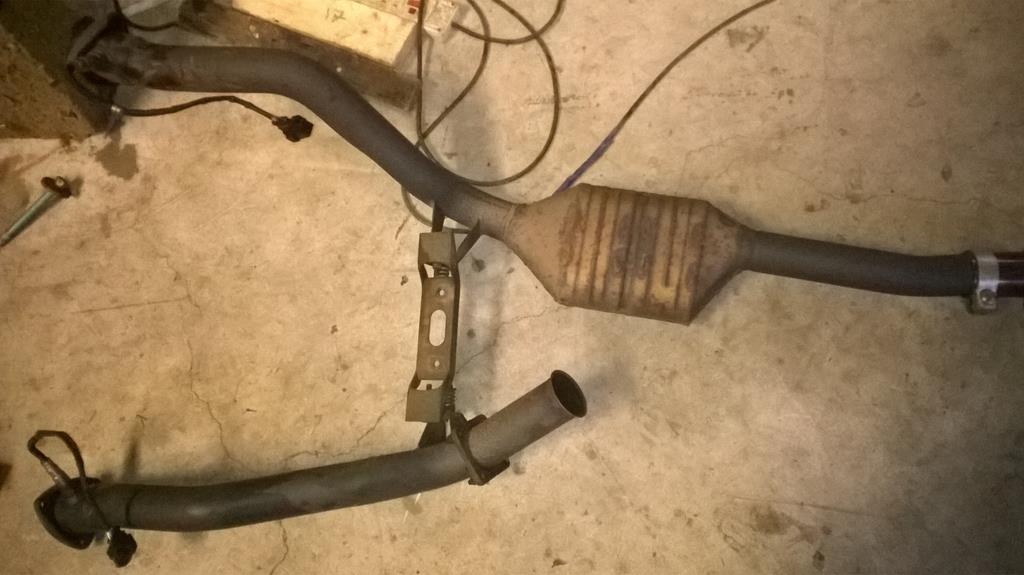

Both downpipes come off together which is really cool because it means they will both go back in exactly the orientation they came off. That makes reassembly much faster since I can bolt them up fully with the engine on the ground. With the auto you can't do this as its impossible to get them back in the same place so it has to go in with the bolts loose to allow final repositioning once it's back in the hole. Of course any time saved here will be consumed by trying to fit the clutch slave cylinder back in to the gearbox

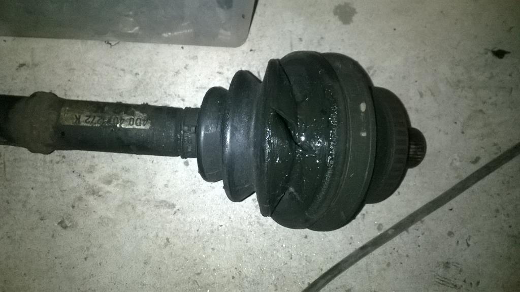

Split CV boot, as is traditional. Black grease everywhere.

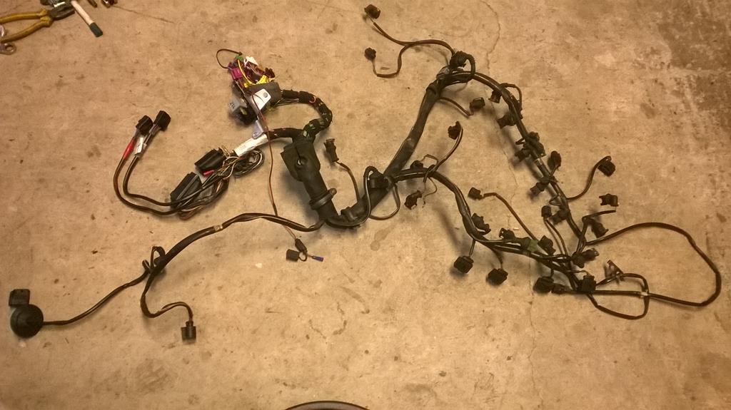

The manual wiring harness is much simpler than the auto harness

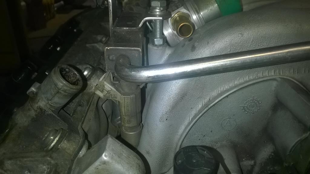

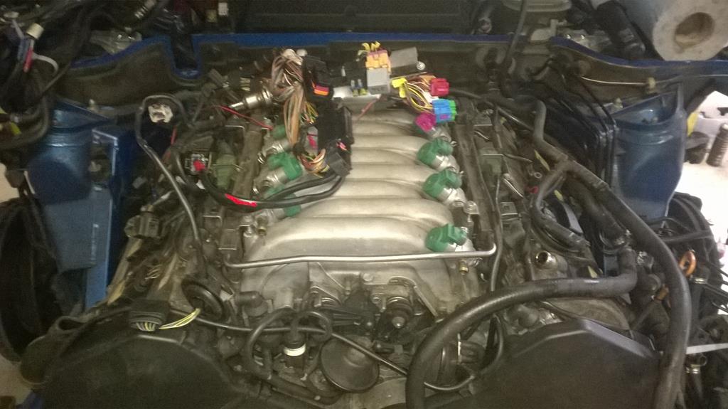

Not a great deal to report today. Mostly removing ancillaries from the engine, and removing the centre exhaust silencer which turned out to have a hole in it. Luckily the excellent folk at A8parts had a full system in stock and were able to cut it to the exact length needed to fit with Vera's Supersport back box so dodged a bullet there!

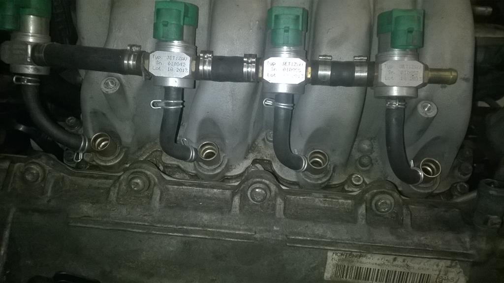

I also removed the LPG injectors from the old engine. You can see the LPG adapters just underneath the original petrol injectors:
Pretty neat little things actually, which save you from having to drill the inlet manifold. I don't like the way the fuel rail is suspended on nuts and bolts though so I will tidy that up

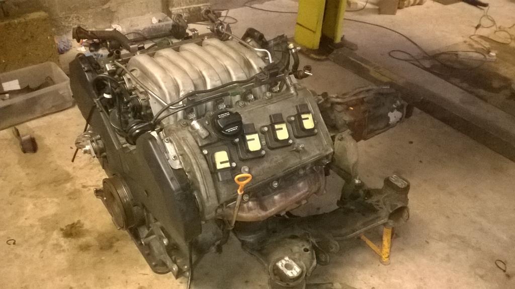

The old engine all nekkid

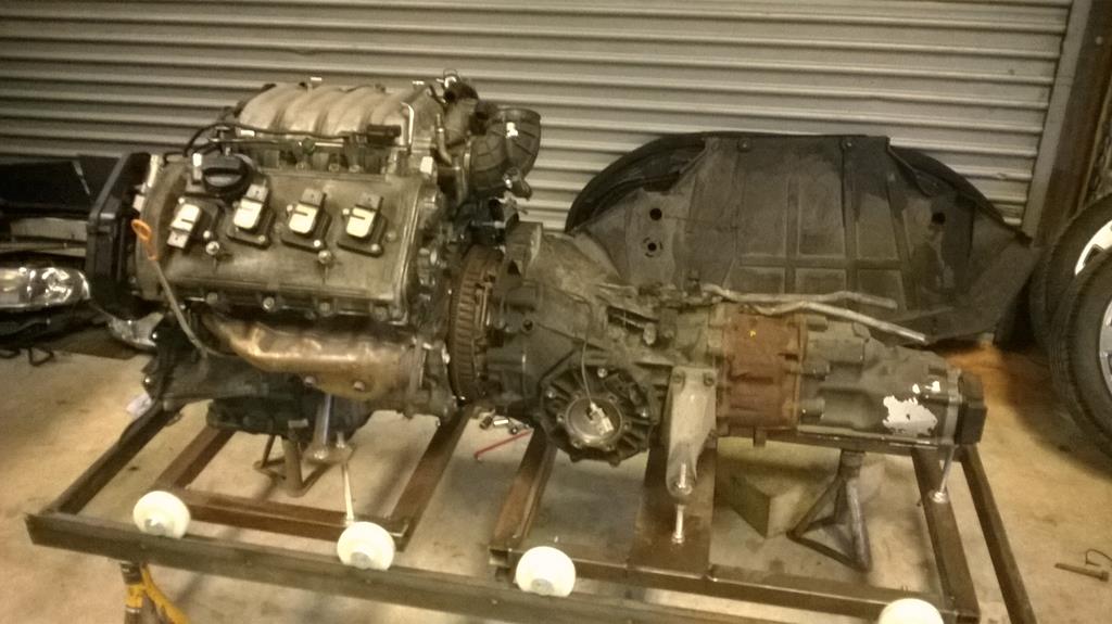

I had to adjust my engine and gearbox separatey thing to fit the manual gearbox
Once the engine and 'box were split I cleaned up the gearbox and removed all the clutch fork stuff as that's all being replaced with new along with the clutch and flywheel.
Lots of o-rings and things coming tomorrow so I can reattach all the original water pipes etc to the new engine and start putting it back together
