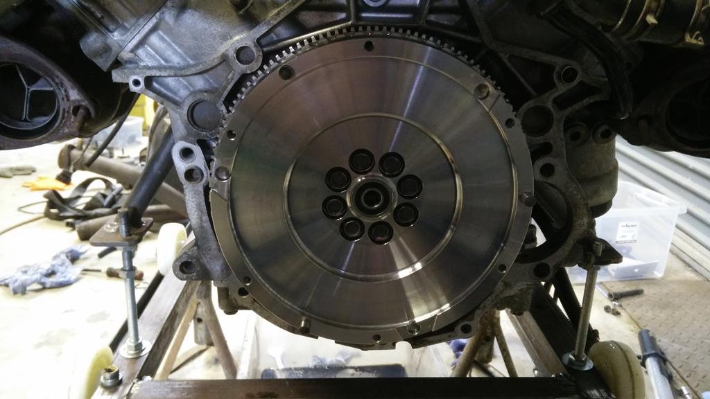

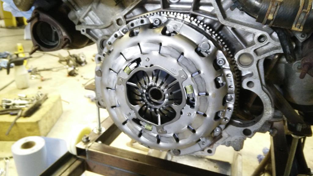

Flywheel on - this is a custom lightweight unit from TTV Racing. Its a little over half the weight of the stock one, and a little over half the price! It also takes a nice cheap B5 RS4 clutch.

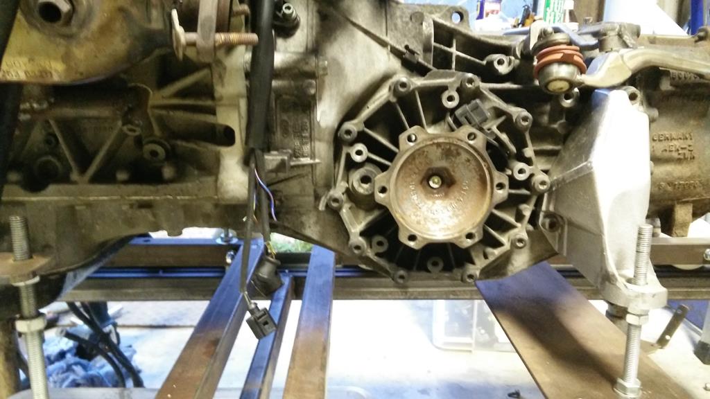

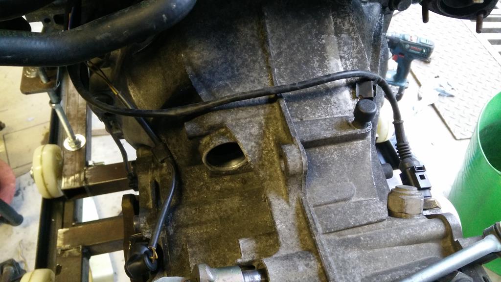

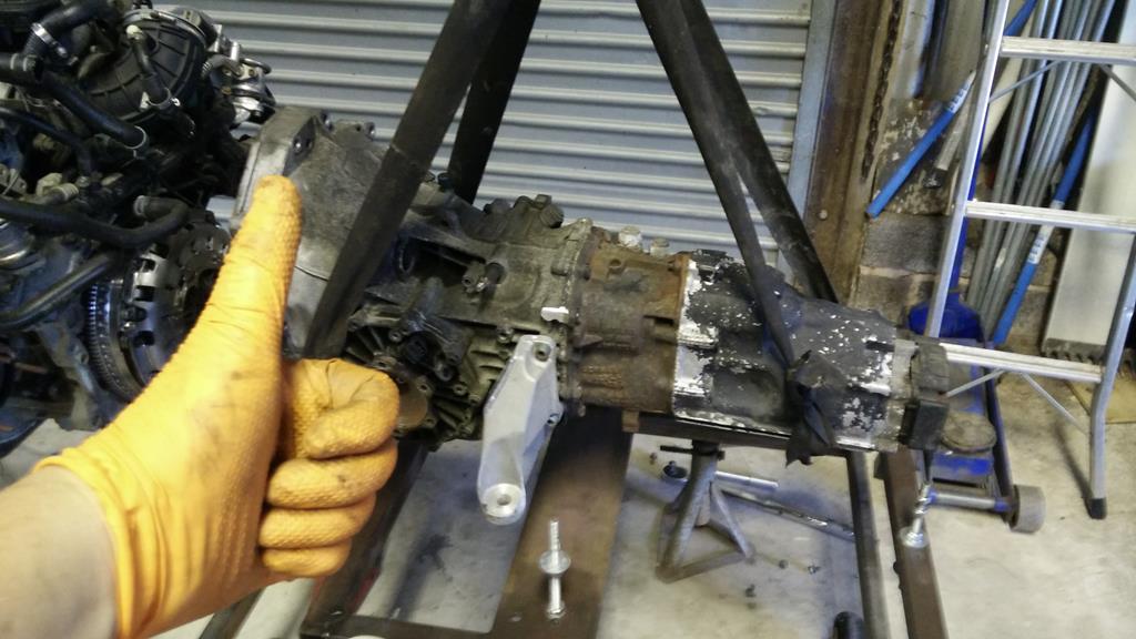

Gearbox going on.

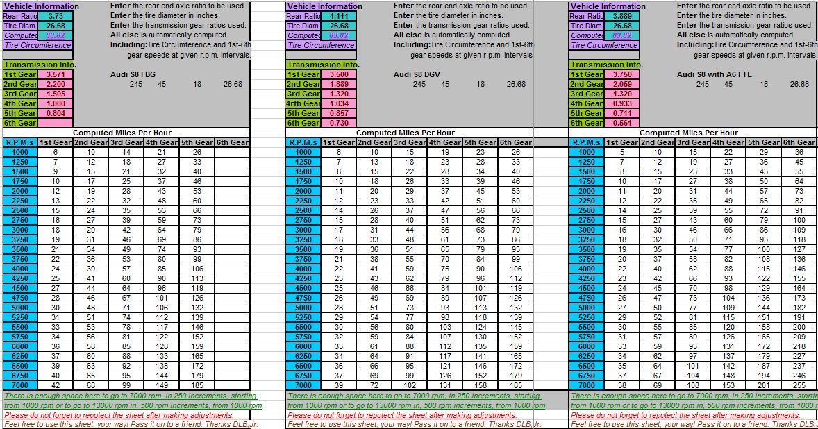

This is from a C5 A6 2.5TDI quattro. The ratios look 'plausible' and they're relatively easy to come by.
Always the little details

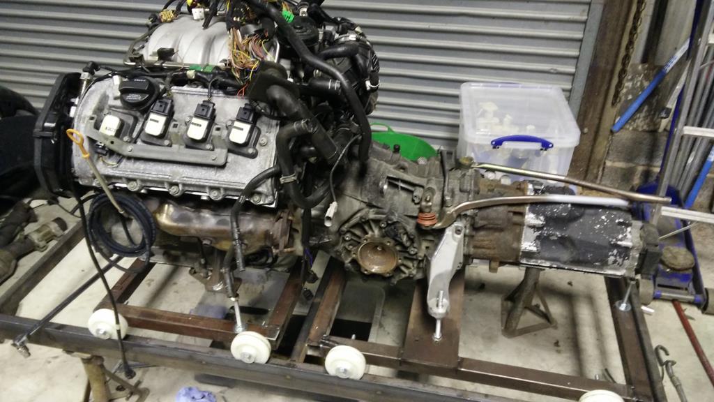

Engine and gearbox bolted together

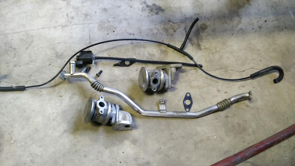

The manual ECU files which I've obtained from Vera and Goran (thanks both!) have the secondary air injection coded out, which is handy because its pointless and just adds weight and plumbing.
Pulled all this rubbish from the engine, and I'll remove the pump from the airbox before it goes back in.
Made up some blanking plates for the ports on the back of the heads

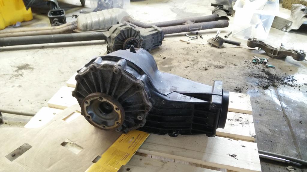

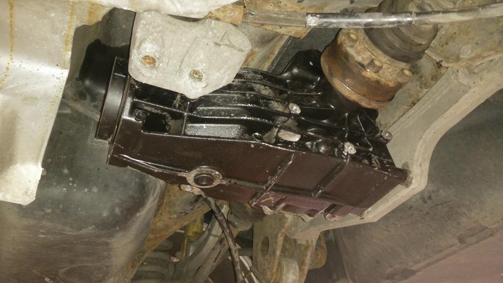

TDI rear diff:
Original diff in the background

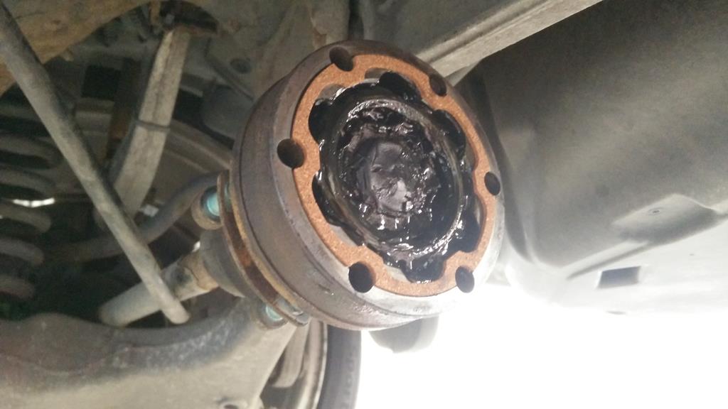

Cleaned up the CV joints and replaced the gaskets
Installed

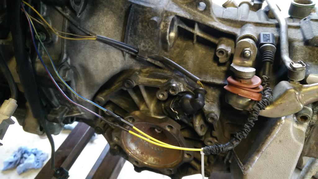

Sorted the wiring for the reverse switch. New connector and wires to extend the original N75 wires over to the other side of the gearbox
Re-used some sleeving from the autobox harness
Wrapped up with tape and complete. Ideally I would have liked to sleeve all of this, but that would have meant cutting off the original connectors for the engine mount and speed sender so tape has to do in this case. I may use some split corrugated sleeve on the next swaps.

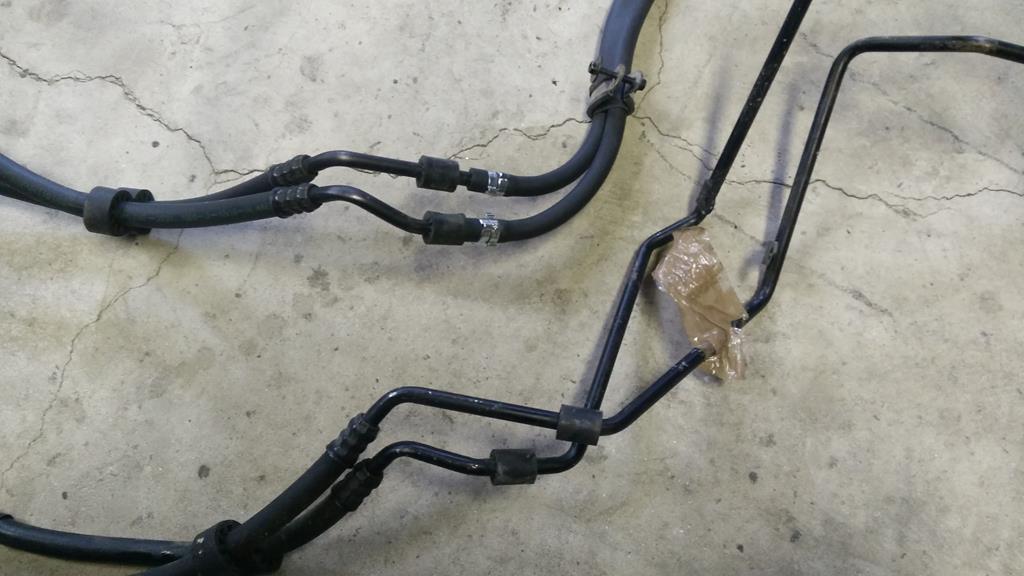

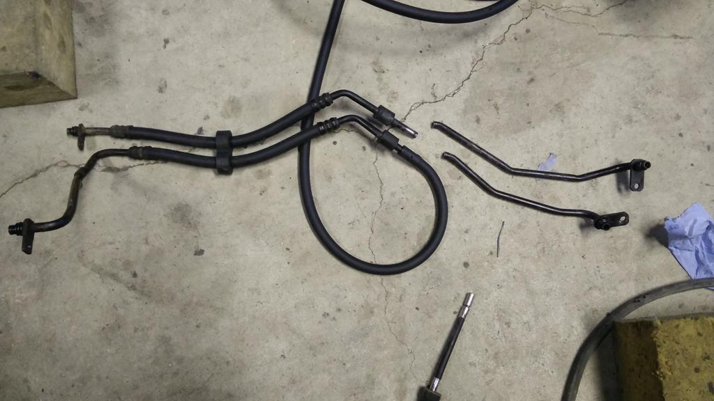

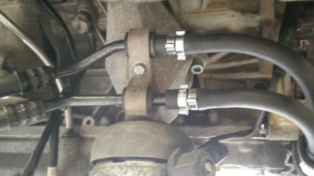

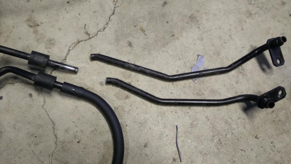

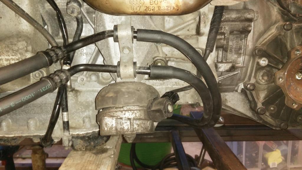

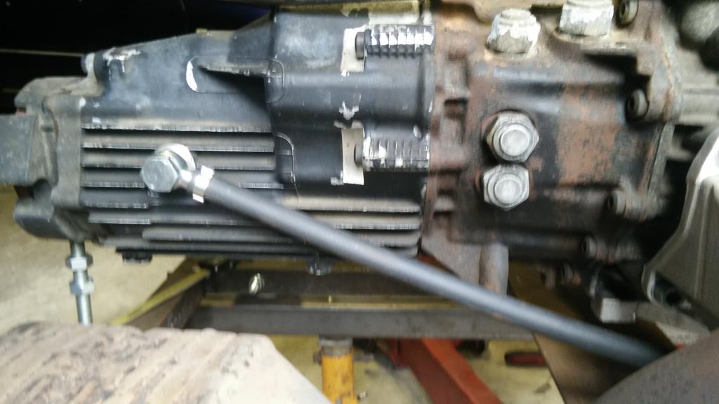

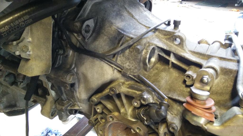

On to the gearbox oil cooler lines. The originals (of which I have a reference set) are no longer available so I cut the autobox cooler lines apart after the engine mount

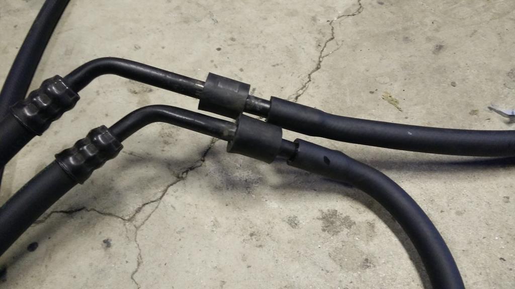

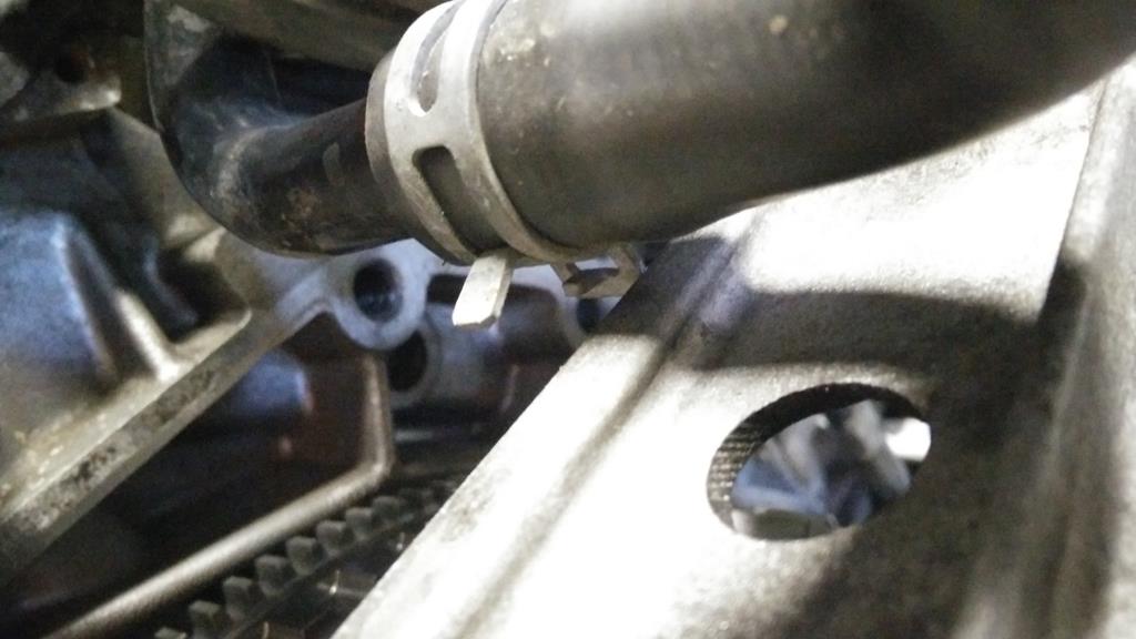

I couldn't get the phone to focus to get a decent pic, but I welded a couple of little pips on the end of each pipe to function as a barb to stop the hoses pushing off. There's no pressure in these, but best to be safe. You can just see the bumps in the hoses. I'll crimp these in place once I'm happy with lengths and routing.

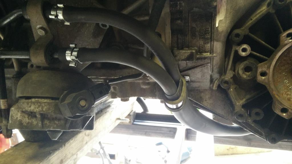

Mounted on the engine. They cross under the bellhousing...
...and attach to the gearbox here
I'll need to work out some brackets to support the hoses since the originals are hard lines after the engine mount. I'll be able to produce these in advance for the next conversions using spare autobox lines.

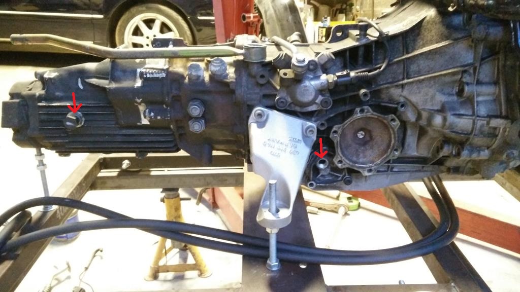

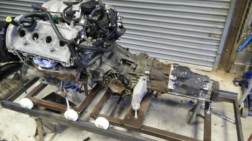

Sadly that is unlikely since I've only got tomorrow left on it, then Mike's Murple is in on Monday for a fortnight. I can't believe its Friday already I've only spent maybe 2 days of 5 doing actual conversion stuff. The rest has been engine maintenance or cleaning conversion parts, and obviously wasting a few hours taking the engine out the wrong way!

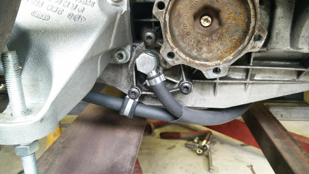

I finished off the oil cooler lines tonight. This is where they join the original hard lines, now crimped in place.
They curve under the bellhousing in roughly the same way as the original hardlines
Pump output
Return at the back (apologies for the focus ). I need to make another support halfway along this when I build the exhaust support bracket. On the next ones I might actually use the C5 return hardline at this point and join the hose where the pump union is.

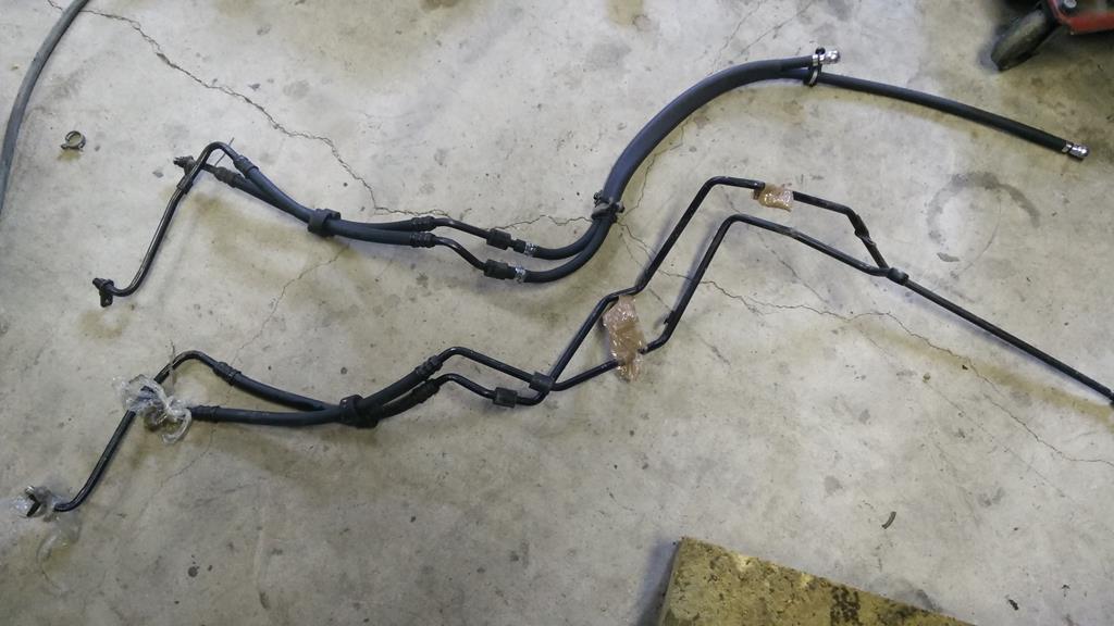

I covered the hoses in adhesive-lined heatshrink to hold them in place and to give them some protection. This should hold its shape even when the lines are hot. If not, I'll consider some more support.

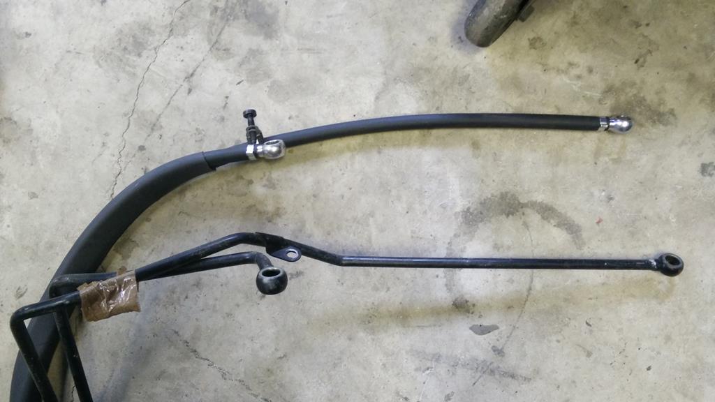

New lines top, originals bottom
All I managed after this was to put the other engine mount and starter back on and then fill the gearbox with oil. Lots to do tomorrow to get it rolling again so I can push it out of the way to work on Mike's.
