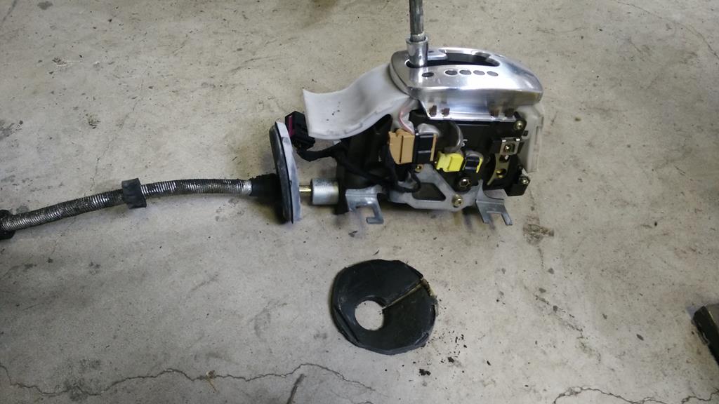

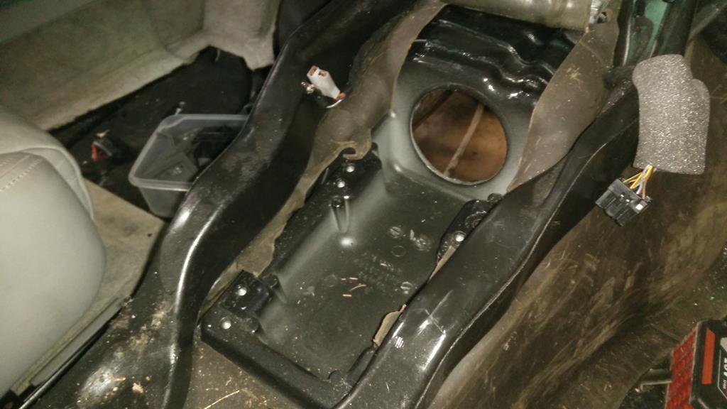

Don't need this any more

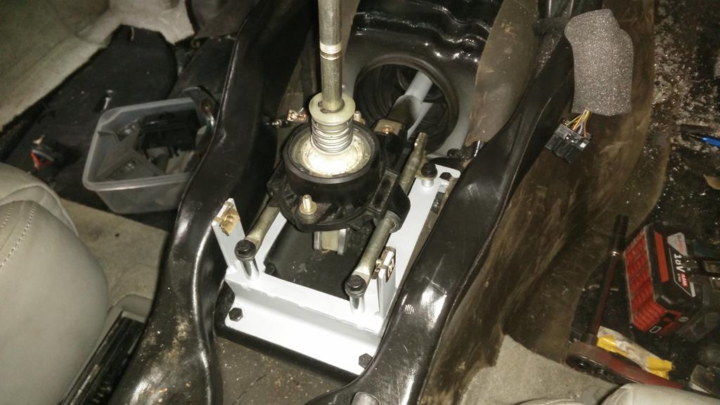

Space for the new shifter

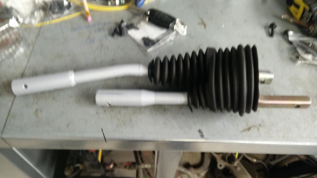

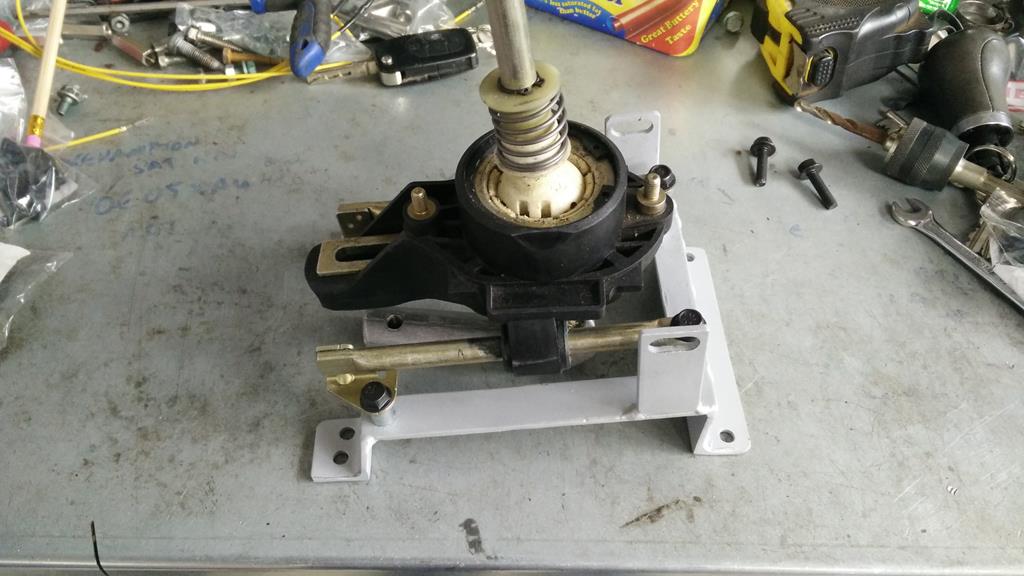

A6 shift lever on a custom bracket. This bracket is 'knife & forked' from flat plate and angle section. The production run will be CNC'd and folded.
The other half of the shift levers. Autofocus on the Oneplus One sucks btw.

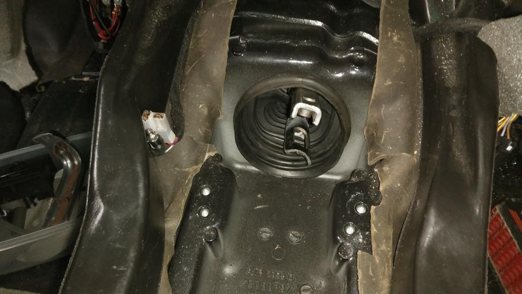

Fitted in the tunnel with the protective boot (this is an adapted A6 boot btw since the D2 one of course is NLA)
Shifter in place

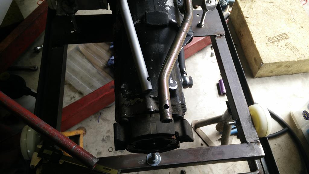

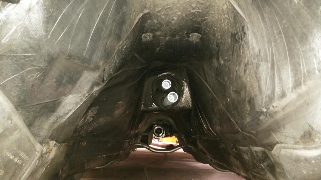

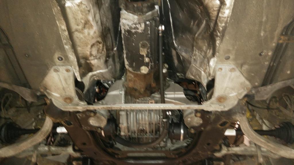

Shift rods from the tunnel
They attach to these
I split the shifter rods using some custom turned adapters so that they can be split at the back of the gearbox from under the car. This means you don't have to pull the centre console out to remove the engine. I'll show how this goes together when the engine & box go back in.

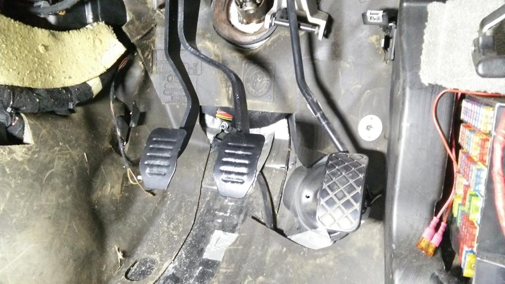

On to the pedals.

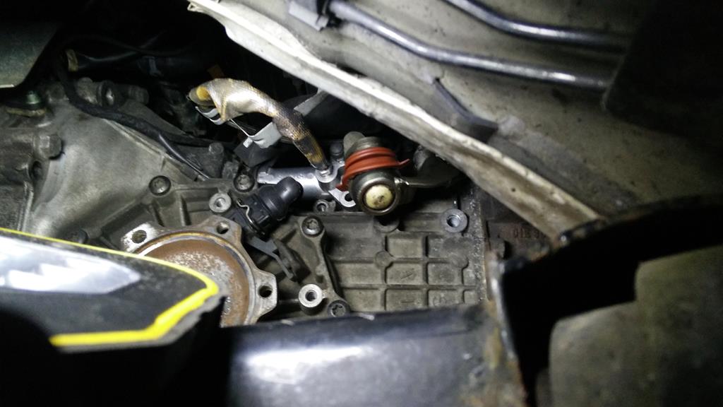

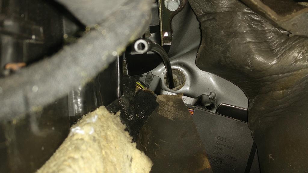

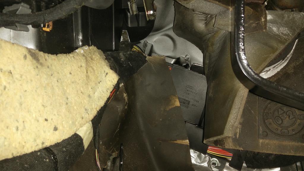

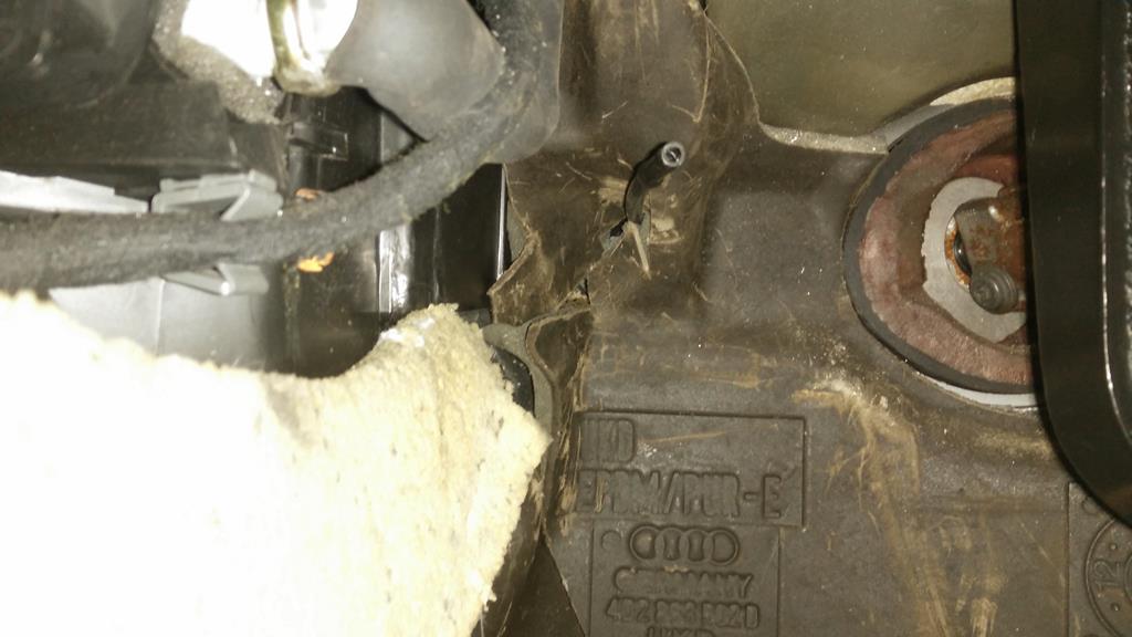

Conveniently, whoever designed the firewall on the D2 didn't get the message there wasn't going to be a manual RHD version, so they put a place for the clutch hose to go through the sheet metal This is pretty much a mirror image of where it is on the LHD models.
Hole drilled and a pull-through, er, pulled through
This is where the hose will come through the sound deadening.
and this is where it all went a bit Pete Tong. I bled the clutch master cylinder on the bench before fitting it to the car, and while I was doing so discovered that the seals had failed I think operating it dry while I've been designing the pedal has trashed the internals and so it can't create enough pressure to operate the clutch fork. I can't get a new one until Tuesday.

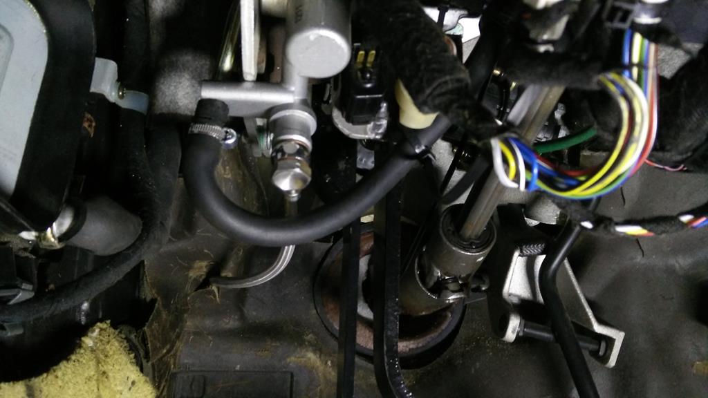

Hose routing.

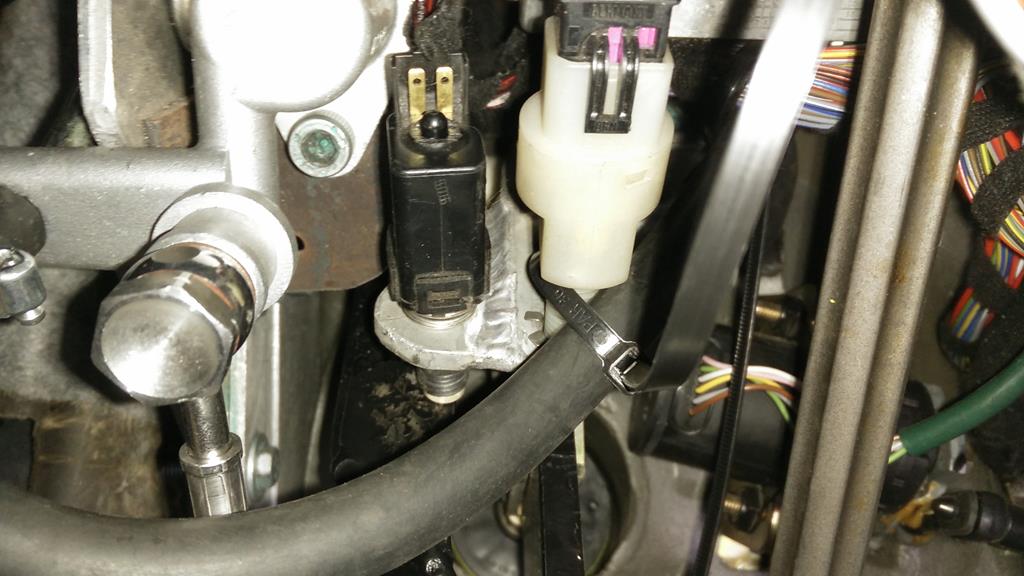

Clutch switch for the cruise control

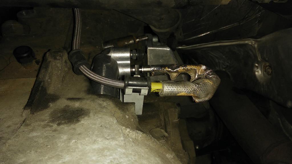

Slave cylinder. I re-used some heat-shielding from the wiring harness as the hose runs a bit close to the downpipe.

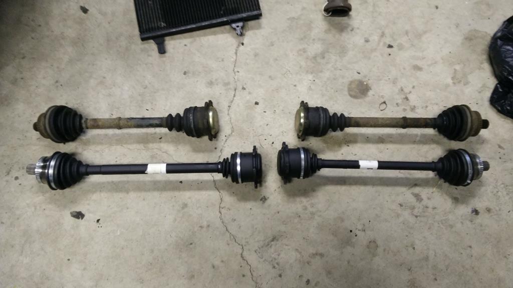

Driveshaft - new v old

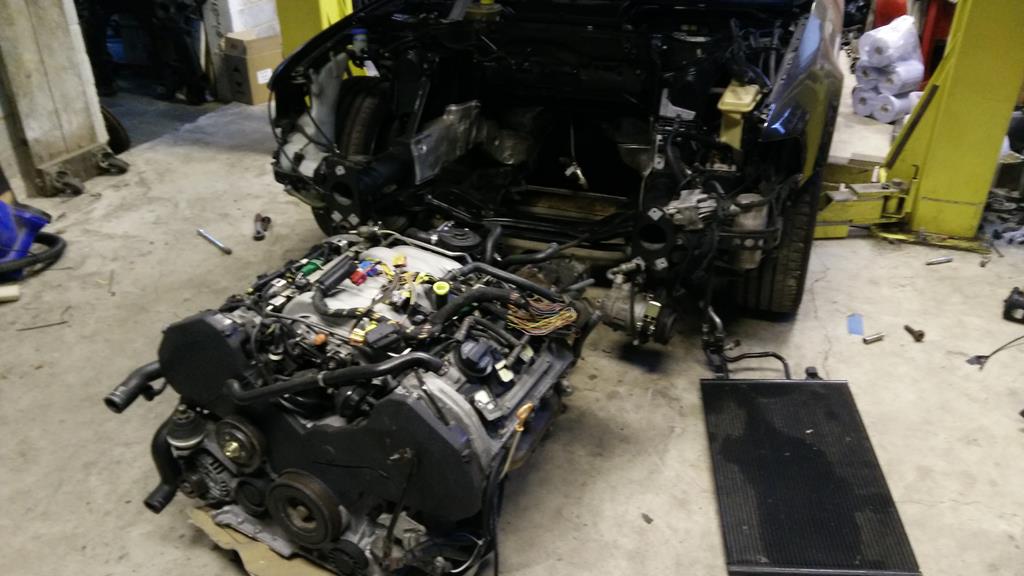

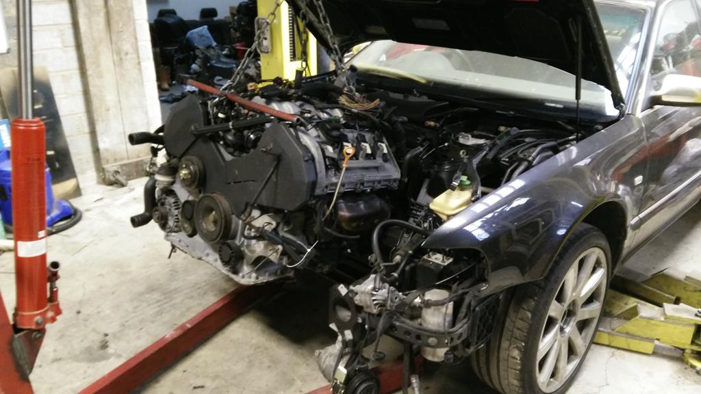

Engine and box going back in
Loads more room in here now
The clutch slave is a total **** to get to with the engine in! Much more so than in the A4 or A6, simply because the superstructure of the D2 is so much more bulky.

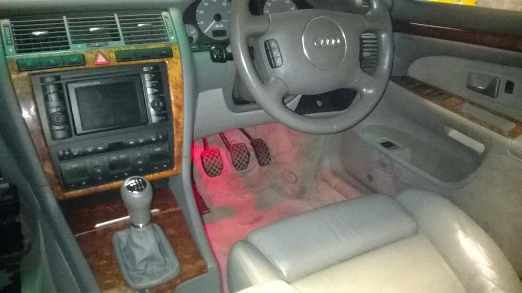

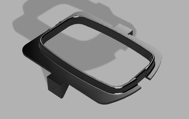

After a successful test drive I started putting the interior back together. I've lost a bunch of pics, but I printed an adapter piece to fit an A6 gearstick gaiter in to the D2 console trim which looks like this:
Installed it looks like this:
I also removed the tiptronic steering wheel and replaced it with a manual version.
