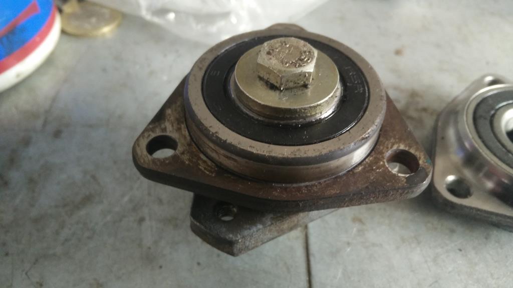

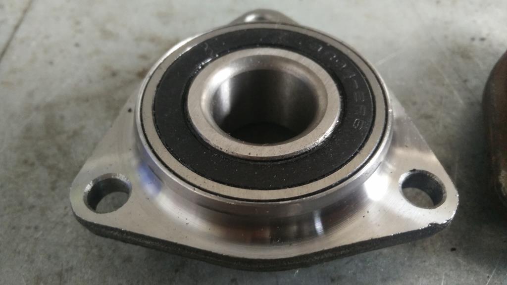

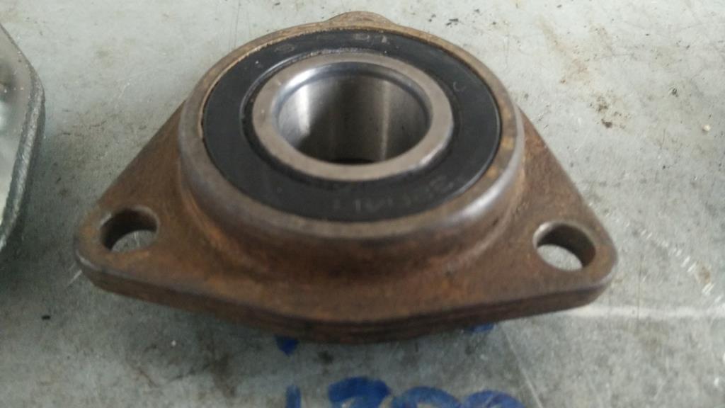

This is the fan bearing as it comes from Audi:
The hub can be pressed out, but the bearing housing and flange are one single piece:
This is £13, ebay listing here
Its listed as Audi 100 & VW LT, but the part number is in the description which is how I found it. With this one the flange and bearing are separate so the bearing can be changed.The holes are a bit off-centre, but they're close enough for it to bolt in to the bracket. No idea how long the cheap Chinesium bearing would last, but I guess for low-mileage D2s it may well be acceptable for 1/20th of the price of a genuine one!
I may well buy a few and a few SKF bearings to go with them, then I have good ones ready to go if needed

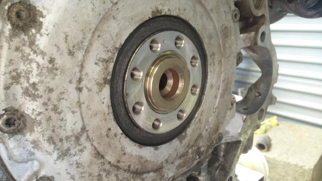

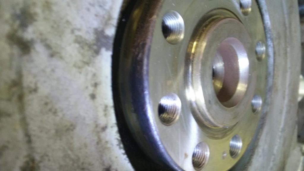

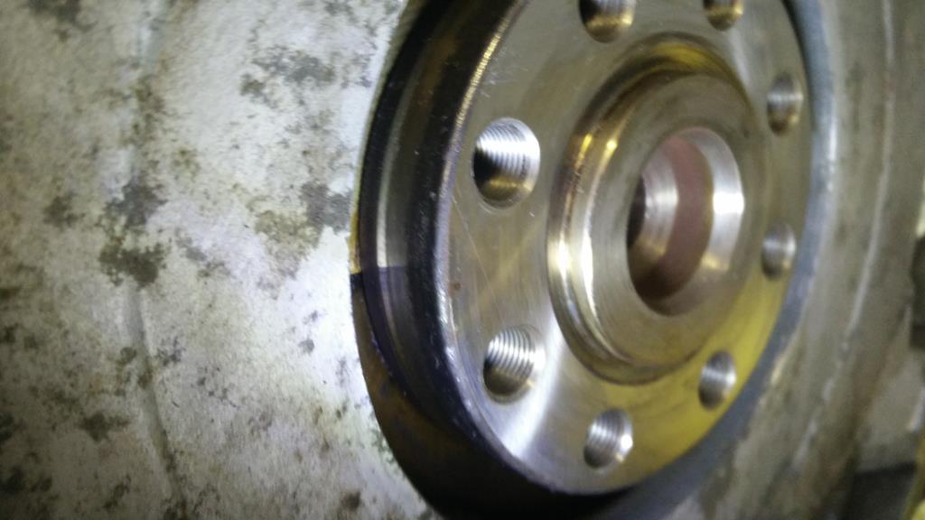

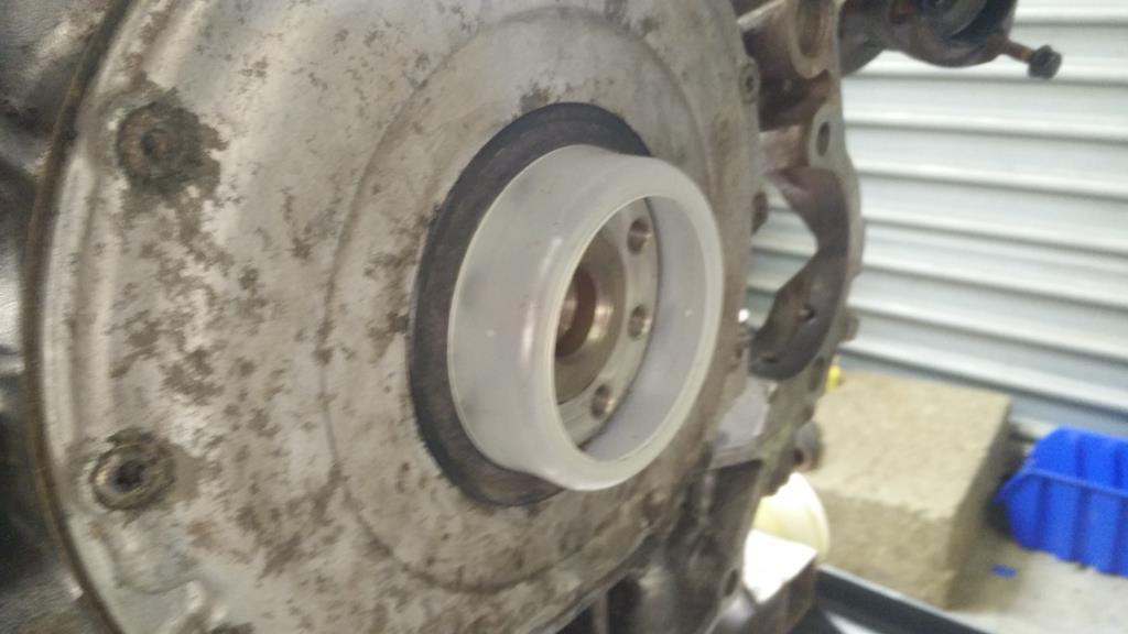

Some work from the weekend - fitting the new crank rear main seal. The end of the crank was pretty crusty
Cleaned it up with a wire brush in the dremel

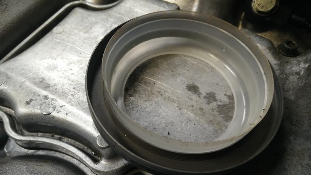

The new seal comes with an interesting plastic sleeve which fits over the end of the crank to allow the seal to slide on without damaging it, similar to what I do with the plastic bag for the CV boot
Push the seal in thus, then pull the plastic sleeve out

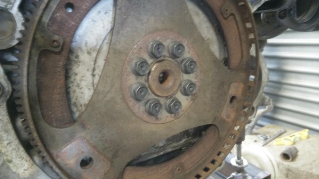

Drive plate back on with new bolts

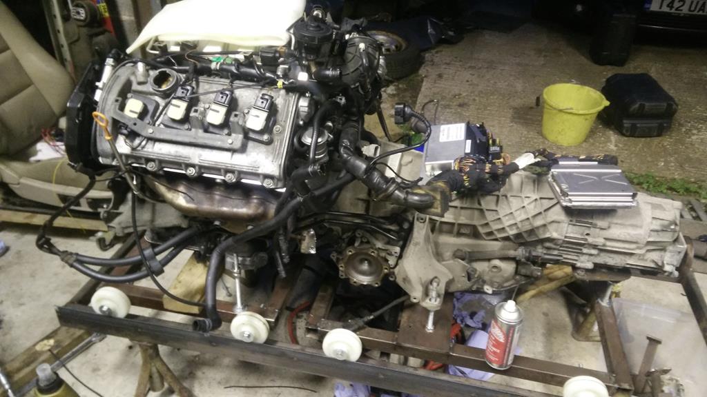

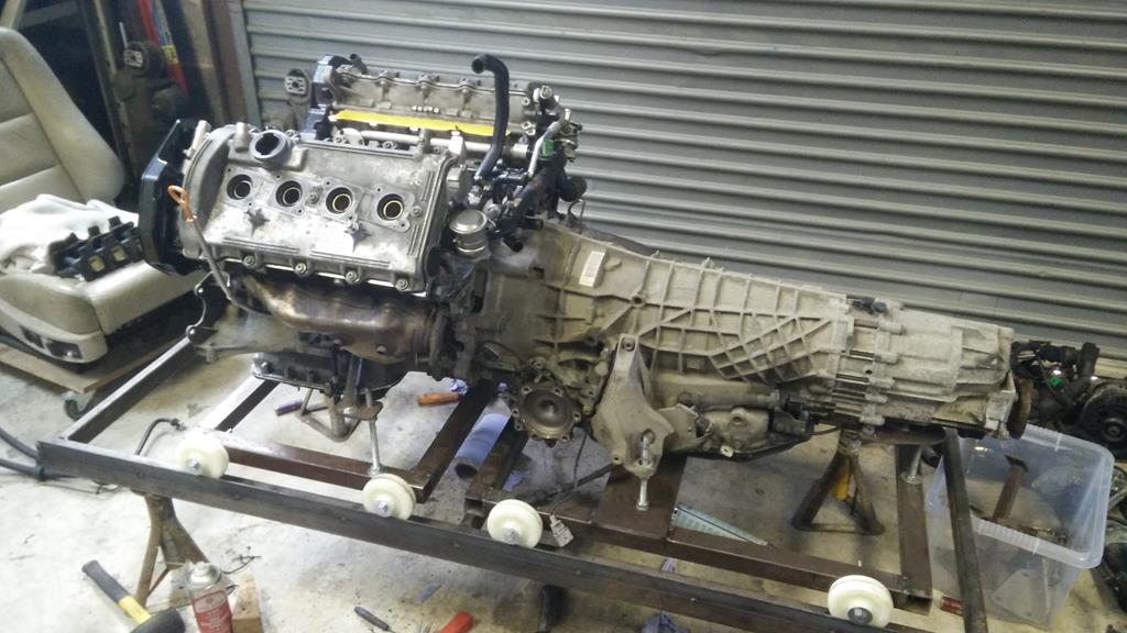

Roll the engine and gearbox back together. With the machine, I can literally pop them together with finger and thumb
Its at this point I got stuck because the bolts to attach the torque converter were still sitting on the shelf at TPS

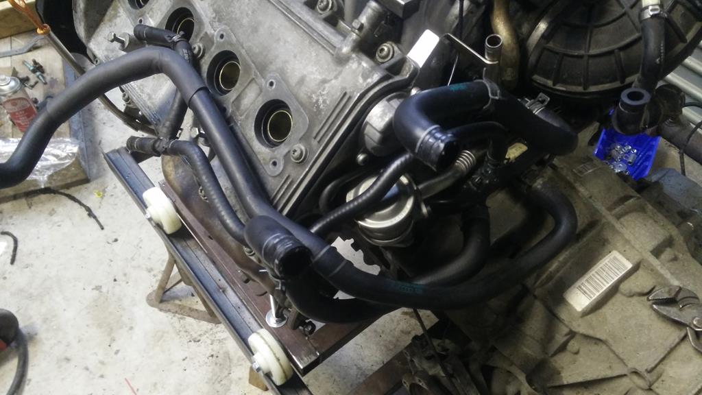

I managed a couple more jobs. Ready for the inlet manifold, but I forgot to take a pic of the manifold back on

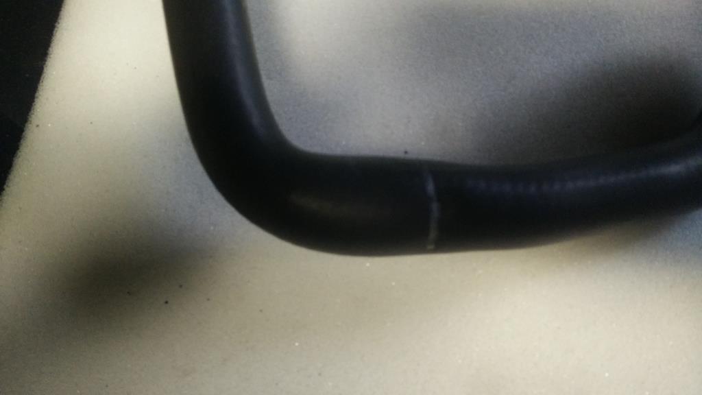

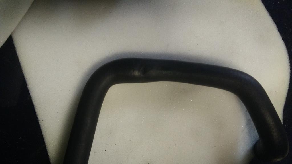

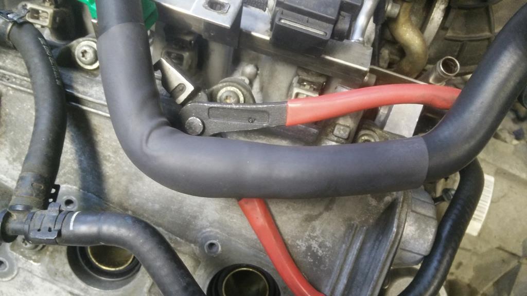

The header tank hose is a little worse for wear.
Unfortunately we can't get these any more so mitigation is the only option. I covered it in some high-temperature heat-shrink sleeving. I'll form this to shape better when its installed. The sleeving shrinks at 200+ degrees so it's quite happy at coolant temperatures, and it will protect the hose from any more damage.
The rest of the coolant hoses installed

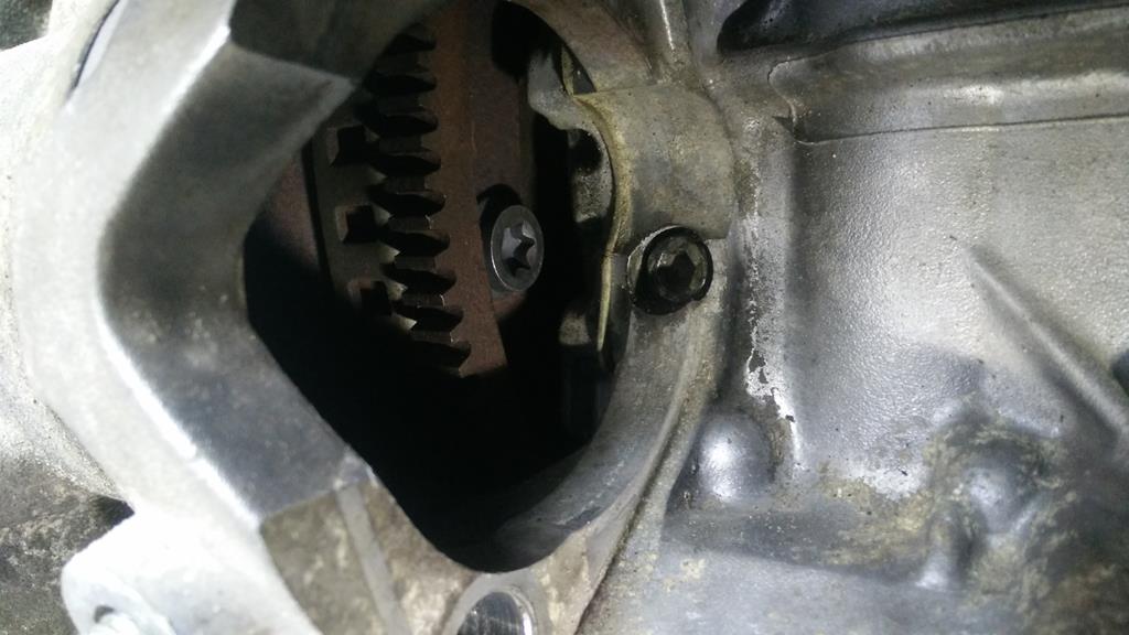

And now today's work. The missing bolts arrived this morning. You can see why I got stuck without them!

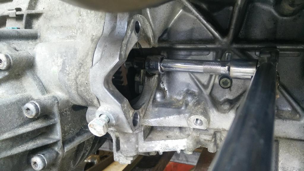

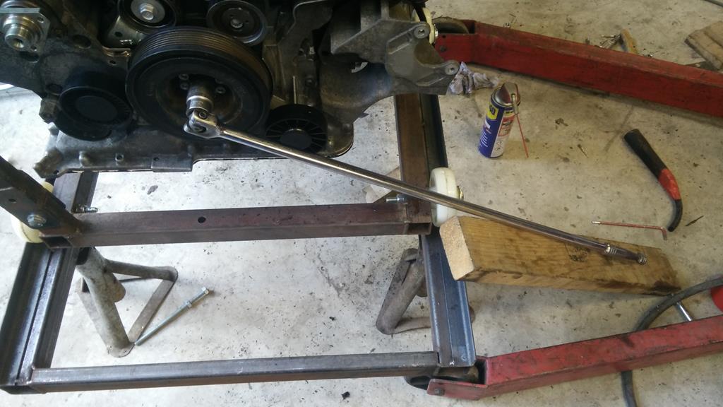

Torque to 85Nm through the starter hole!
The crank is held still with the breaker bar while tightening the drive plate. The crank locking pin can't be used for this job because there are three bolts so the engine has to be rotated to specific points

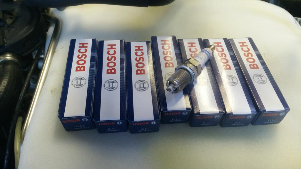

Bosch FGR6KQE spark plugs - exactly what the factory fitted but without the Audi logo and 1/3 the price How many mechanics use a torque wrench on spark plugs, or even bother to read the torque specification on the box? One - me! I am amazed every time I take an engine apart how completely randomly tight or not the plugs are. Some are gorilla'd in, some are only hand-tight! Its really not that hard to do it properly 28Nm in case you need to know
