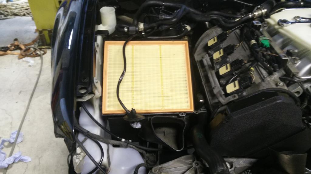

Take a look at this lovely genuine air filter. Marvel in it's filteryness, for it is almost the last one ever No more in Germany, five remaining at various TPS branches around the UK, which will shortly be in my stock. The really stupid thing is that I'm paying the same for the genuine filters as decent aftermarket

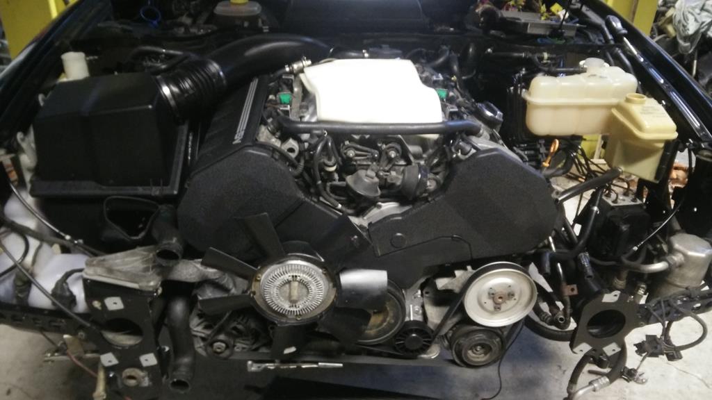

Pretty much back together now. It just needs the ECUs hooking back up and the front panel putting on and its ready to start

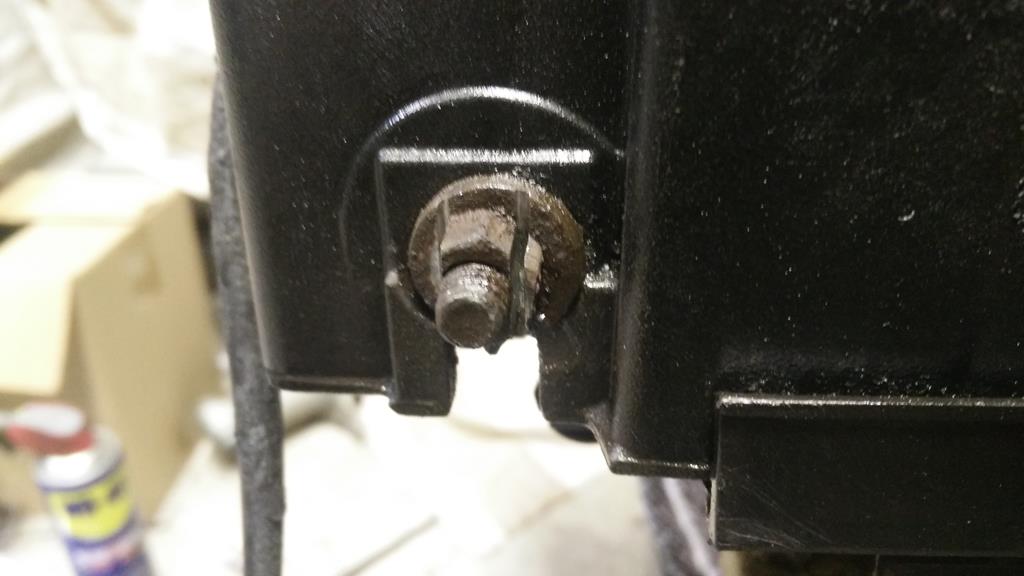

I'm changing all the cooling components, including the thermo-switch in the radiator. For that, the radiator has to be removed from the front panel, and to do that requires tackling these rusty nuts on the bottom. They are always seized to the stud, and you can't just wail on them because they are part of an NLA rubber bushing which will snap.

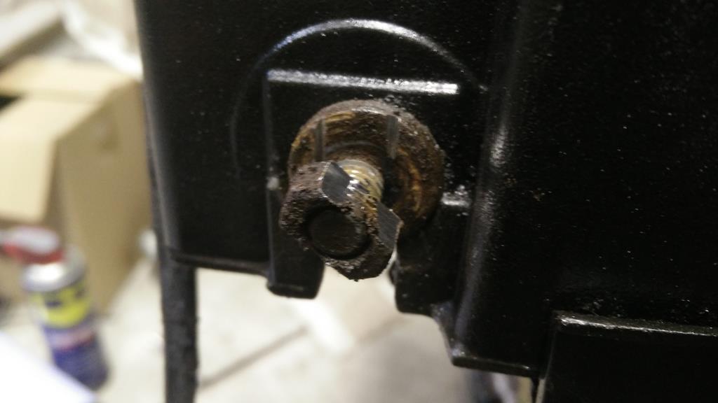

Slice the nut in to bits without damaging the stud:
then it comes off relatively easily. I'll clean up the threads with a die before it goes back in

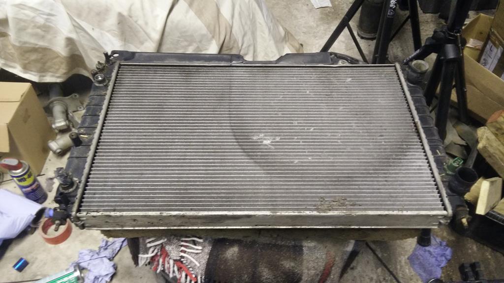

The radiator was already sitting flat from when I drilled out the broken bolt so I could just lift off the front panel

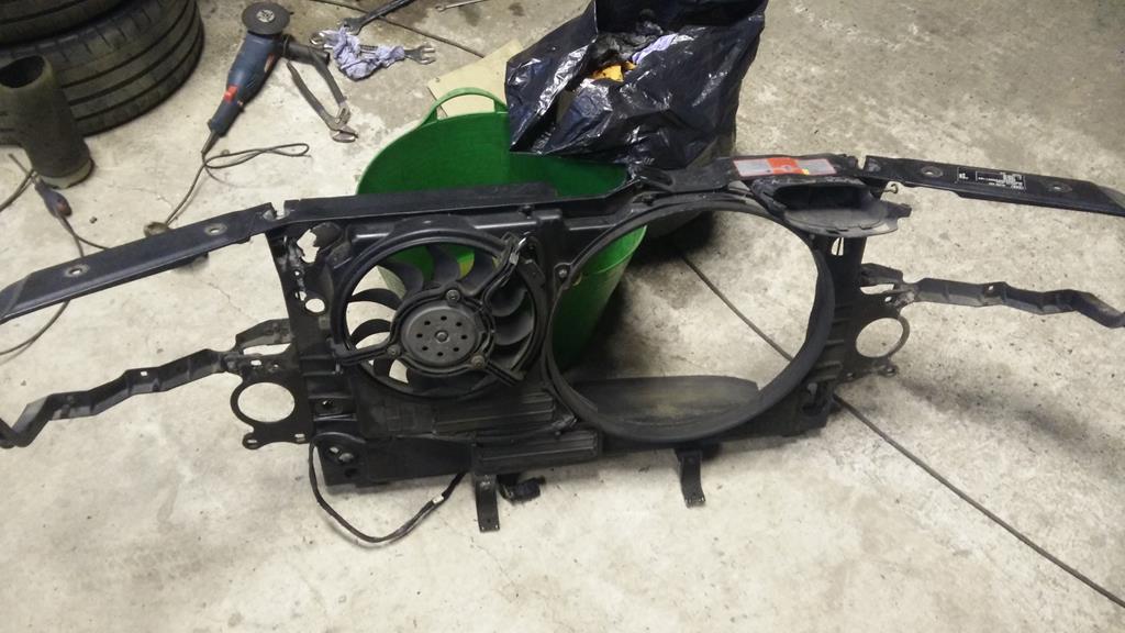

Front panel - this needs cleaning before it goes back on
NOooooooo!
So if I go to the Audi dealer today they won't be able to order an air filter? Why would they stop making a service item?
That's terrible! Is there an aftermarket filter of equal quality?

No more OE!
Mann filters it shall have to be then.
2001 Audi A2 1.4 SE - Jaipur Red Pearl
  #59
Old 13th April 2019, 08:26 AM
That's correct. The filter is unique to the D2 so no longer available as part of Audi's effort to kill off the older models.
The oil filter is also used in the Q7 up to 2008 so we have a few years left of those. Its likely the cabin filter will also go extinct fairly soon though.
There are still five air filters left around the country if your local dealer / TPS are prepared to do an inter-branch transfer. Mine are, but I think not all of them will. I'm going to hoover up those last few on Monday and then look at aftermarket ones to compare quality. Hengst and Mann make some original stuff for VAG so I'll start there.
