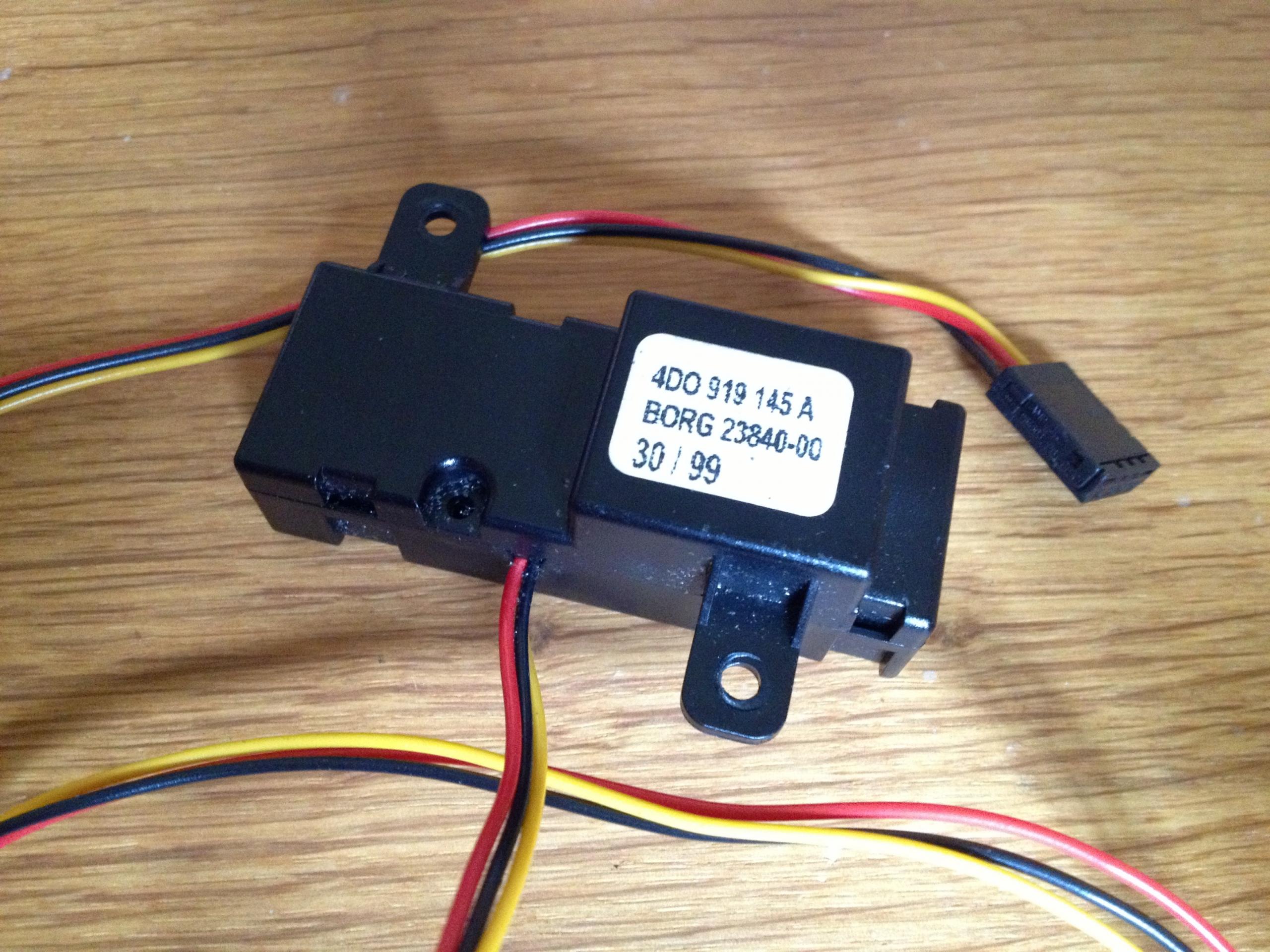

Well my module arrived courtesy of our sponsors today
Foam stuff has fallen to pieces - anything equivalent available does anyone know?
Bracket on order so will have to wait for a while

Old 11th September 2013, 01:30 PM
Any foam stuff used for packaging wrapped with Certoplast will be OK.
Remove knee panel and stick it to instruments panel.
Put module into driver's door pocket and wait for signal.
Then you'll decide where to attach it permanently.
You can drive for a couple of weeks without knee panel...
Old 11th September 2013, 01:56 PM
I'll see if I can retrieve any intact from the spare wiring loom I have
