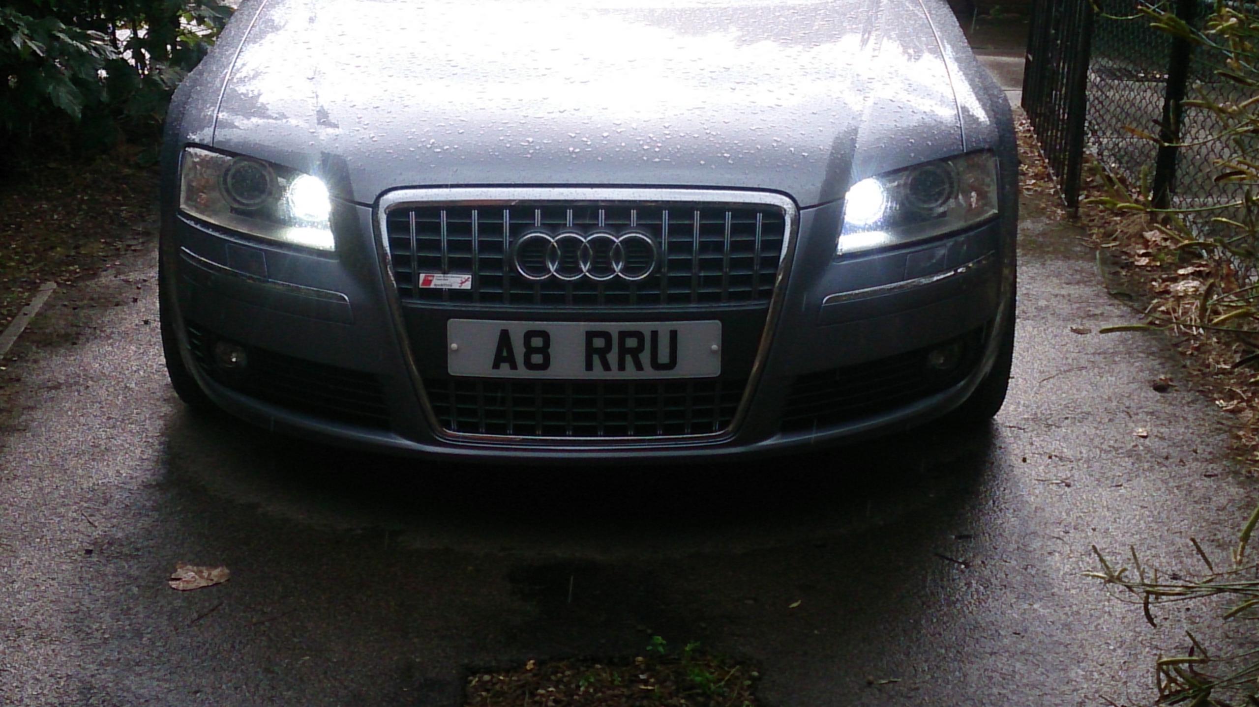

Hi Mark
I know how you feel mate, but you will have it sorted very soon.
Soooo, first question: have you got DAB?? If not, are you going to have one??
Why?? Well, best result you will achieve by fitting P21Ws with all CREE leds like in this link http://www.ebay.co.uk/itm/2x-P21W-50...item3f252e500a
...but, it's reported that CREE leds are causing some problems with digital reception, I think digital TV.
If you do have or planning to retrofit, then P21Ws with all SMD chips is your only solution, but they are not as good as CREE, lifetime wise and quality of the light.
Best sidelight I've ever fitted are the one from this link below, 2 years on and no problems at all, the construction is ideal for LEDs as there is no way 'head' will desolder it self from the base because of the heat and weight of the 'head' over the time. Main core is one piece of pcb and second one just slots in, very very solid. And they fit perfectly
http://www.ebay.co.uk/itm/3706414008...%3AMEBIDX%3AIT
Wiring, it's really very simple, just connect sidelight's positive wire with DRL's positive, sidelight-red DRL-white, like on the picture if THIS thread, but page 1.
Then all you do is change one digit in the headlights coding, from Bi-Xenons with separate P21W halogen to Bi-Xenons with LED DRL. This way you wont get any errors because of fitting lower wattage LEDs, no resistors needed and if you code them as LED they will dim when you switch to main beam, like the original LEDS do.
I think it's one of the best lights mod you can do. See attached the most recent picture after upgrading to full CREE LEDS, plus on page one you have a comparison of LED vs halogen

Hmmmm....CREE LEDs do reportedly affect DAB signal, haven't seen it my self. If you don't listen DAB, just Analogue then you'll be fine.
If you need to switch to DAB, this isn't ideal solution, but then you can quickly switch DRLs off via MMI.
SMDs from your link are way too big, well, they should be round not square as the hole is very tight.
Additional wiring is nothing else than making two bulbs to be seen as just one by the system, same loop. Original headlights with LED DRLs don't have sidelights.
Sidelights job is done by the actual LEDs by dimming them to like 10% level of brightness.
So all you do by wiring them two is cheating the computer and telling it you have LED DRLs, this way, as you do have actually LEDs installed, system is detecting the right current consumption and in result of that yo do not have any no bulb errors.
They won't dim while indicator is on. I may not be correct, by they do only when a DRL LED strip is close to indicator. Because original LEDs are very bright, they make indicator less visible when DRL is very close to them.
In A/S8s the actual LED DRL is on the other side of the headlight.
So, you don't need to wire indicator with your DRLs , you'll be absolutely fine and legal.
