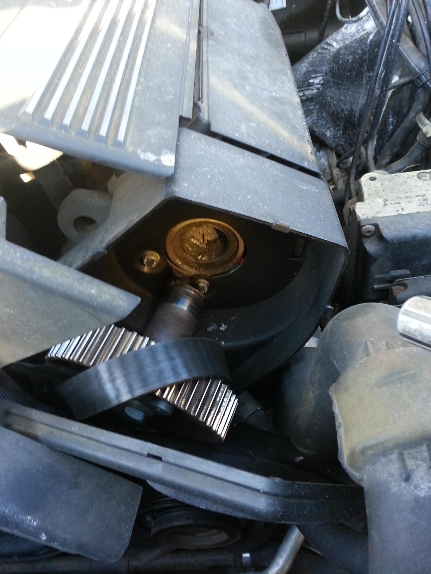

Here's a 2.8 that had an oil leak, the owner neglected it until the cam shaft became so staved of oil it heated at the main bearing and snapped.
