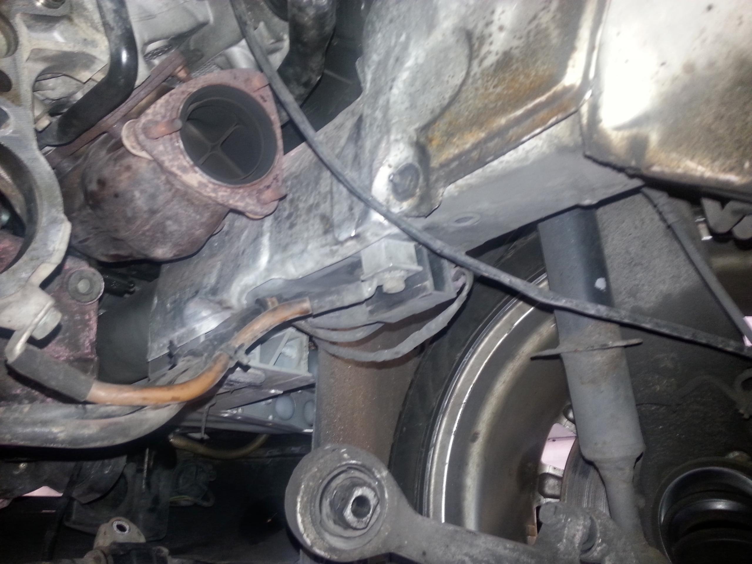

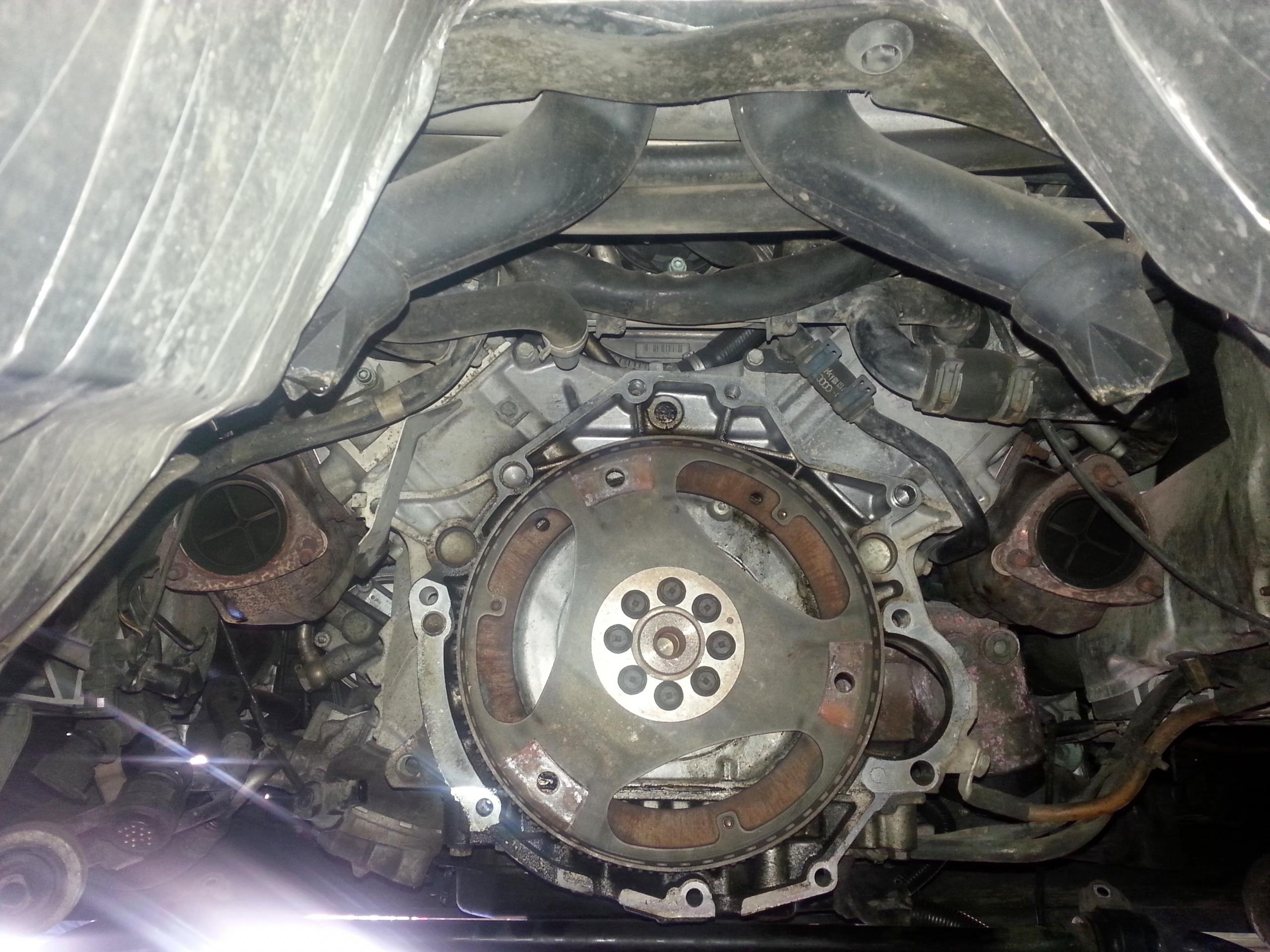

Great info. Where is the bolt?
Old 9th October 2015, 06:13 AM
Absolutely great info.
Location and picture of the bolt please.
Will fix mine preventively.
Old 9th October 2015, 06:48 AM
Posts: 5,168
Yep, I'd like to know too.
BTW, welcome to the forum and, if you've been lurking you'll know, pictures are a must!

Default Where is the bolt?
I think it may be shown in one of the two photos that I took when my old barge was having its gearbox done last year. The clearer photo of the back of the engine (nearside on the left of the photo, offside on the right as you look at it) also shows quite nicely two of the big fat drains either side of the flywheel/gearbox housing. I gave them a good squeeze at the time, due to the lack of access when it was all put back together.
There is a big old earthing strap which is brown in colour coming from somewhere on the engine/gearbox housing which leads to this black plastic box on the chassis rail - you can just about see it on the far right hand side of this photo. The other photo which is slightly out of focus (apologies for that) shows the back face of the OSF wheel and chassis rail power block/box.
I hope that this information is of some help. Please feel free to correct me if I'm wrong in any of my assumptions.
