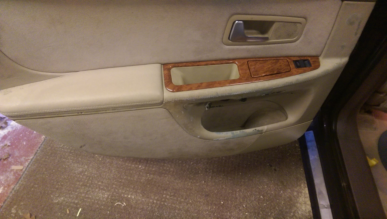

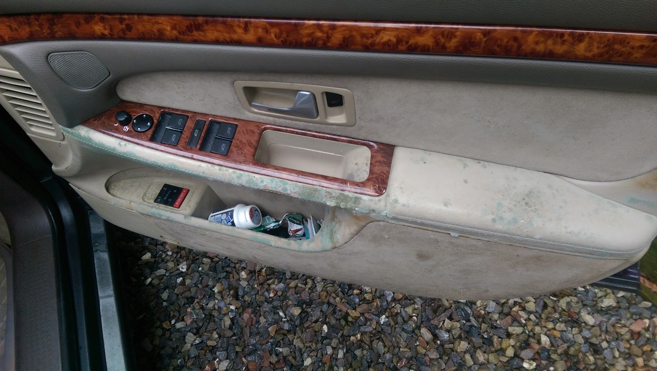

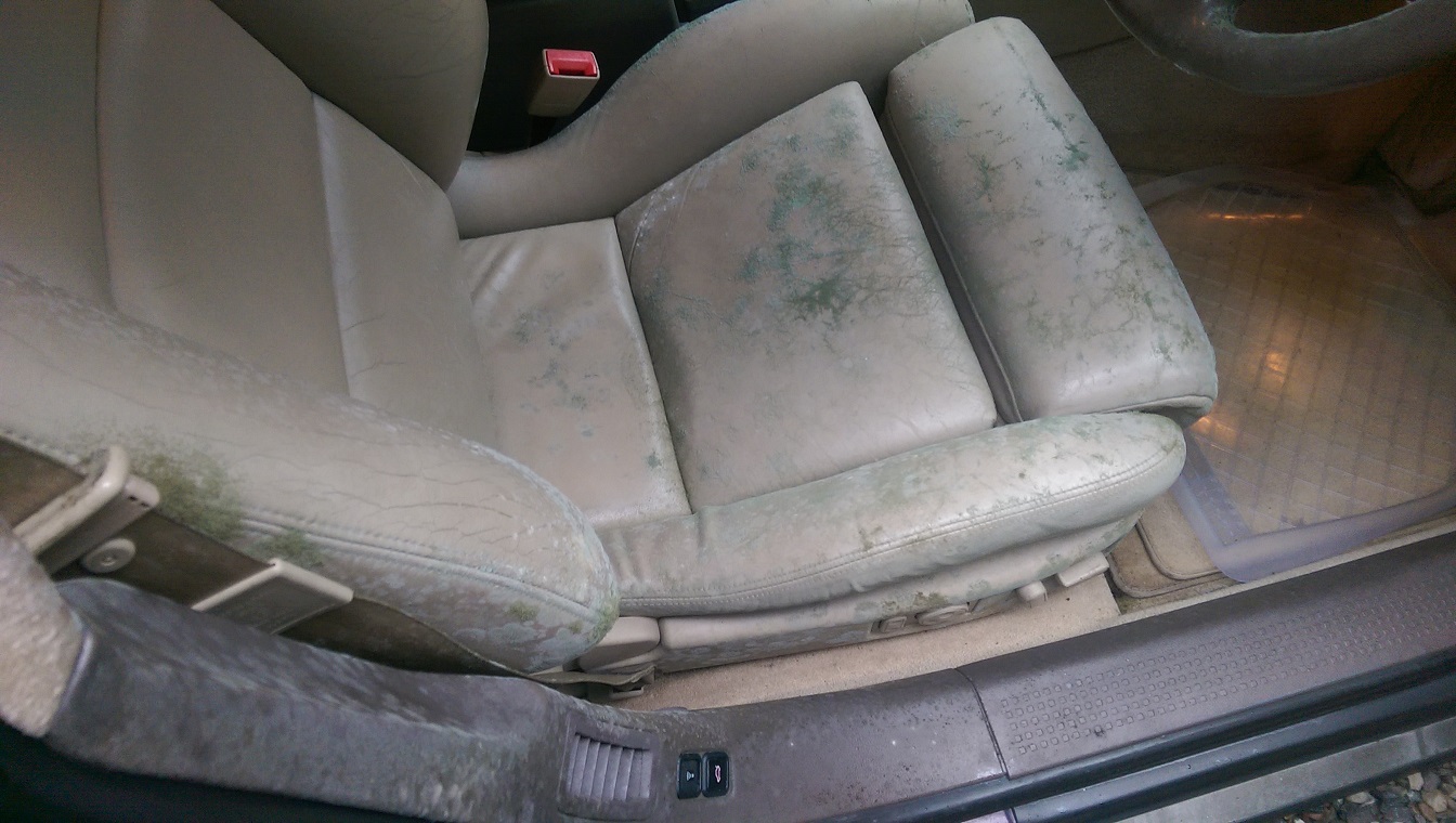

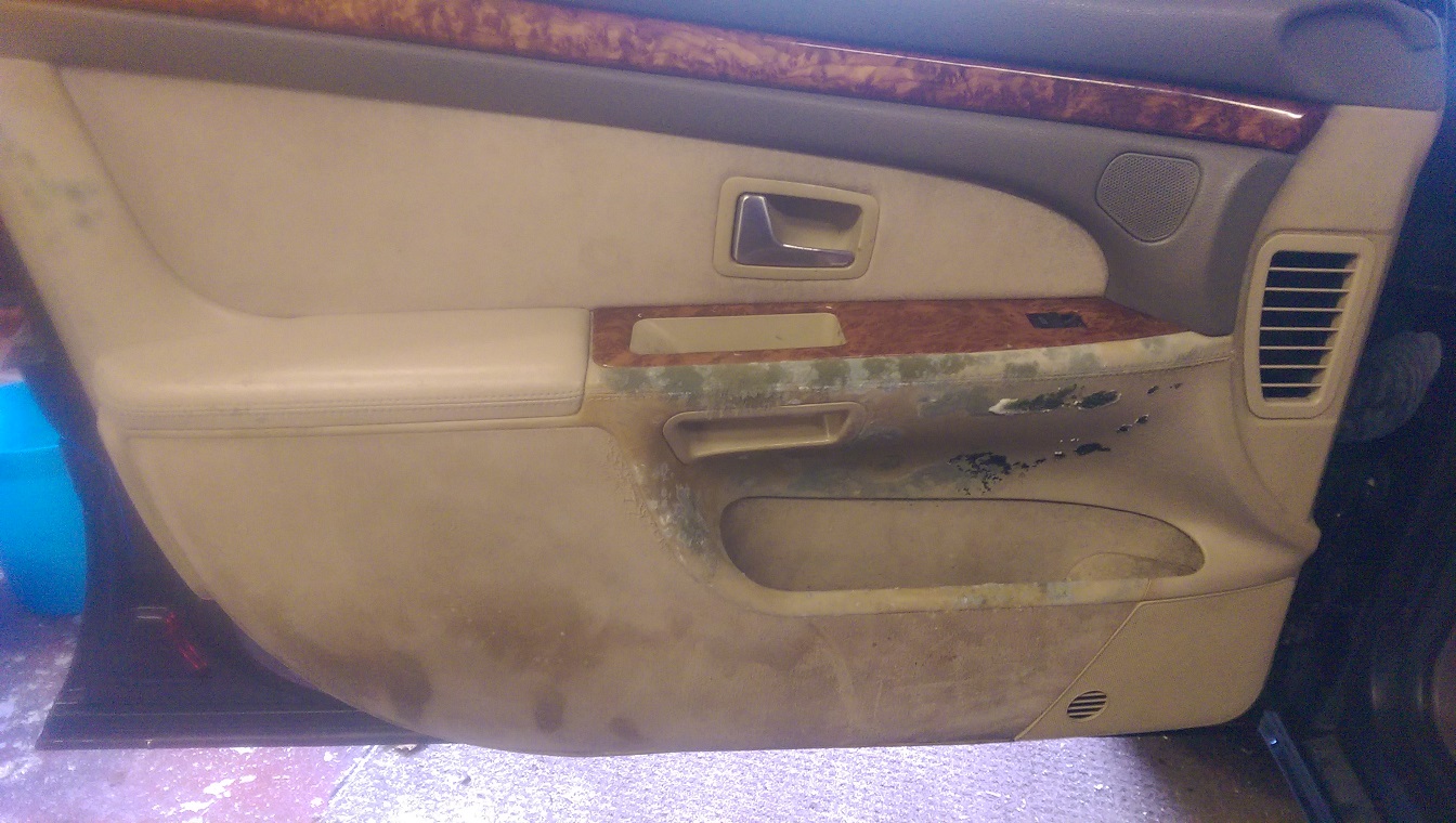

Got back from our trip and found this!
Car has been kept outside since I bought it almost 5 years ago. Never seen this before.
Its all over the leather. Seats, Door Cards, Steering wheel etc. Fortunately the Alcantara is ok!
The foot well carpets are damp so I'm guessing the drains blocked while I was away. Funny thing is the mold is dry and is coming off the seats well. Door cards are a bit stained though. Maybe a trip to Eaglescliffe is in order!

I've had my seats go like it in the past front and rear but not the door cards. I wondered if it was just the fact it was a little damp inside or if it was linked to products i had used to clean / condition the leather?
Old 4th January 2016, 03:12 PM
I've had some mould growth in the past, especially on the leather, but not quite that bad and not so widespread.
The really bad areas I saw were on the door shuts and bottoms of the door trims.
Cure the water ingress and dry it out (slowly) with silica gel bags. Keep an eye out for leather shrinking and peeling off the backing as it dries, you may need to soften, stretch and reattach some of it.
The mould will just go as it dries, hoover it all away. When totally dry check for staining and clean carefully and appropriately.
I think Alcantara just needs gentle sponging with tiny amounts of water and very dilute mild detergent - don't soak it.
Leather I use Woollies products to clean, recolour and recondition.
