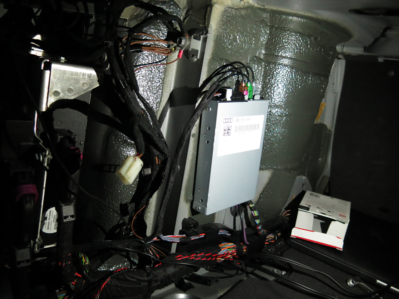

Had a look but not sure if I have the right area. Is it in the left side where the navigation unit and bone amp are or further in right behind the seat??

Further back near the suspension strut
From Del's retro fit
Matt

That area where I fixed the reverse module is not the factory location, it should be further forward just behind the seat but same side of the car, in order to get access to it you need to remove the trim from left side
