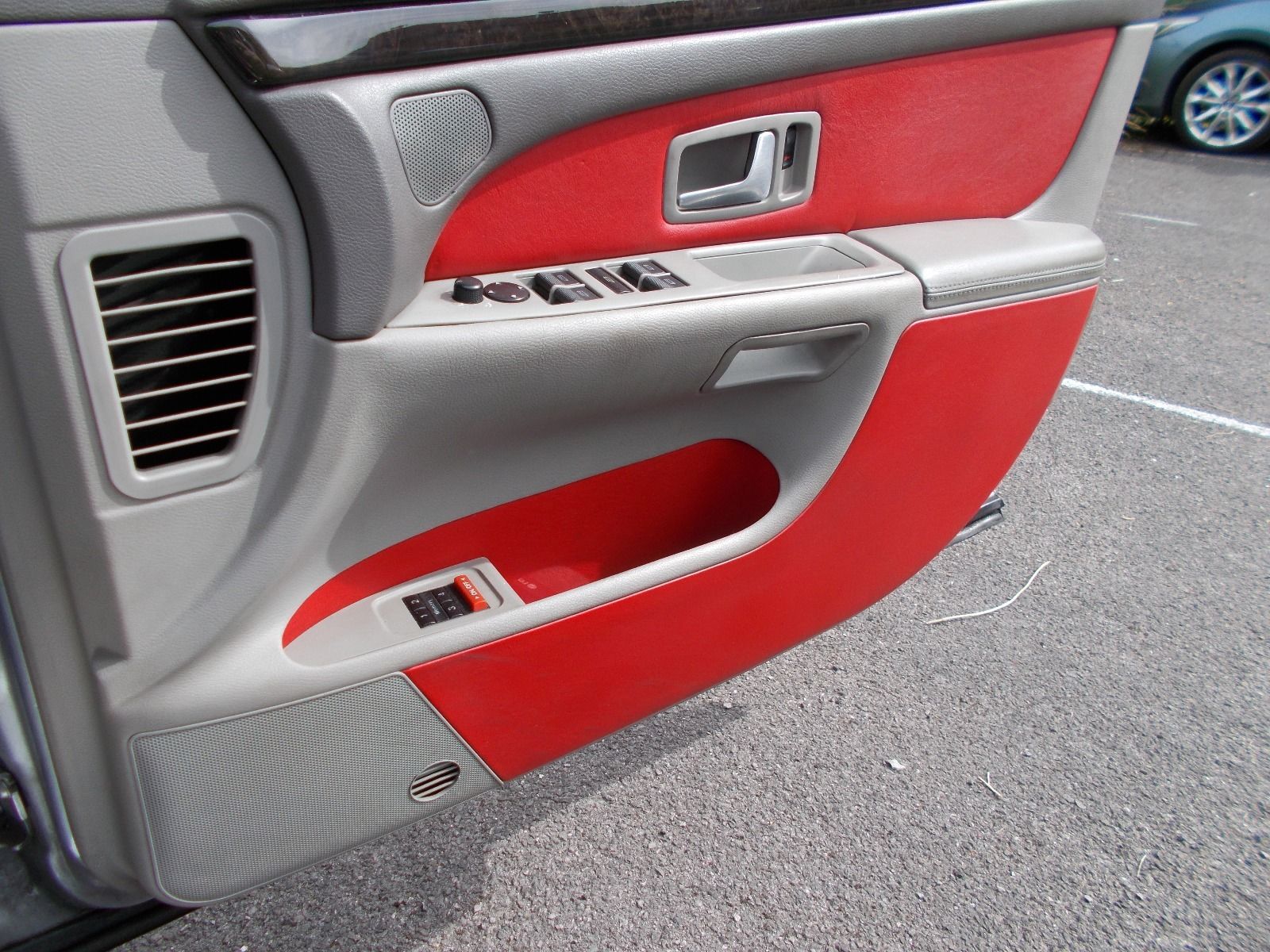

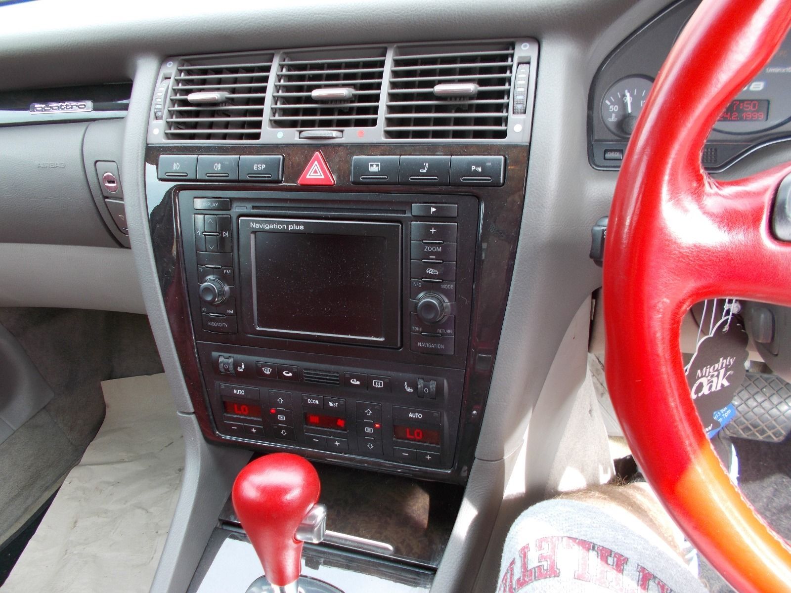

Mine also does not have the extended leather that Adrian had on his. Check my album photos of interior.
Mine does not have the door arm rest wood capping's either. They are colour matched grey plastic. See photo.

Thanks for that Looks like this one does have extended leather then since the middle of the door and underside of the dash are also red. There's nothing on the spec sheet to suggest that though.
