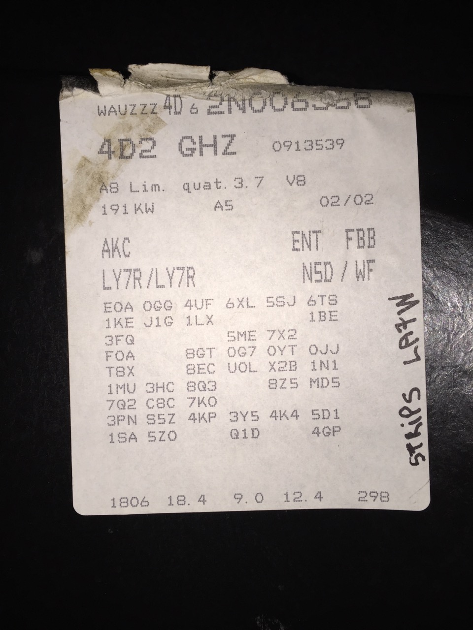

I've got D2 FL 3.7 2002.
Checked my boot sticker with PR codes and I've got 0GG = Emission standard EU4.
Looks like my car is compliant, but it seems I will have to get paperwork/confirmation (from Audi ?) since emissions class is not mentioned on my V5C.

My S8 seems to fail: 0GE Emission standard EU3.
Not that I ever take it into London.
But as Euro 4 is dated 2005 I don't see how it (or any D2) could ever be compliant.
£12.50 daily charge to pay if you have to go there, not many miles of petrol in an S8.
You sure?

We love going with family to London on weekends, so I care about the subject.
>> You sure?
After failing so many times on this forum I can't be sure on anything,
but here is my boot sticker with 0GG clearly seen on it.
I also have full printout of PR codes (that Audi will do for free) and there is 0GG in there as well. There's a plenty of websites that will decode the PR code.
vag-codes.info/vag-option-codes
vag-codes.info
They all confirm that 0GG is EU4 emissions class.
Is there a list of A8 engines that shows emissions class of each? It looks like D3s can be affected as well as they had diesel engine option in the UK.
