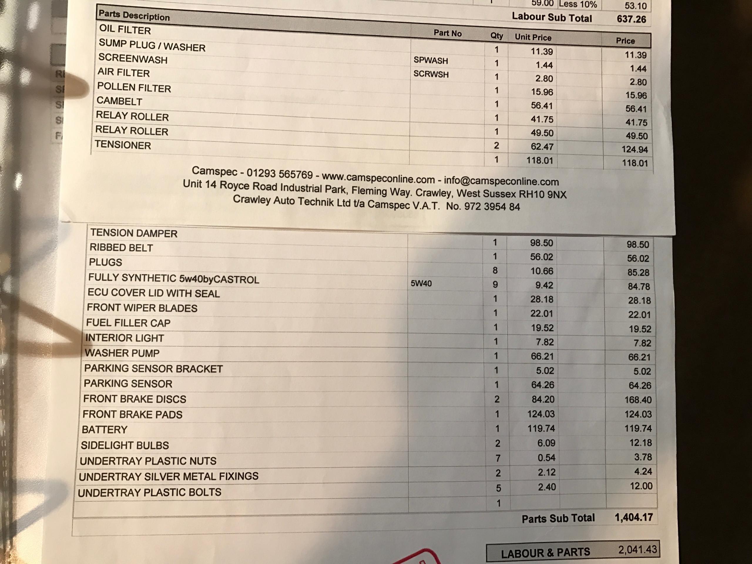

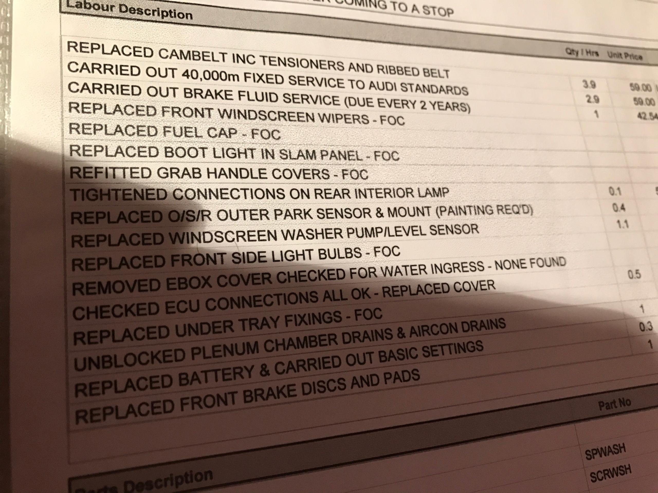

So the last place to do it were 'CamSpec' a crowd down near London Village which I believe are reputable. Was done at 36k (05/2010), car just over 70k now.

Jaysus wept, just found the rest of that receipt.... 2k, bring tears to a glass eye.

Old 2nd February 2017, 05:11 PM
Sounds about right, if done properly. And being Adrian's old car it will have been.
(I did have the water pump and thermostat replaced too)

So I was quoted £950 for belt, pump and thermostat. I spoke directly to the guy that would be doing the work and he himself said that the belts don't go, it's the tensioners and pullies that go first.
Was actually a bit dubious about the garage until I spoke to the guy, told him I'd normally do this work myself, but FSH. We spoke about the v6's (my cabby is a v6) and he said that the belt setup was very similar so he did know his shizz.
The place was A for Audi and they have a very good reputation and only use genuine kit. I have inspected her A3 Golf when it came back from them to make sure they weren't taking the ****.
But I think I have made my mind up, I'll keep the belt on it for another couple of years unless I can find something with a concrete "this belt only lasts x years"

I 'think' from memory Audi will quote 5 years as a time based interval, but given the low annual miles and fairly ideal storage conditions I was happy to stretch in time
I can't recall what they advised now on miles but was less than the book quotes
Camspec use all Audi parts so should be all good in terms of tensioners and pulleys etc. The original belt would've been 8 years old when changed, but with the period of low to no use somewhere in there.....
I'd be tempted by a cambelt kit from All German Parts on cost grounds
The only thing I don't know is whether the water pump and thermostat are original. If they are I'd get those changed too but be prepared for sheared water pump bolts
I've seen an S8 in bits for belt change and it's not as bad as people will have you believe. The whole front end incl headlights unbolts still attached to the slam panel and sits on the crush tubes
