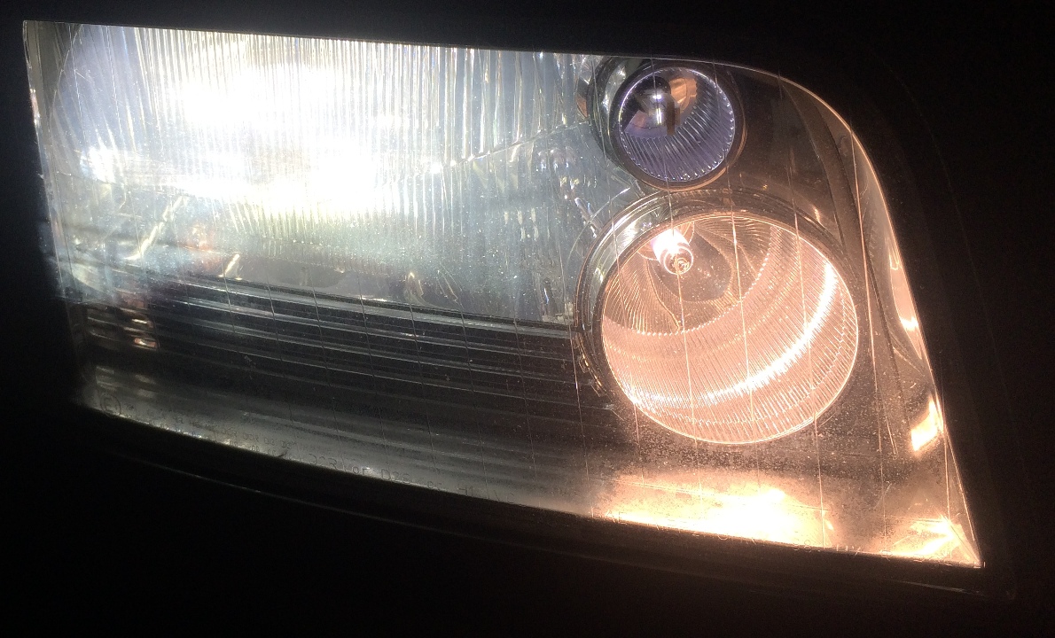

Pretty good match here too, those RacingVision bulbs are pretty awesome:
