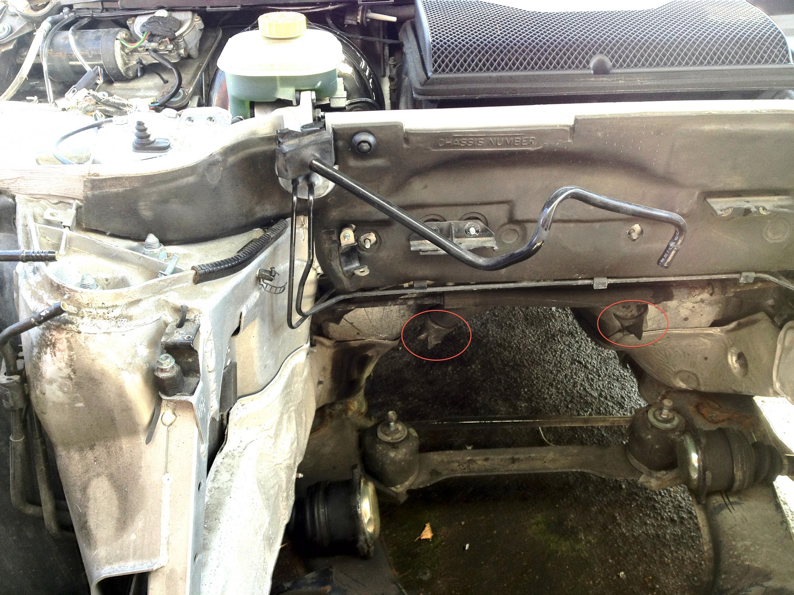

Under the bonnet, where water drains into from the windscreen. Access is largely blocked by the air intake to the HVAC unit.
It has a pair of big drains down either side of the transmission.
Mine gets blocked very easily from debris (leaves, seeds etc.) and overflows into the cabin.
The red circles on the attached pictures show plausible blockage points, mine is mostly the upper ones at the base of the tray (line drawing).
ID:	16475   Click image for larger version
Old 10th July 2017, 09:13 PM
Thanks! I'll check that too but I did not see any standing water down there even when I pour a whole bucket down the windscreen. Also seems too low down to be related to my problem.

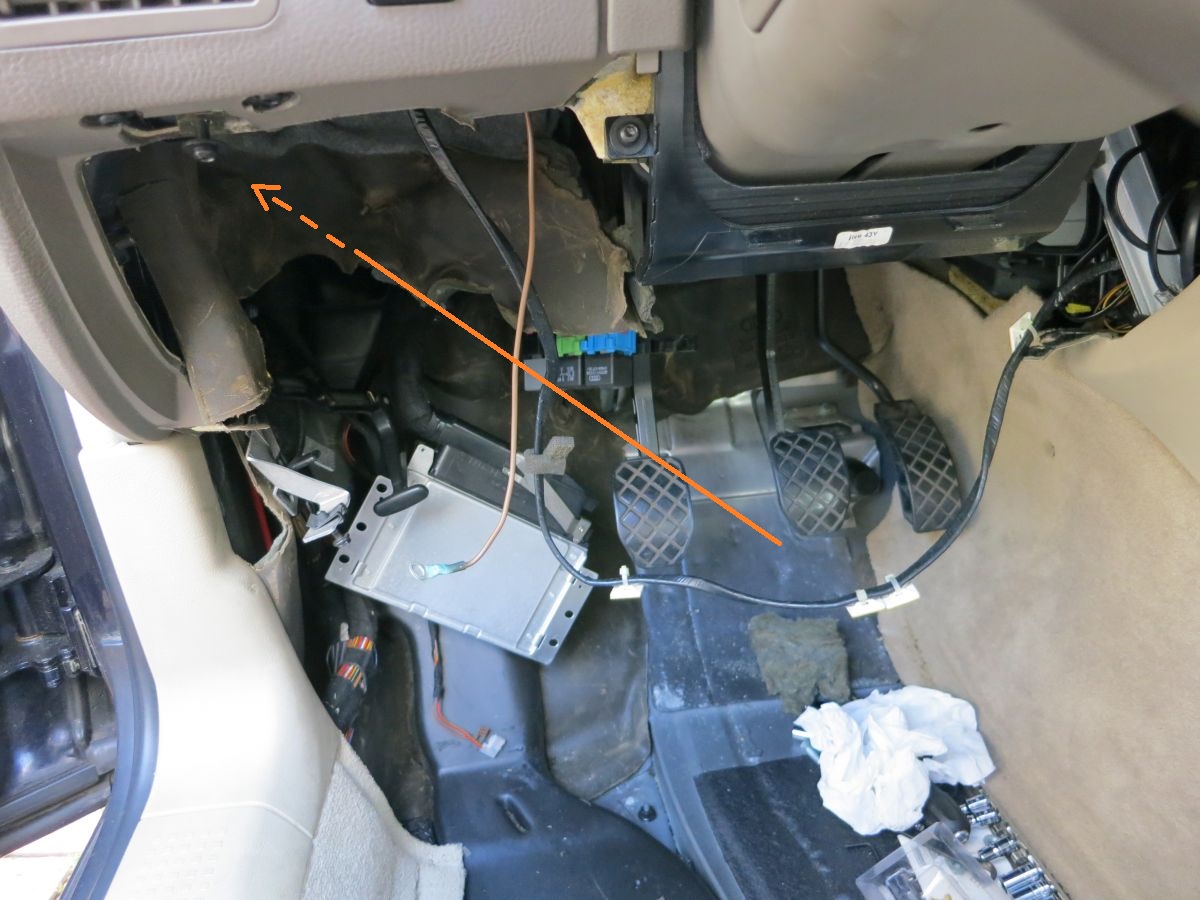

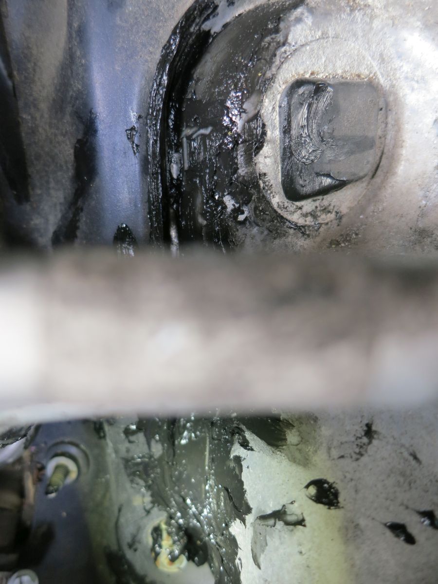

I was happy for a week Kept checking the carpet, it was dry, even after a little rain, but it was not a proper test. Then I washed the car yesterday, in the sun. And afterwards the carpet was wet, with warm water!
So today in despair and frustration I started digging in to the footwell dismantling any easily accessible trims to see exactly where its coming in. As it happens, from a most unexpected place!
I dug into enough sound deadening to be able to see the metal of the firewall and the mating joint of the pedal box. Then I poured a bucket down the windscreen. And sure enough it came in, to the extreme far left, from up above in the corner. Up there somewhere there is not just a single sheet of metal of the aluminium body, but a double-walled section a bit like a gently arched horizontal duct. And in the left corner before this double walked section has a square cut-out at the bottom. Water was coming in, like an Alien inside this duct and dropping in from above!
With the sound deadening pushed out of the way I could also see the other side of the grommets in the corner, there were stains just below the big grommet for the wiring loom, water had got in via that in the past but not any more. Probably from when the wheel arch drain was blocked, I often had standing water there, so watch out for that one, worth sealing I think.
But unfortunately for me I am still none the wiser where the entry point is for my water ingress. I also suspected the lower left coolant hose going to the heat exchanger. It has a white oval seal and the lower seal is looking worse for wear, I thought maybe this seal goes through this double-wall section and may be letting water in, but I found it from the inside and it is dry with no stains. Then I sprayed water directly at just the lower seal with a hose but nothing came in.
Here is the offending 'duct'
Who is the most knowledgeable D2 genius who can solve this mystery?
Zoomed out a bit
Name:	Water ingress mystery 1.jpg
ID:	16481   Click image for larger version
Name:	Water ingress mystery 2.jpg
ID:	16482   Click image for larger version
Name:	Water ingress mystery 3.jpg

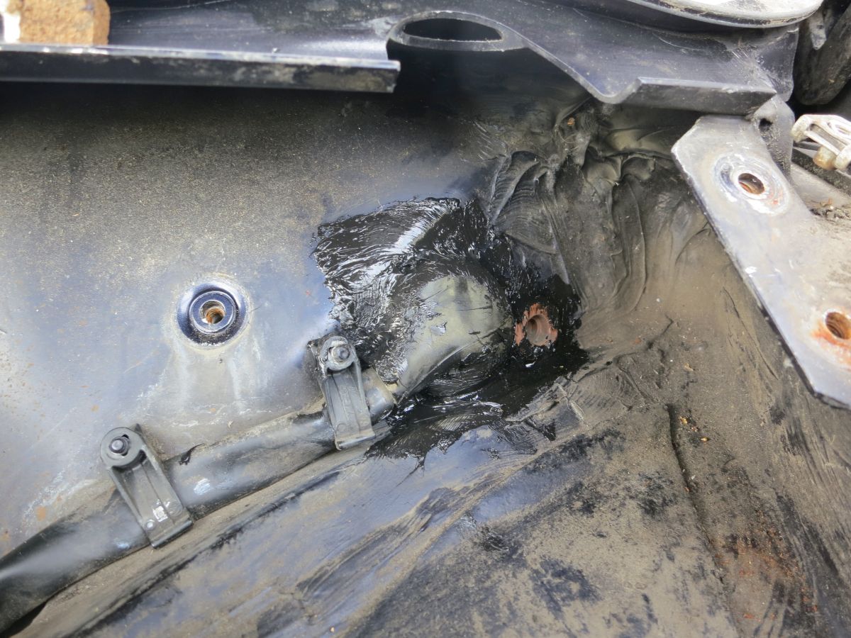

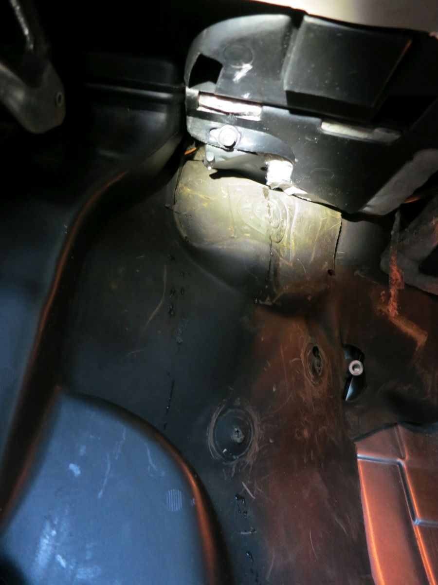

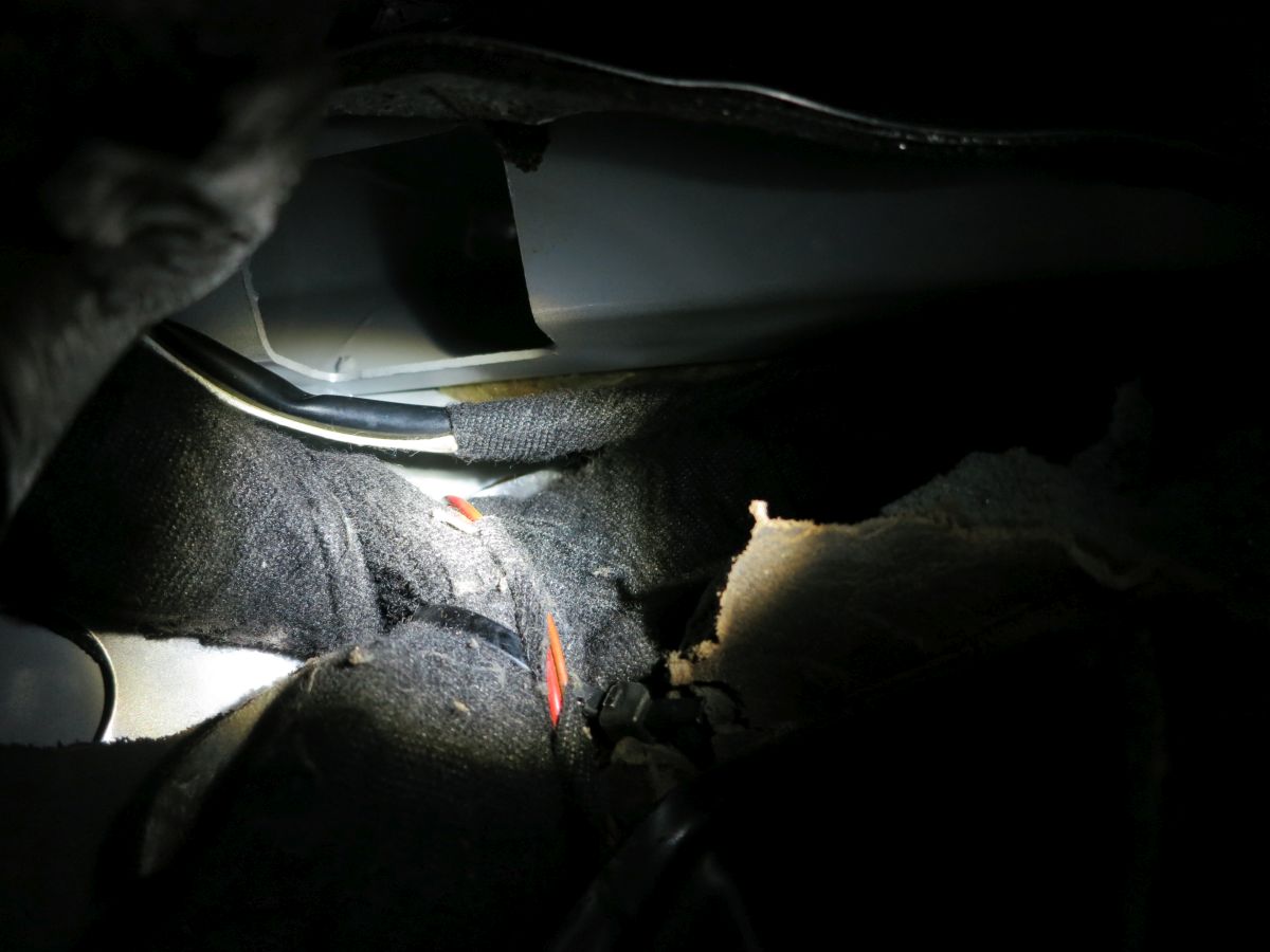

Old 10th July 2017, 09:09 PM
Here are pictures of this attempt to block the water ingress.
First picture is evidence of water dripping in.
Name:	Water ingress drops.jpg

Name:	Water ingress rubber seals sealed.jpg
ID:	16478   Click image for larger version
Name:	Water ingress Pedal box sealed 1.jpg
ID:	16479   Click image for larger version
Name:	Water ingress pedal box sealed 2.jpg
