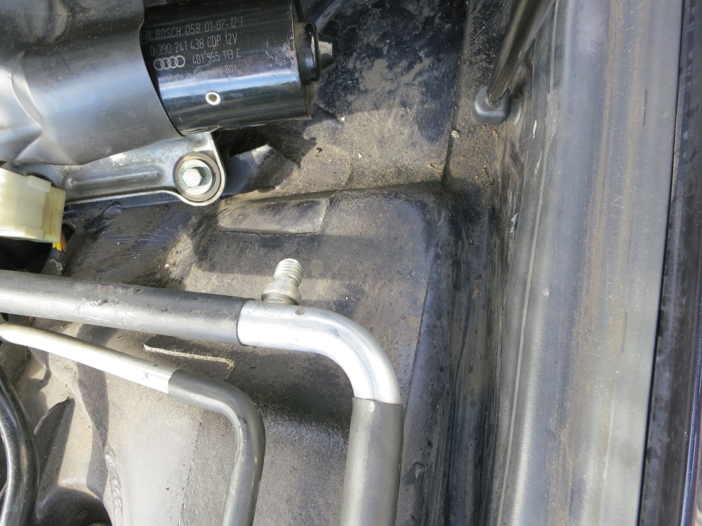

Mine looks like this. He showed me the connection point to the aircon machine, it was too big definitely much bigger diameter than the valve on my 8.
Perhaps most other places carry adapters, I can't imagine all cars have the same valve?

Old 17th July 2017, 06:51 PM
Where is that? Looks well back in the engine bay.
I had my aircon "done" at A8parts after the summer meet and I thought the connector was on the radiator?
(They did inform me that, unlike some systems that have two, there was just a single port.)

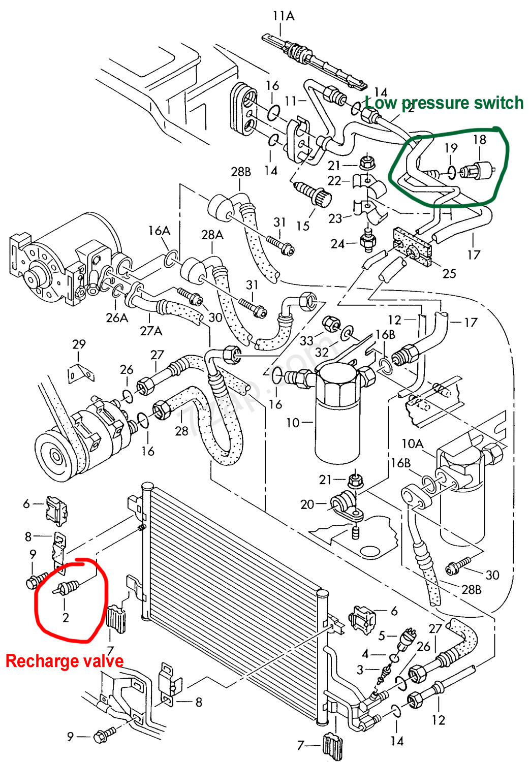

+1
When I searched for the part number, the diagram showed the valve being located on the rad.

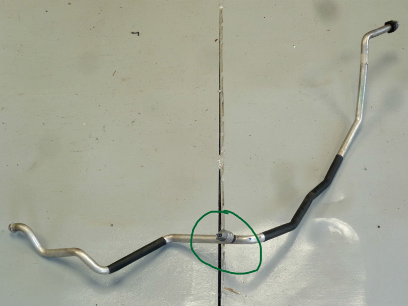

Goran, your photo looks like the position and connection for the low pressure switch (8A0959483AA)
ID:	16548   Click image for larger version
Matt

Its just in front of the wiper motor. That's the only location they found, doesn't mean there aren't other, they looked pretty clueless. I did a little research on Elsa beforehand, unless I read it wrong (it is a a bit confusing) that is the service port.

Bottom left in this picture "borrowed" from our sponsors?
There are two connectors, but the low pressure one is very difficult to get at hiding between the fresh air intake and the ECU box (along with the heater hoses and auxiliary pumps and anything else they can squeeze where your hand won't fit!).
Standard aircon quick connect fittings won't fit without some sort of extension. My mate did manage to connect it up at some point, but it kept slipping off and he ended up charging it from the high pressure port only anyway!
