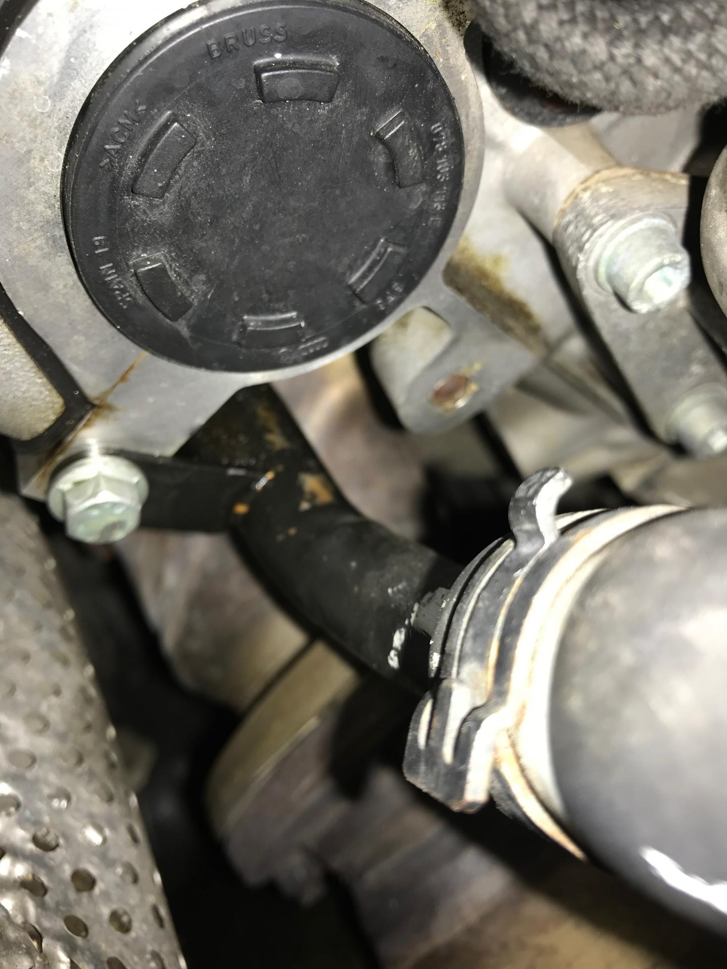

Picture 0 show where the light smoke coming from (smells like when the oil drips on hot surface and then evaporate)
Picture 1 show old cap with a leak (It leaks on the hose then it slides on the hose then drip on the manifold and evaporate...that's what I think)
Picture 2 show new camshaft cap (no leak but occasionally smell burning oil)
I will have to probably buy inspection camera to have a better look on the side of the engine block.
