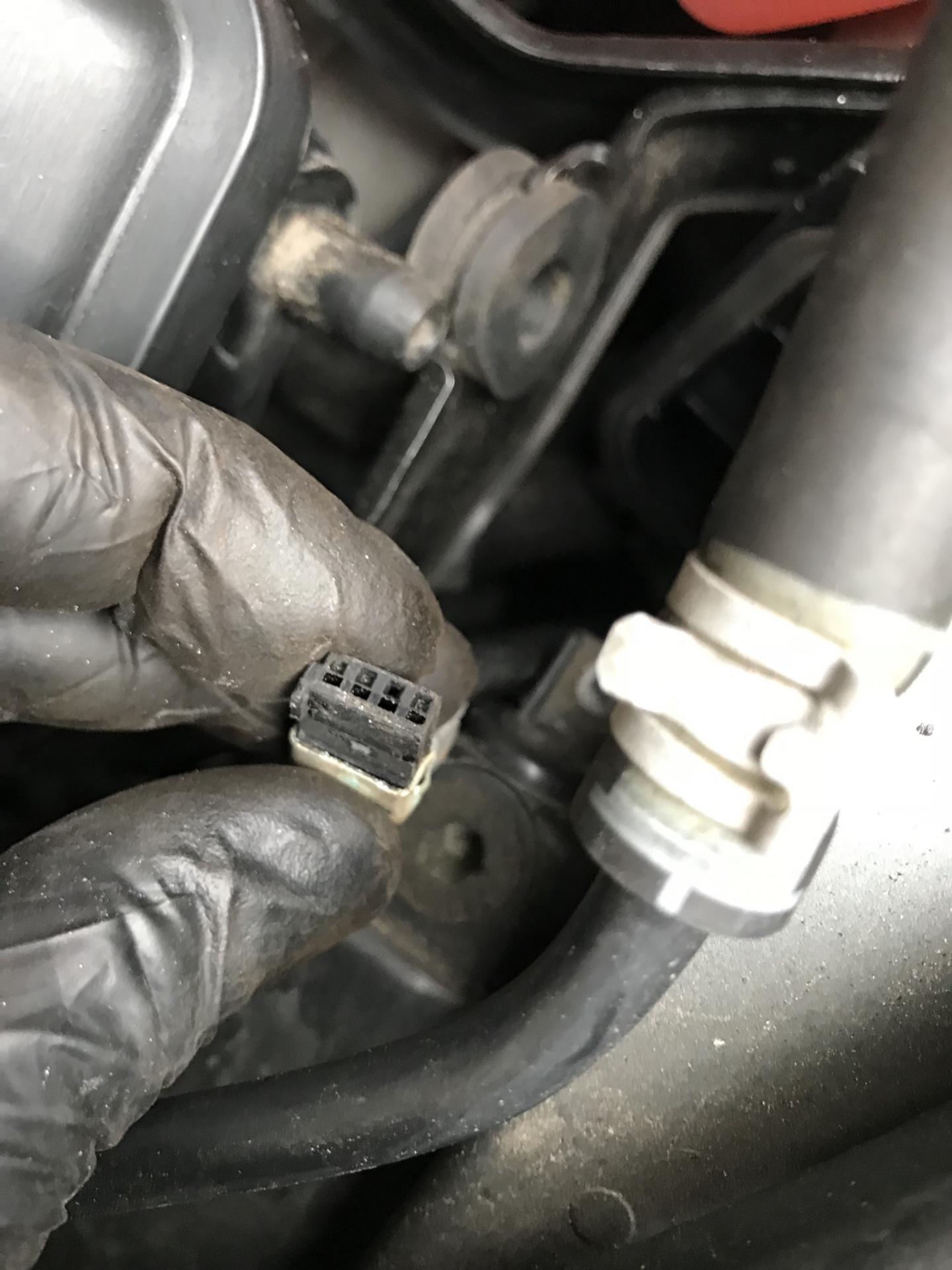

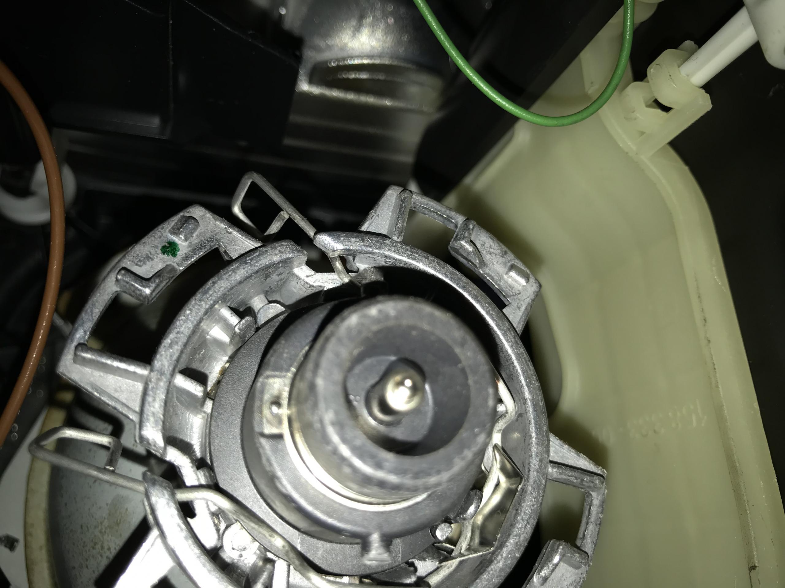

I bought some replacement LED headlights for mine, and realised as awkward as it was I didn’t need to remove the wheel arch, bumper or headlight. I did partially remove the power steering reservoir mount on the near side, and would have likely removed the air box on the far side.
It was a horrid job and ultimately pointless as the LEDs I’d bought didn’t fit my xenon (D2S) headlight enclosure. I’ll attach a few pics, don’t know if it will help.
It made me less likely to replace the bulbs TBH, just cos of how much of a pain access is.
