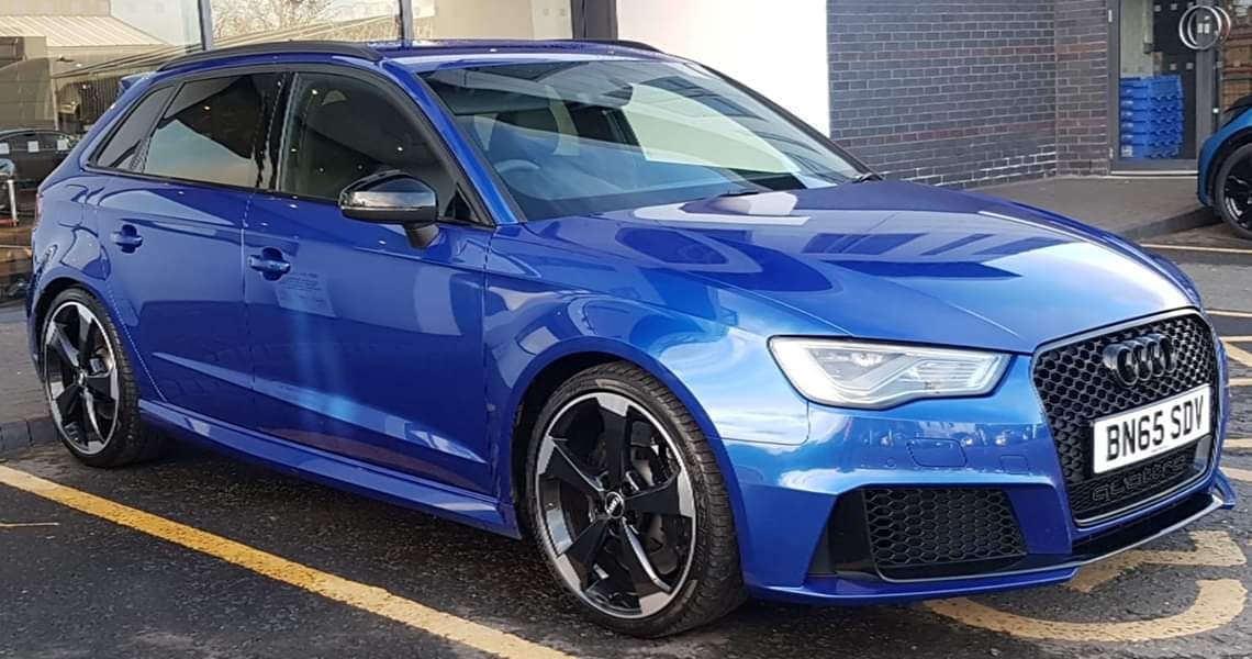

RS3 5-pot would be an awesome swap. 5-600hp, 5-cylinder classic Audi sound, inline engine so loads of space at the sides for turbo and manifolds. Length would still be an issue for an intercooler so it would need side mounts too. Still quite an expensive engine since it's quite new.
Is that not a transverse engine?...it is on Connor's new (to him) car
Last edited by briang9; 7th April 2019 at 10:16 PM. Reason: to add pic as I love the colour
