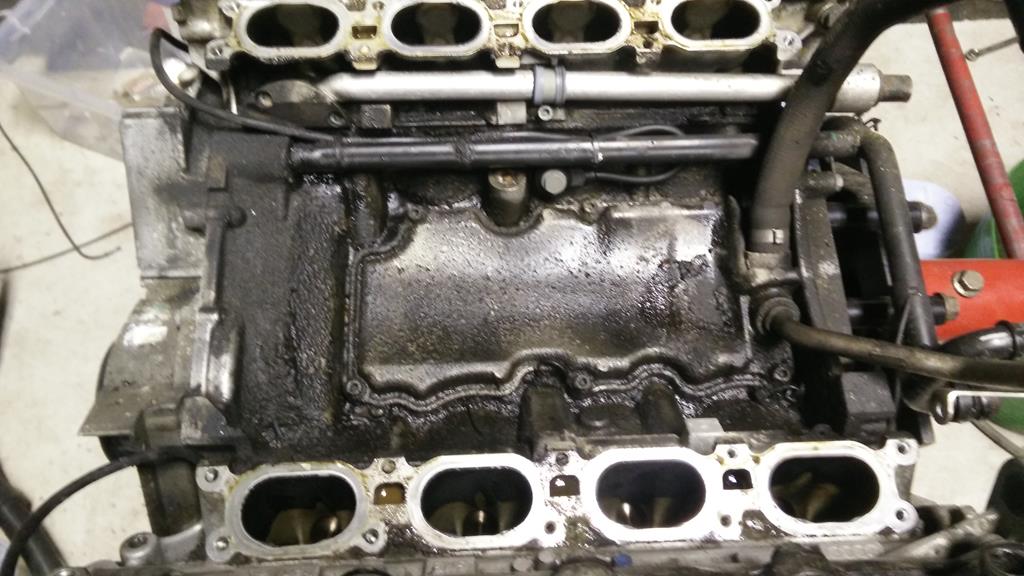

The knock sensor plug pigtail looks to be disintegrating.
I have only done a general visual inspection of everything I can see in the engine room while I have removed all the plastic covers.
But from what I understand looking through old threads where MJ shows photos and comments, it is something better left untouched?
I looked at one of your photos MJ, with the manifold removed. No way I can get to that.
By the way, I do not have two green knock sensors, but one green and one orange.
*I hope I use the correct words for the parts. I could find knock sensor cables in online shops, but not the plug pigtail*

I had both of my knock sensors replaced a while ago. One of the plugs had disintegrated just like yours so I suspect it's a common issue. From memory, the sensors weren't too expensive and came complete with new leads and plugs.
Old 30th June 2020, 02:39 PM
Yes, it is a common problem. Somehow Bosch managed to make the connectors from a plastic which doesn't survive the heat of an engine bay
You can't just replace the connector unfortunately. Its a screened cable which is very difficult to work with. The connector colour denotes the cable length by the way.
Tbh if taking the manifold off is not an option I would be inclined to go with Andrew's suggestion of an adhesive product to hold the connector together. Yes, it has a high risk of looking fairly awful, but thats really all you can do with the green one. The brown one is on the outside of the V though, behind the power steering pump, so that can be changed without too much difficulty.
Old 30th June 2020, 03:16 PM
Normal "domestic" Araldite is nominally only rated up to 65C, but would probably be OK. I'd probably risk it on my own car.
Better to find a 2-part epoxy adhesive rated for a higher temperature as the engine bay will normally be over 110C; there are loads available, Araldite themselves have a huge range.
Or look at UV-cured adhesives, again a wide choice. I've used Bondic which I think is OK up to 150C; it's also clear and easy to build up so can be tidy.
