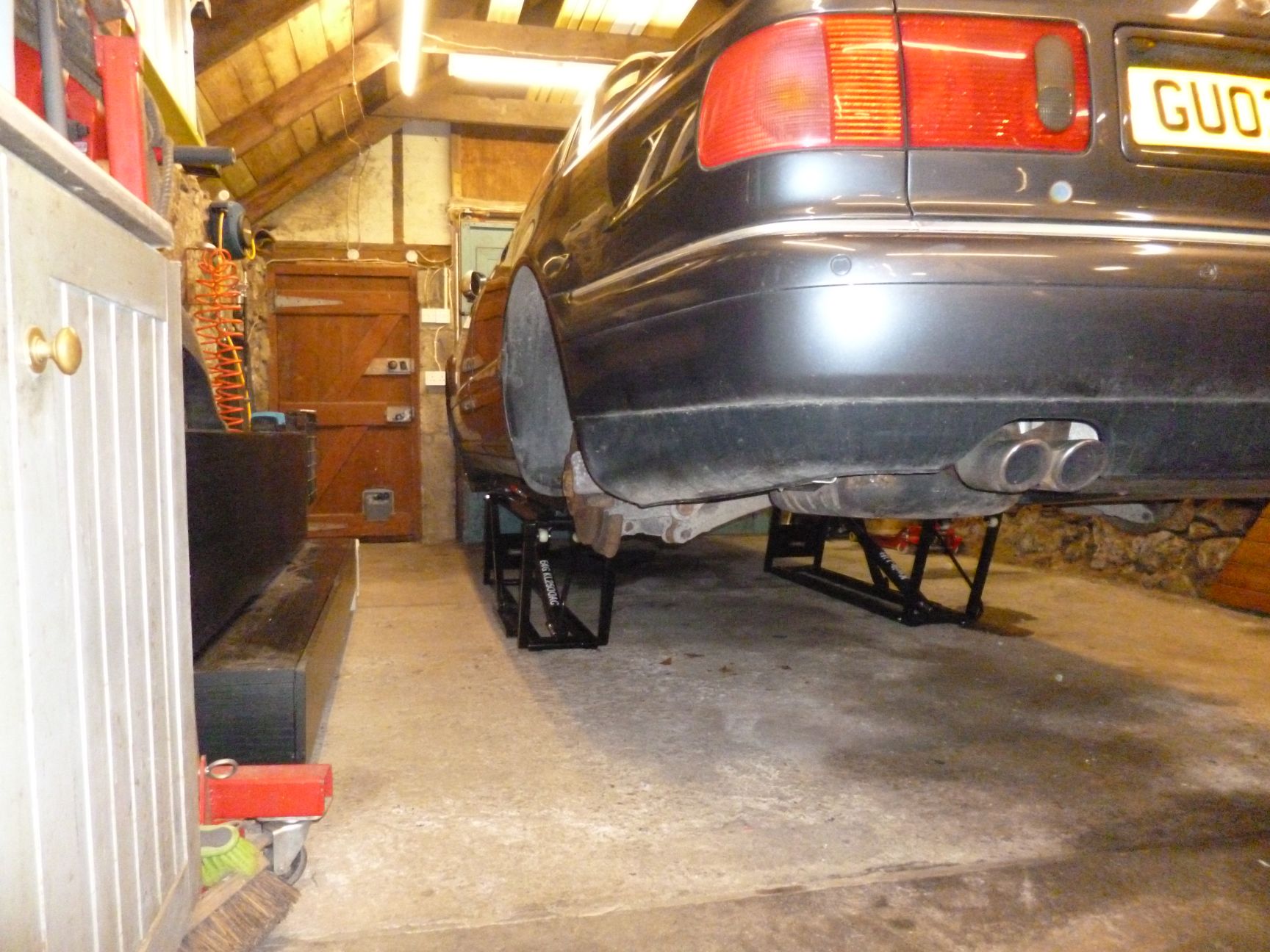

Just in case anybody has a similar scenario to this, I though I would add an update, as I came up with a solution that allowed me to use the Kwik-Lift with the S8.
The official extenders that you can buy with the lift are made of not particularly thick steel tubing, so it occurred to me that – given the S8 is only slightly longer than what the extenders allow – you could possibly make your own version from some thicker steel elements. So I sent a structural engineer (who I use for my work) some drawings and established that a simple 50x100x5 RHS would comfortably support the car, given the position of the lifting points on the lift.
And it does 😊
The car has been up on the lift for a couple of weeks now with no issue (I have been making regular checks on the steel sections), and the use of the 100mm wide steel makes it is very stable.
As I mentioned above, the supplier did confirm that the lift had been tested with an F150, which is longer (and heavier) than the S8 (but presumably with lifting points that are closer together!), so the balance should also be fine.
I did need to get some low-entry ramps too though, as the height of the lift plus the extra steel was higher than the lifting points of the car (as would have been the same for ‘official’ extenders). The low-entry ramps lift the car an extra 60mm which gives plenty of room.
All-in-all I am very happy and, having made a start on the rear suspension strip down on Saturday, it now makes the car a treat to work on.

Old 28th February 2022, 07:52 PM
Good solution. Well done
Old 1st March 2022, 10:04 AM
Is that a 205 lurking behind?!
