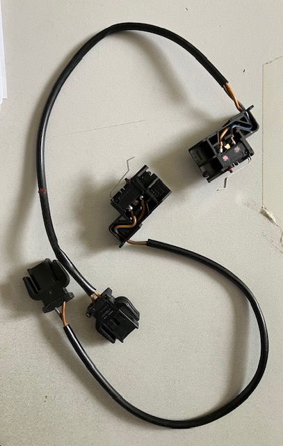

Has anyone here replaced the boot catch? It keeps showing the boot as open when it is very much closed! I've tried cleaning the connectors - think there must be a problem with the microswitch.
Is this a simple swap out?
Thanks
2002 S8 Aqua Pearl, entirely original apart from FE 20" OEM wheels and Milltek exhaust.
Old 3rd October 2023, 09:46 AM
Yup, done it more than once, pretty simple.
Can't recall the details now but IIRC you need to take the boot lid trim off, simple enough but a fair number of screws and bolts.
The microswitch can also be removed from the mechanical catch fairly easily; in my case it was usually a small plastic part of the catch mechanism that had actually failed. So I have a collection of spare microswitches......

In my experience (others may be different) it's a small plastic part in the body of the catch that fails. Due to the way it's constructed that can't be replaced, you need a replacement catch. Our sponsors should have one, give them a call, don't recall if they came with a microswitch when I bought them, but given I have two spares they probably do!
If you're sure it's the microswitch, I definitely have two on hand and am happy to post one FOC. You'll need to get the catch off the lid anyway to get at the switch and check it.

I donated one of those microswitches to Richard yesterday and showed him what needs to be undone to get the trim out of the way.
I think just replacing the switch (which he did later back home) has indeed fixed his problem.

It certainly has and a big thank you to HP for his generosity!
