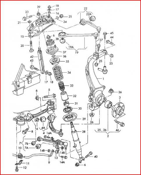

I bought my D2 cheap last week,and whilst driving it around have identified a weird issue that I would like to get sorted.
At slow speed on an uneven surface the front left sometimes makes the odd clonking sound. The driveway to the house I rent is a farm track of compressed mud and very uneven.
On a smooth road the car drives very smoothly, however on a bumpy road its almost like you need to constantly apply steering input to keep going in a straight line. Also if I run over a drain that has sunk in the road with the left wheel then the car almost seems to get pulled in that direction and require a small steering correction to keep straight.
I guess I maybe looking at worn bushes or simillar, so any thoughts out there.

There are 10 suspension arms in all and if one or two are worn then it could well be a good idea to replace the whole set. Its most likely to be item 7 on this diagram. I replaced my whole set a few months ago and noticed a huge difference in how the steering felt and now all feels tight and more responsive

With regards to the steering tug this is more than likely just down to the width of the tyres on these cars. Wider tyres do tend to cause tramlining more than thinner.
Clonking would normally be something worn. Best to get it off the ground and have a good ole tug about. I bet a garage wouldn't charge too much to do it for you. Perhaps even beer tokens.
My last car, celica wrc, had multilink suspension and was a nightmare for that. Replacing the whole setup on there, which are heavy steel items too, costs over a grand. Good ole Audi...at least replacement on these cars is quite reasonable.
I'm going to be replacing all my arms shortly as Audi have replaced a couple of the top arms in the recent past so the rest can't be far behind.
I'm going to take a good ole look at the old arms once off as I've always done poly conversions on my old cars and that really firms things up nicely. Ill also look at the ball joints and if there is a method to replace them as an el-cheapo set off ebay converted to poly with better ball joints would make some rather nice arms.

Sounds like arms to me, jack up the front and wiggle the wheel you'll see movement if they are worn. Don't use the jack from the boot!
I have replaced all mine bar 1 that i couldn't get the nut off trying to stop a rattling, that turned out to be a caliper.
If you want to save a few quid, it's an easy job and is doable on the drive with minimal tools, you will need an 18mm socket and many sets do not have one so check first.
There is a very good how to on audipages, there is a bolt that you'll need to cut out so buy a pair of new bolts before you start stripping.
Sets of arms are available from ebay too if you want to save even more (like i did ) but better quaility arms are available.
