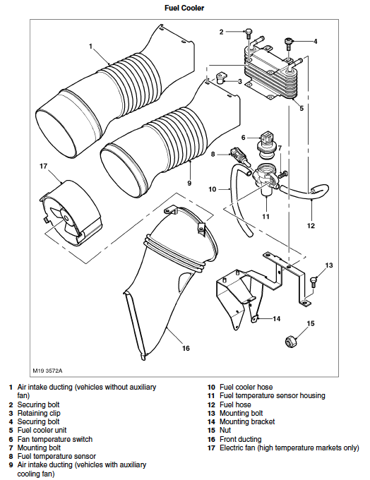

Old 11th January 2013, 08:04 AM
Diesel engines sometimes have a cooler built into the fuel system I wonder if something similar could be rigged up for your car.
I've attached a Range Rover diesel fuel cooling system to give you an idea
Name:	Diesel fuel cooler.png
