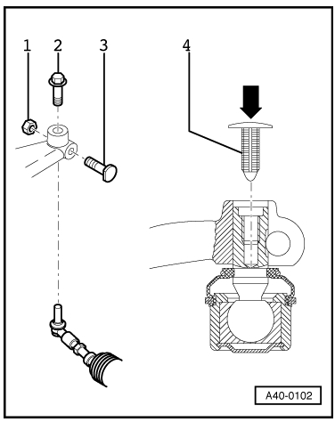

I have attached 2 pdf's about constant S.
If you check the picture bolt 2 is adjustment bolt for constant s, garages most of the time fully tighten this bolt assuming that it is securing bolt causing constant s to be out. Normally this bolt is supposed to come out after adjustment and plastic protective cap to go in it's place. I have never seen it in practice and there is nothing wrong with leaving bolt in place as it's covered with thread lock and will not come out, it's just that it should not be fully tightened.

Thanks for the upload but i find it makes no sense tbh. I cant see why bolt 2 needs to be touched for toe adjustment and find Audi's workshop procedure (as is sometimes the case) for something simple very convoluted, but perhaps i am completely missing something!

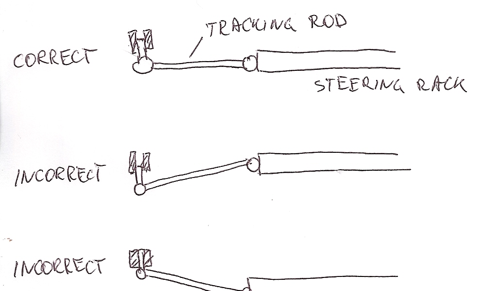

You do TOE adjustment the usual way with track rod ends, after that you do constant S adjustment using bolt 2 to make sure TOE changes as it should when suspension goes up and down, then recheck normal TOE. If it's not done correctly TOE will be correct when car is stationary but could be wrong when car is loaded or when going over bumps and suspension travels up and down.

I made a quick picture to show the idea. I have of course exaggerated the angles to better show the idea.
Top picture shows the correct way, middle if the bolt 2 is tightened too little and bottom if it is tightened too much. In either of these cases you can adjust TOE to specifications while car is stationary and unloaded but when driving and suspension travels up and down it will change incorrectly.
