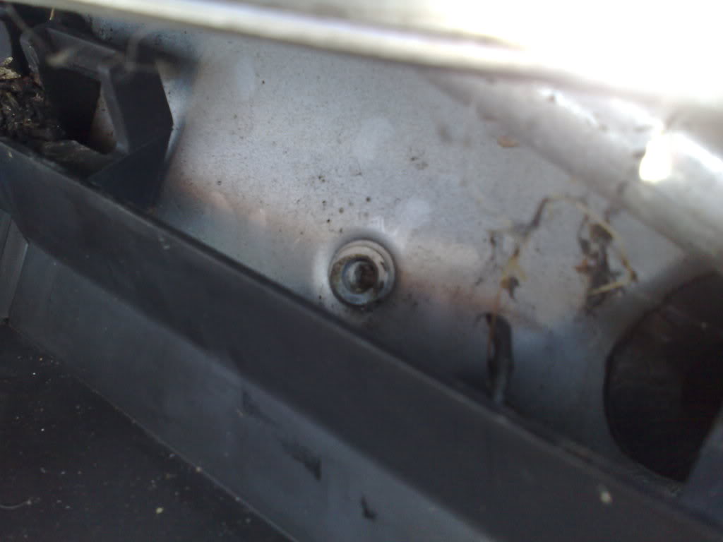

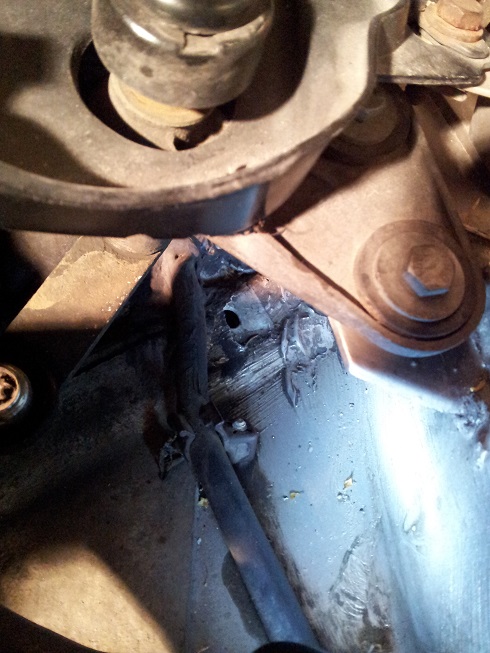

I have had water in the cab a few times in the past, cleared drains ect but always had trouble finding Botang's. I've had the ecu's out but could never get the box out. Anyhoo i've had a go this wk-end and think i've found it, but still not 100%
Now i know that 1 is left and the other right hand drive but, This is from Notorious and the hole is just a hole.
This is from Davisbike and is a captive thread, the same as i found.

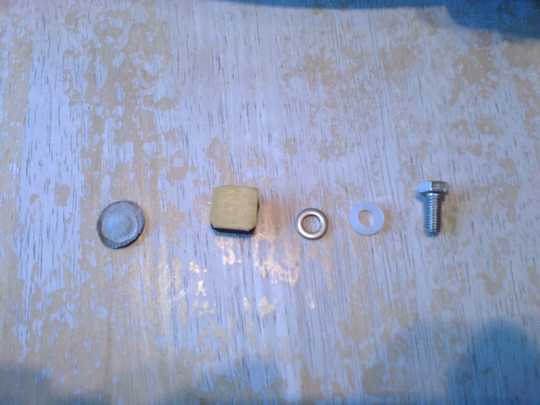

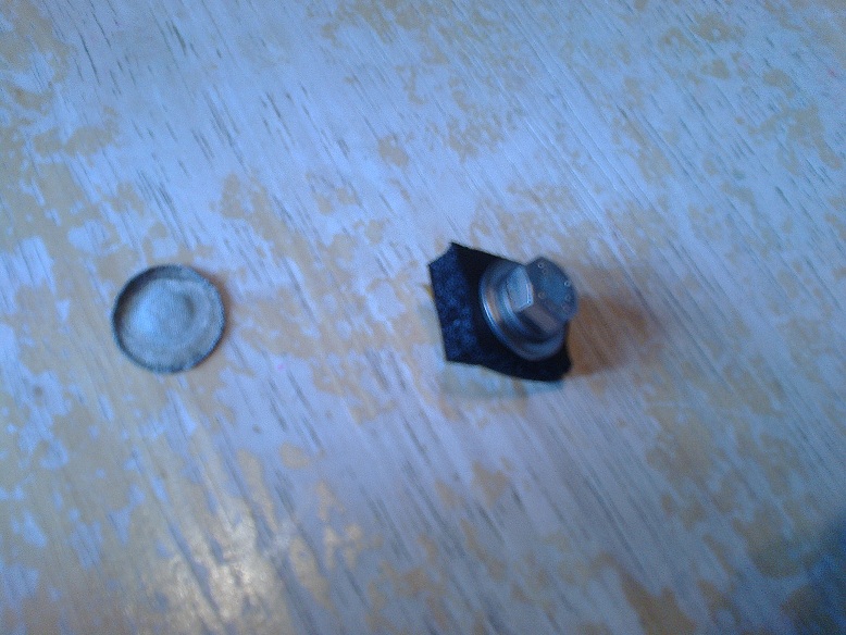

So off i went to my shed to see what i could find. Tapped hole is an M6 so a stainless bolt, washer x2 and some single sided foam tape.
But in the end i dropped the plastic washer for a larger stainless to spread more weight over the foam
The foam is water tight at 3/4 compression so i just done it up handtight with a socket, extention and wobbler.

I don't think that threaded hole you've blocked is Botang's, pretty sure BH is lower down where water can easily pool and just a hole covered in some thin paper-like material.
Is your car LHD or RHD and roughly what did you have to do to get access to that?

Car is RHD, you see in photo 3 and 4 the little round bit of tape, that was stuck over the hole.
Old 17th February 2014, 08:33 AM
I'm pretty sure that the first picture is the one that I've seen referred to as Botangs Hole, below outboard edge of the ECU box I think on RHD.
Did you have to pull the ECU box forwards to find and access Dezzys Hole? Or is it "just" taking off the cover across the base of the windscreen?
(Might investigate mine if its the latter and we ever get a fine day)
