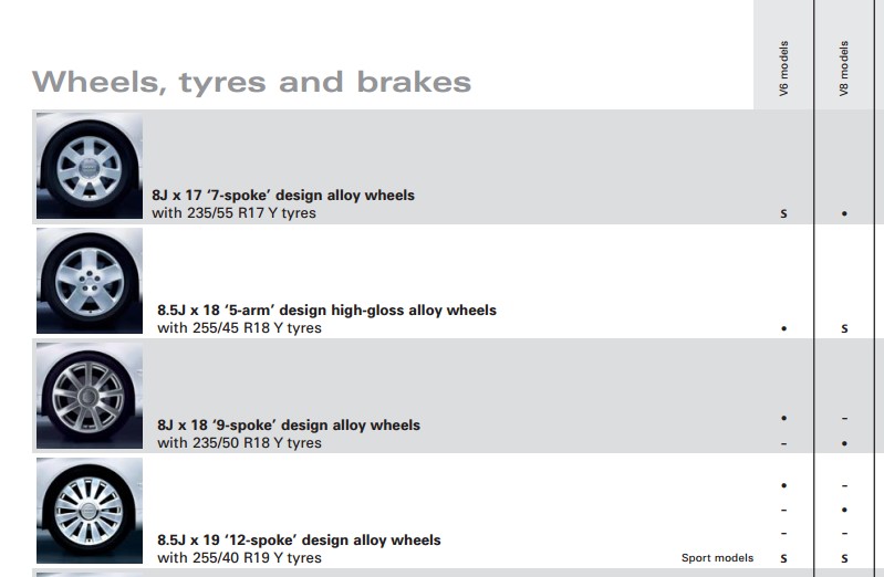

235/50/18 was a standard tyre size too, but it was indeed on 8J rim, not 7J.

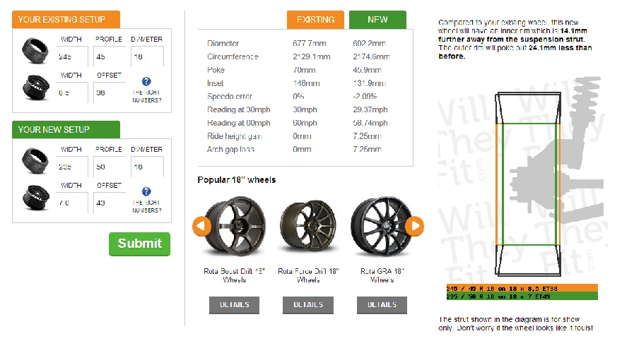

it depends on what size your existing wheels are how much the difference would be but as an example vs a standard 18" QS wheel -
As you can see the only difference would be the thin-ness of the wheel meaning that to get the wheel to line up with where you want it on the face you may have to fit spacers. . .
