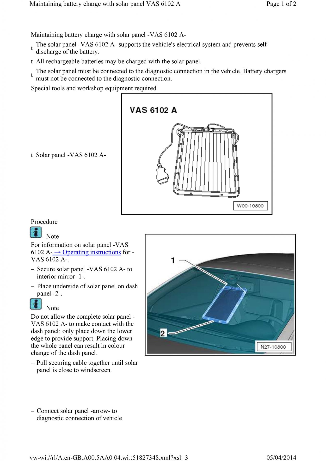

Default ODB Solar Charger
Looking at something completely different on ELSA I came across the ODB Solar charge from Audi.
Anyone seen it before?
Thought I'd share it.

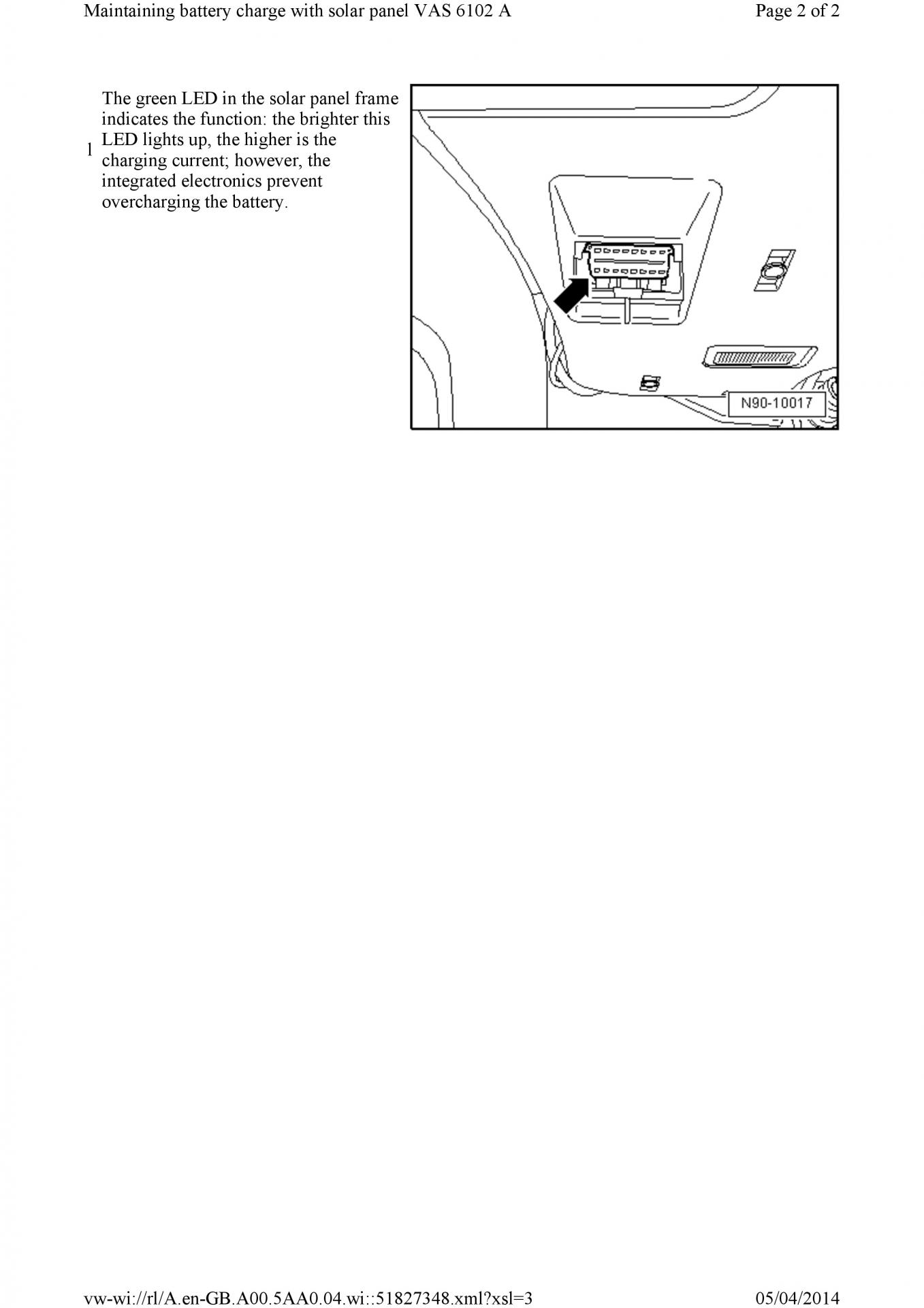

Thought the JPG would be easier than a XPS.

Detail here:
http://vw.snapon.com/SpecialToolsDet...temid=41590028
The same device from original manufacturer -- Sickert & Hafner:
http://www.sickert-hafner.de/PDF_e/F...r%20ASM600.pdf
This is why I want to install switch for my solar sunroof (33.6W) to toggle between blower mode and trickle charger mode.

Would be good to know how much.. If not too much, then worth it for the couple of weeks of holiday without the car being driven, just to be on the safe side.
Old 6th April 2014, 11:09 AM
Excellent device! thanks for posting.
Definitely extremely useful, especially because lead-acid batteries dont like being discharged below 50%, they start to sulphate.
My battery has spent a lot of time below 50% charge, below 12.5V, and it has sulphated badly. I estimate I have around 30% capacity left, and fully charged voltage of 12.4~12.3V
