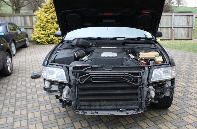

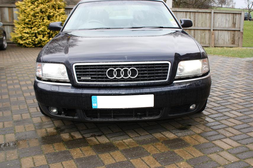

and here is my car. The bumper is off from earlier frolics I've had with the starter motor, and to be honest as its 2 bolts, 1 electrical connector and 1 headlampwash pipe I'd be tempted to remove it as it does make it easier as things progress.....

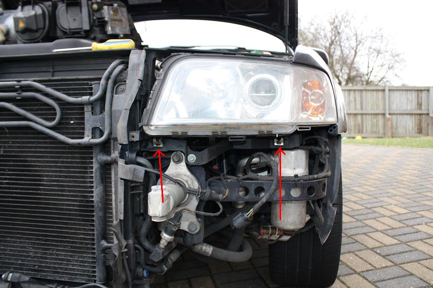

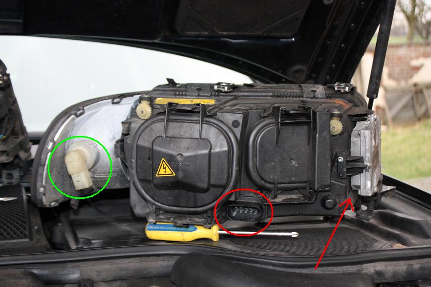

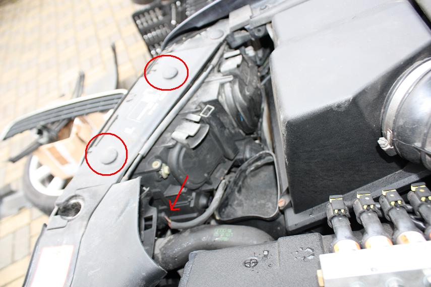

So, first we need to remove the lights... There are 2 crosshead screws at the top of each headlight under these black covers. Pop the covers off with a flatblade, then undo the crosshead screws. If you have regular xenons, note the extra cable as indicated by the arrow - This makes more sense in a short while:

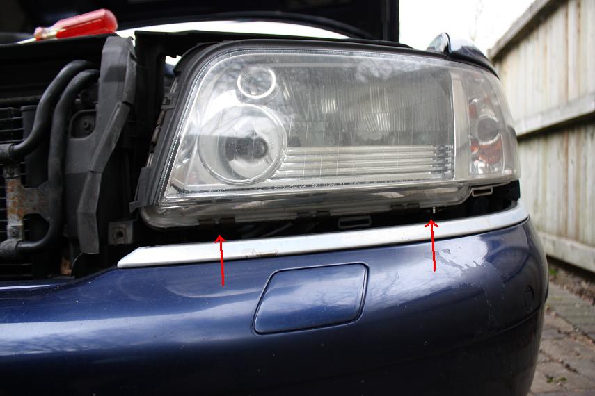

and here we have the donor car with Xenon plus - Note, no extra cable, instead we have a silver box bolted to the side of the headlight unit:
and there are two crosshead screws under here too. They are a real bitch to get to if the bumper is on, and putting them back with the bumper on is nearly impossible... If you have an undertray, be prepared to go fishing for the screws plenty of times during this procedure...
And here on my car with the bumper removed, a bit easier to see:
Once all 4 screws are removed, you can disconnect the main 10 pin black wiring block, the seperate indicator connector and on the regular xenons, the 4 way connector on the side, then the headlight will come out. It will come out with the bumper in place with some careful wiggling, but again bumper off is way easier...

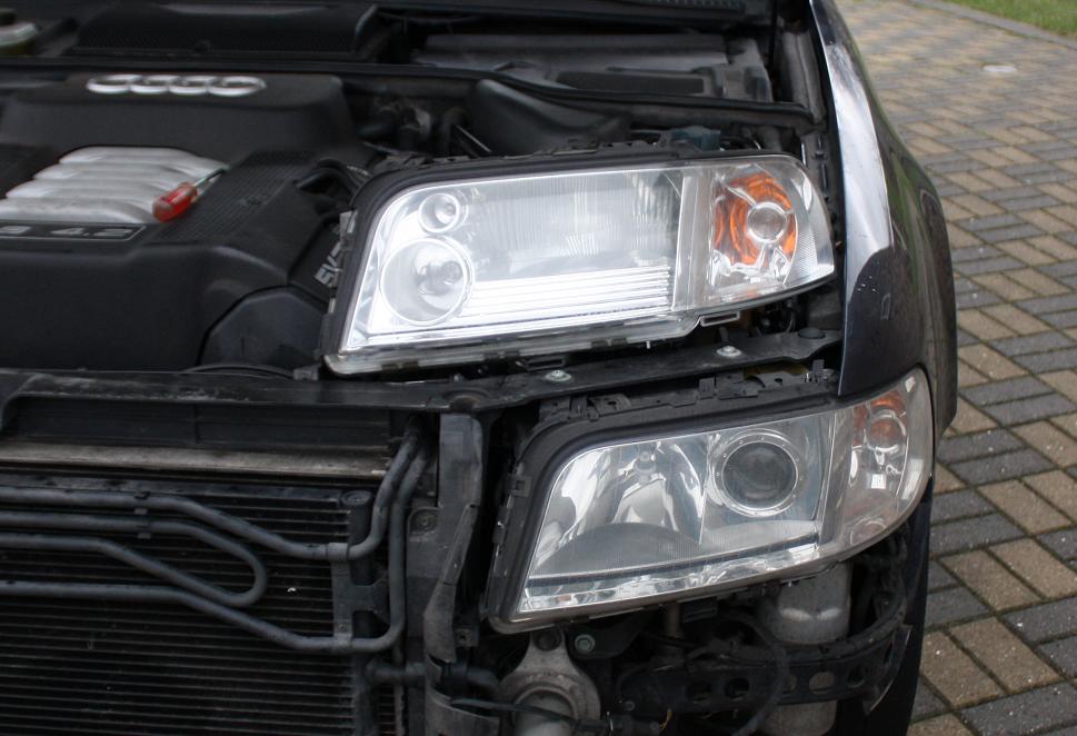

Now for the fun stuff, here is a photo of the new xenon plus light directly above my existing xenon light.... the difference in appearance is quite obvious really....

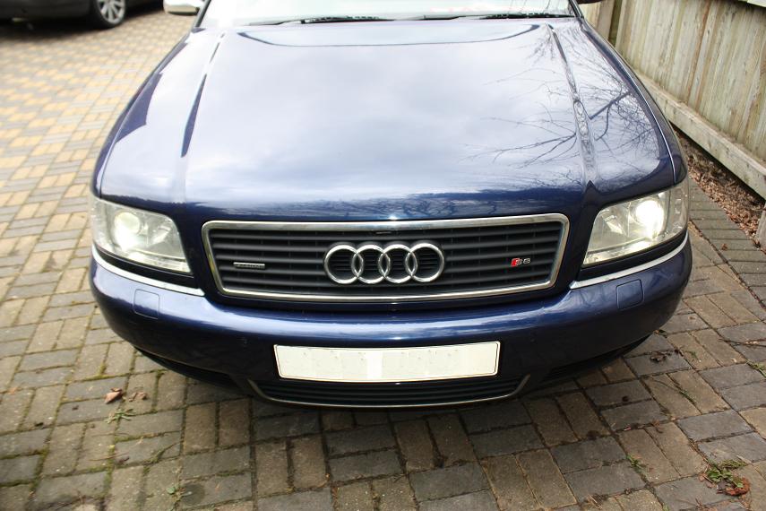

So, theory is all good, but lets test it, so in goes the left hand side xenon plus and I connect the 10 pin connector and indicator. The xenon plus ignitor is self contained, so I leave the old 4 pin connector dangling for a moment....
and, headlights on:

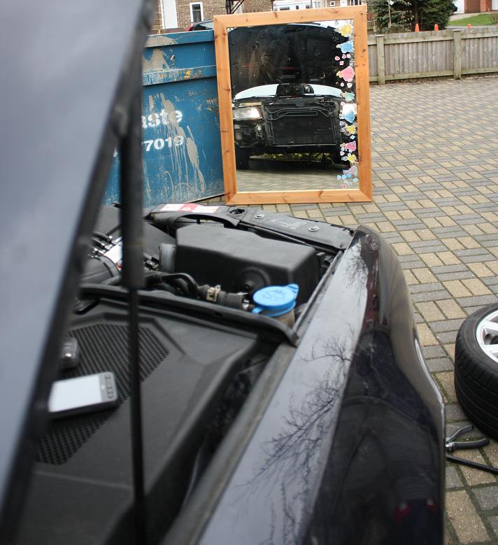

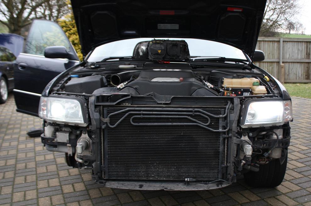

hurrah.... - but - i still need to test the main beam and flash as this was the part that concerned me most, so I steal the mirror out of the dining room and pop it in front of the car so I can pull the stalk AND see the result...
so thats conclusive..... it works

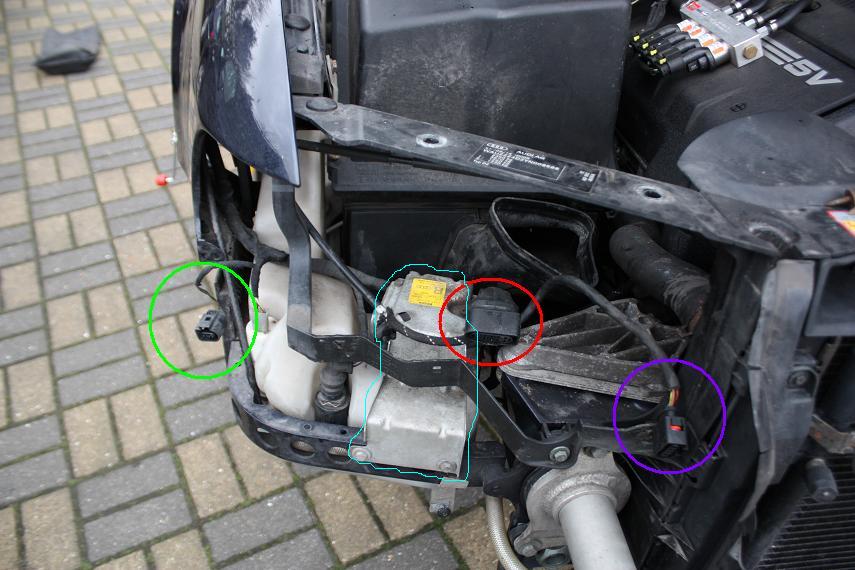

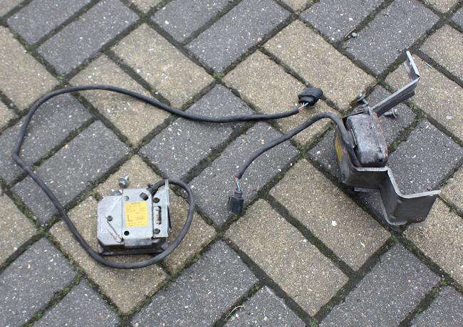

I need to remove the old xenons completely including the ignitor kit as I need to put the whole lot into the donor car. If you are not under this pressure then there is no real harm in securing the 4 pin connector somewhere and just leaving them there.... The ignitor for the drivers side is highlighted with the rather shaky outline I just did and is bolted in with 3 x 10mm head bolts. one bolt though is under the air box, so you'll need to pop that out to remove the bracket. The purple circle highlights the 4 pin wire that goes to that ignitor, the red circle is the main 10 pin connector and the green circle is the indicator connection:

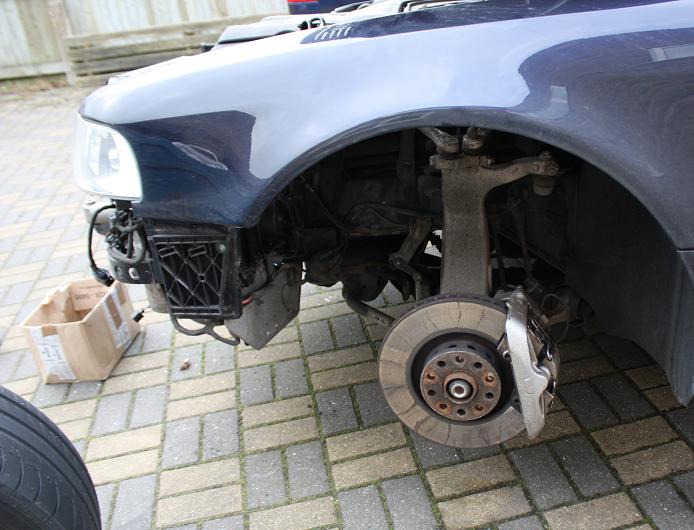

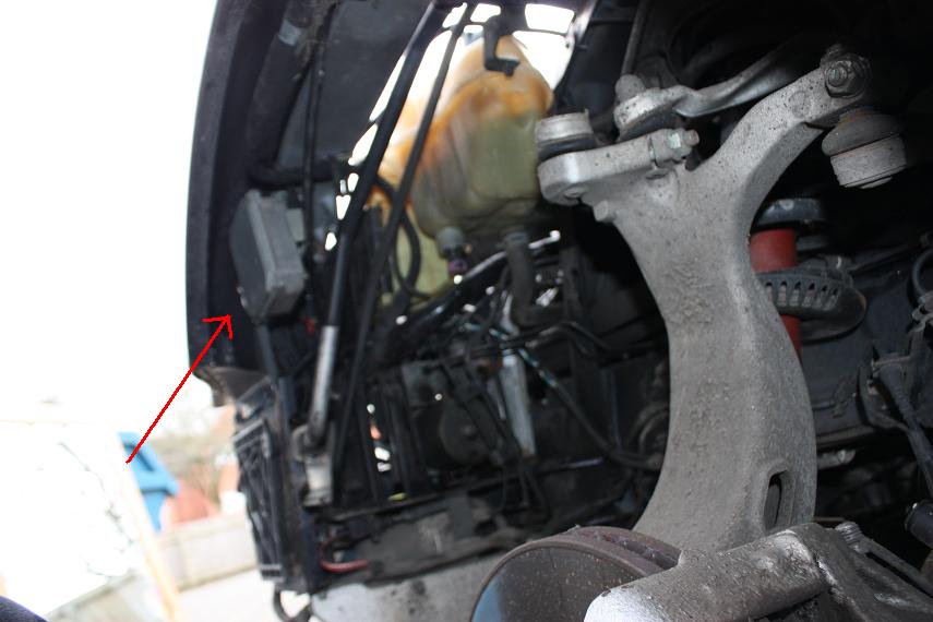

Removing the ignitor from the other side is a bit more tricky as it is hidden under the wing. The only real way to get to it is to remove the wheel and the front half of the wheel arch liner:
Once thats removed, you can see the silver box hanging on the left here, bolted in with 2 x 10mm head bolts again:
Undo a few cable ties and it comes out easy enough, then you have a pair ready for refit (or selling!)
