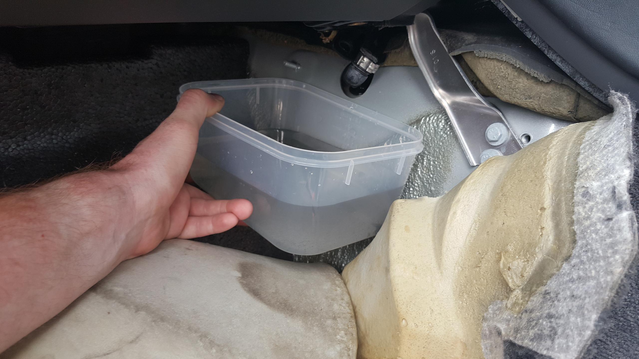

Spot on info!! The inners had 3/4of a litre of water sitting there and silt!
I presume they are linked somewhere as only a little bit came out of the driver side.

I had the same problem earlier this year.
But i felt that the carpet was wet so i removed all of the carpets and let them dry out in the sun for a whole day.
Now they are dry
Only thing I'm worried about is the plenum drains which i can't allocate and check.
Anyone have any tips and tricks to check/clean them?
Regards
Kenneth

Thanks A LOT Now I only need a ramp
