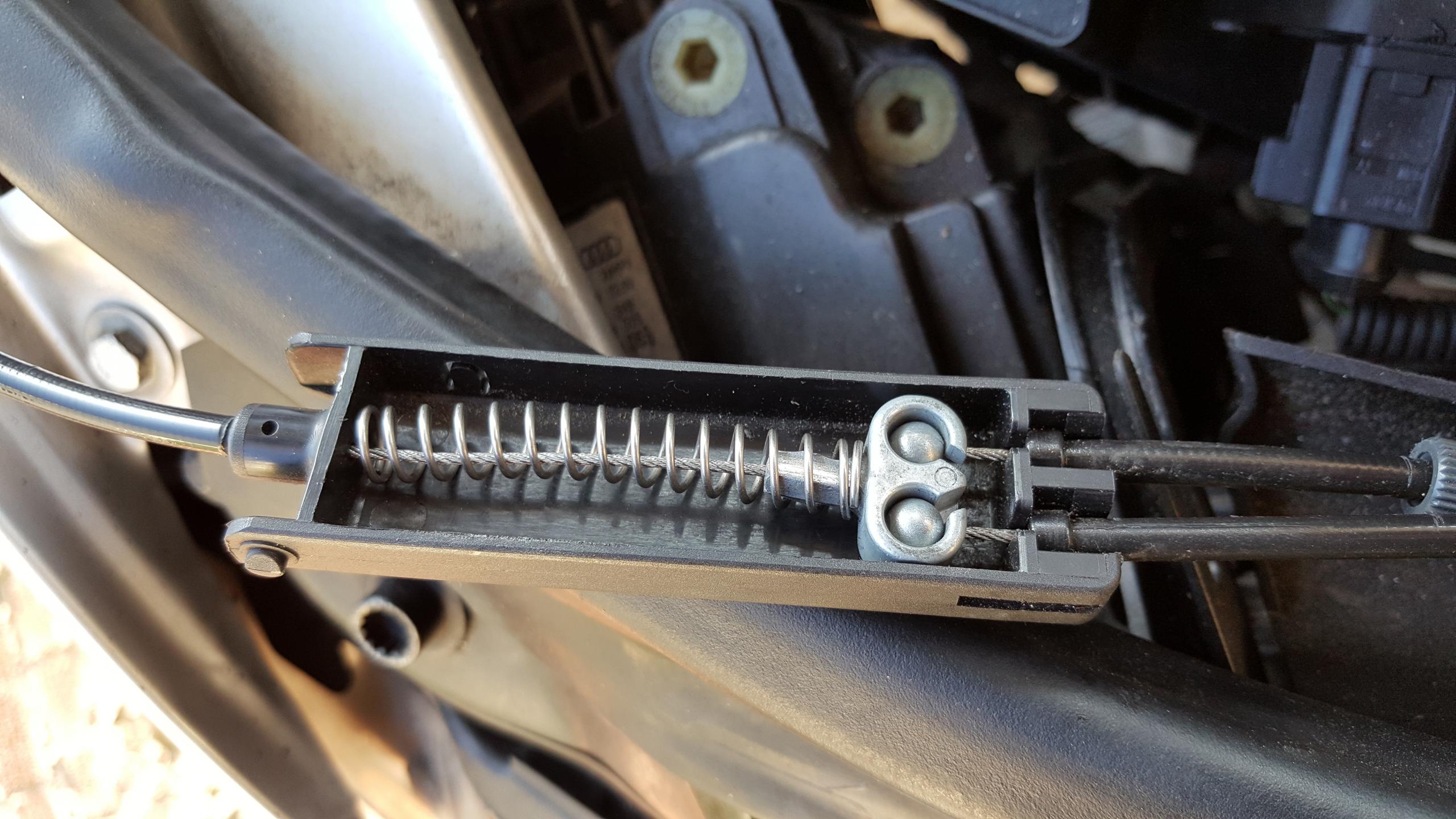

Ignore the bonnet puller spliter. See the 2 white allen head plastic things in the background. They are the manual adjusters on the driverside.
