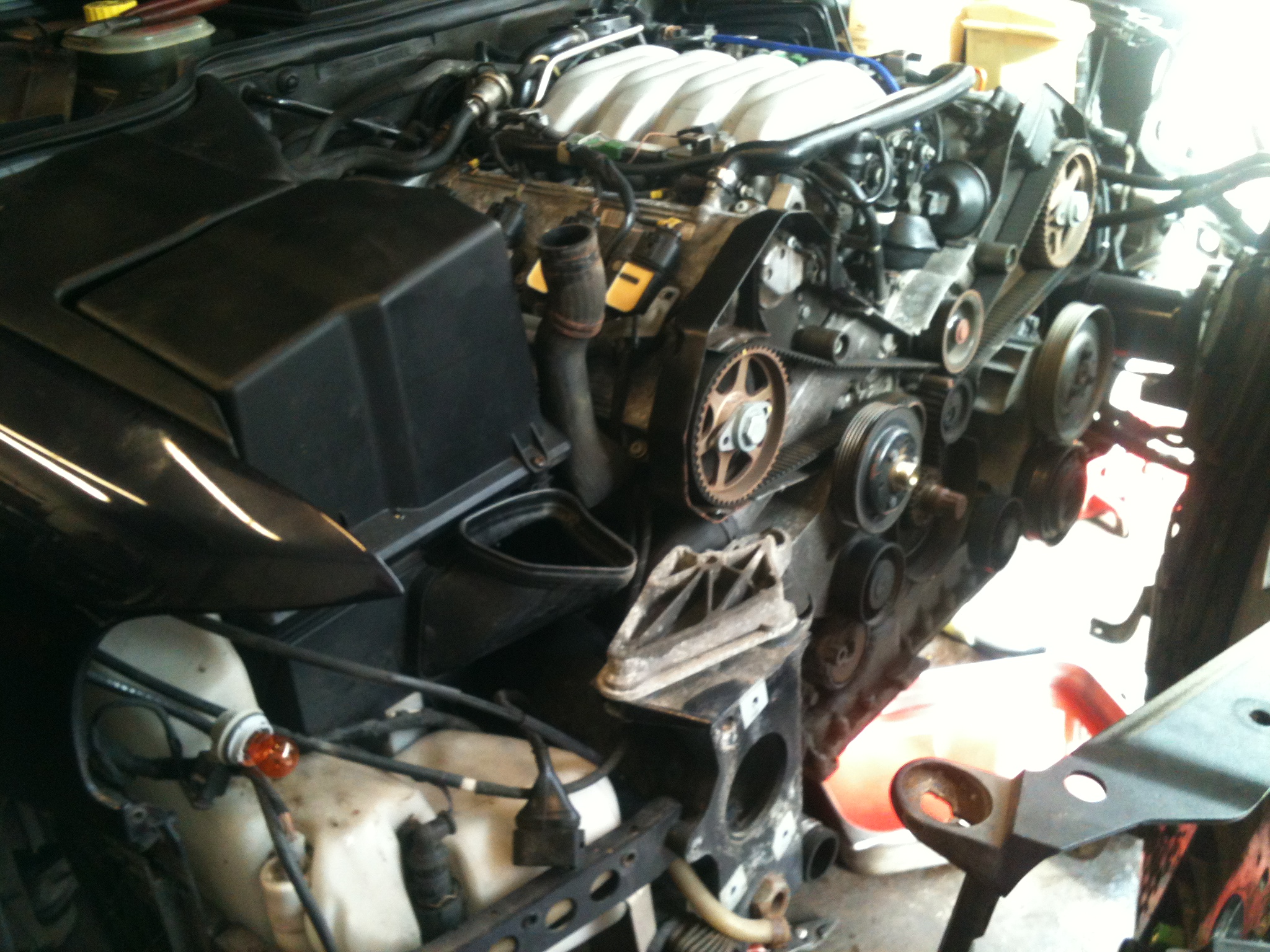

Old 18th August 2016, 09:23 PM
Will this help?

Old 18th August 2016, 09:37 PM
RICKY D's Avatar
RICKY D RICKY D is offline
Posts: 786
Doesn't look like the serpentine belt is on in the pic?
Old 18th August 2016, 09:47 PM
Ah sorry, I missed the point of your request!
