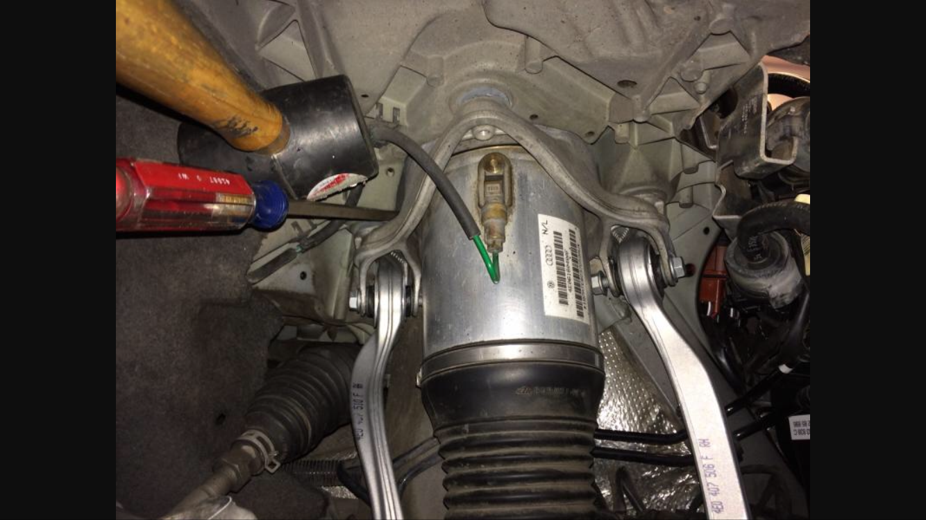

The description is vague and it may be worth a call back to the test centre before getting any work done.
It's likely the rearmost bushing in the photo on the front, both driver and passenger sides from the refusal script.
When I ran a D3 from 60K miles to 200K+ miles, I had the front lower arms replaced twice, front drop links 3 times and the ARB once. The front upper arms and rear suspension were never touched. The car passed several NCT tests down here without issue.

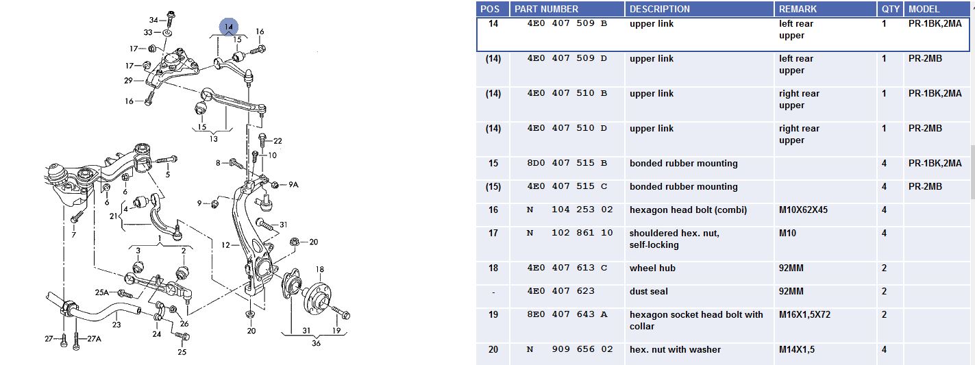

These are the arms you need, from chassis 4E-4-012701 onwards:
Not sure which of the two versions you need as I'm not that familiar with the D3, but the PR codes are on the sticker in the boot or usually in the front inside cover of the service book.
