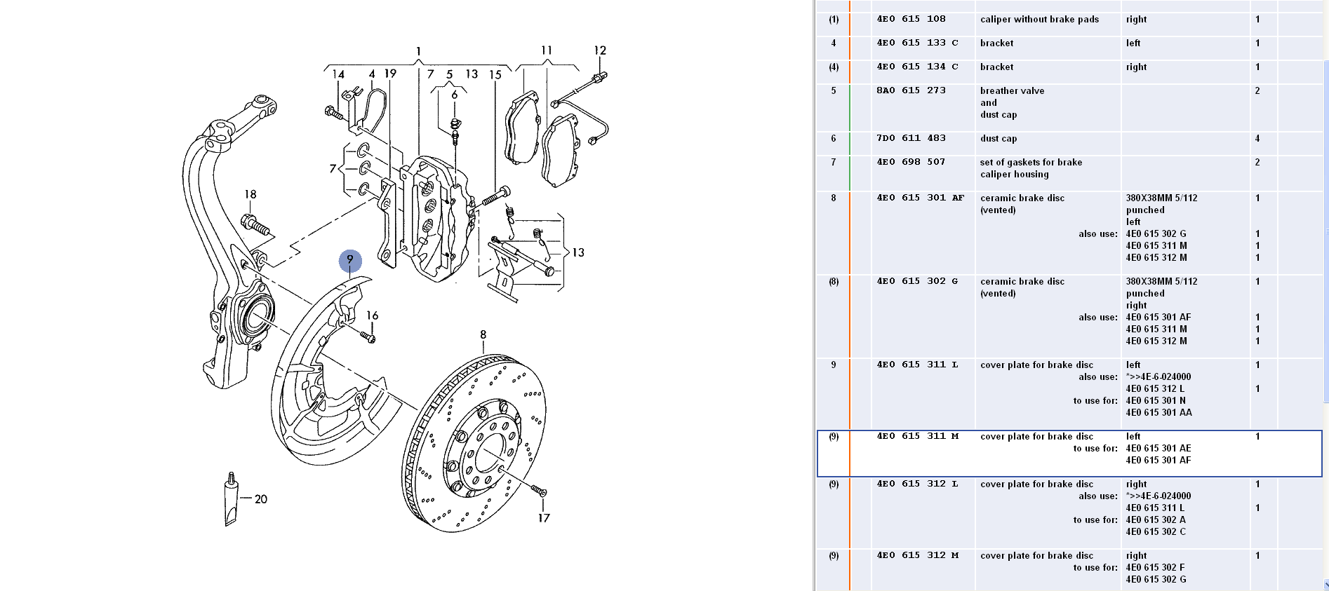

I noticed the same thing on cars at the German meet and the only thing I could conclude was that they had been fitted back to front.

Old 21st February 2018, 09:03 AM
Posts: 1,669
I don't know, but looks like one SKU covers left and right - so it will be as you say curving over one side and away on the other.
