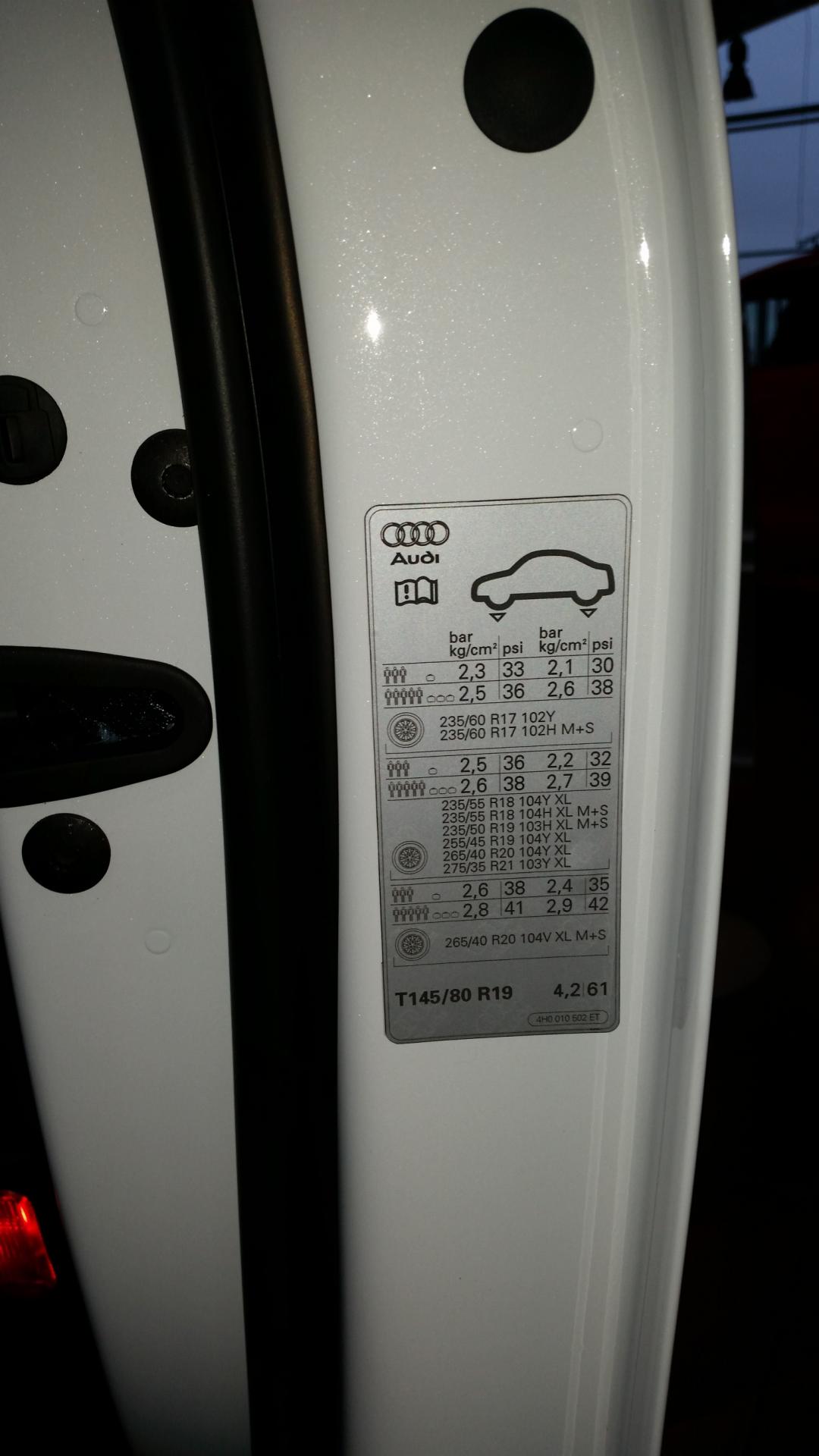

36-38 front, 32-39 rear......
I should have mentioned, this picture is of the OEM pressures sticker from a 2015 D4, which shows the recommended pressures for this size of tyre.....
It also has a part number, should you want to order one for your own door

Thanks for taking the time to reply guys...I’ve learned a lot.
And I’ve ordered a new door sticker from Audi for the bargain price of £4.57.
