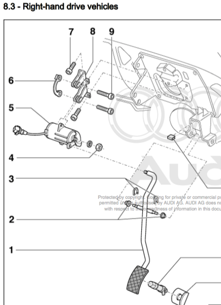

I looked in my manual, and it seems to be a correct reading (if I understand the manual)
Servicing accelerator linkage - vehicles with electronic throttle system (electronic power control)
5 Acceleration position sender -G79
RHD vehicles
Requirement for test: Accelerator pedal stop installed (combined with kick down switch for vehicles with automatic gearbox)
01 - Engine electronics
select diagnosis function “08 - Read data block” from the menu.
enter “062” to select Display group 062 and confirm entry.
Check display in display zone 3 (accelerator pedal position).
Vehicles with automatic gearbox
Press the accelerator all the way down (past kick down point)
Specification: 70 … 74% (accelerator pedal pressed down past kick down point)
Exit from function “08 - Read data block”
Select diagnosis function “06 - End output”.

Thank you, alltought I see that this is for right hand drive and electronic throttle. I have lhd and cable throttle.
But maybe it is correct that it will not show 100% when fully pressed. Still kinda strange that vagcom shows only part throttle and not full throttle when fully pressed.

Oh sorry, I just assumed you had a RHD, that's why I posted that
