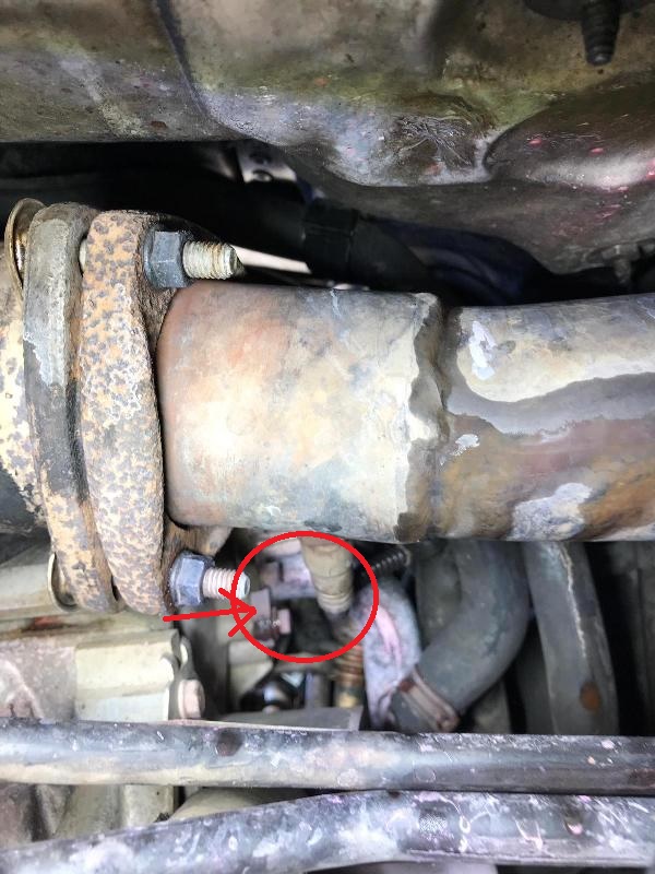

Well got the old girl up on the ramps to wonder where the leak was from.
Could see it running and dripping off the exhaust pipe and followed it up to the engine bay.
Then found this:
The hose above has perished and split so the coolant is coming from the black rubber pipe above the exhaust and its the one on the left.
Yep, that's not a 10 minute job though need to look at ETKA to work out which one it is.

Old 24th August 2019, 11:15 AM
None of the hoses are available in the UK any more. Used or a German contact to buy from Tradition (which we have) are the only options.
Are you sure its a rubber hose though? That pic looks to me like its the metal pipe joining the two heads together. That is sealed to the head with an o-ring which frequently perishes and disintegrates.
If it is the o-ring thats a mixed blassing - it's still available, but its a hell of a job to change it, plus you'll need a bunch of other gaskets and seals for everything else that has to come off (inlet manifold etc).

Its definitely the hose that's the main problem as I could see it cracked and coolant leaking when I looked but could not get the phone to it for the perfect picture.
The coolant went everywhere when it let go hence its rather pink all over the place!
Though I could well see the metal pipe joint on its way out to.
I think first attempt will be get hold of the lower coolant hose as it looks to be from the bottom of the expansion tank down to just above the exhaust which may be doable with some swearing.

I would not wish this job on anyone!
Its in one of the hardest places to get too right at the back of the engine and my god its taken some doing this afternoon. It was not the lower expansion hose in the end as I thought but the pipe next door to it which is a heating hose 4D2819371B.
Gave it a pull and it tore in two parts easily!
You can see from this photo it was not in the best of condition after 17 years of use!
On the bench and now in two parts!
Joy of joys and arms do not look good after that and quite cut up! Right time to order one of those and then the fun of fitting it, I wish I was closer to Devon.
30 second job I suspect if the engine was outside of the car
2001 Audi A2 1.4 SE - Jaipur Red Pearl

Ooh not fun at all! Look on the bright side though - still orders of magnitude easier than doing the metal cross pipe
