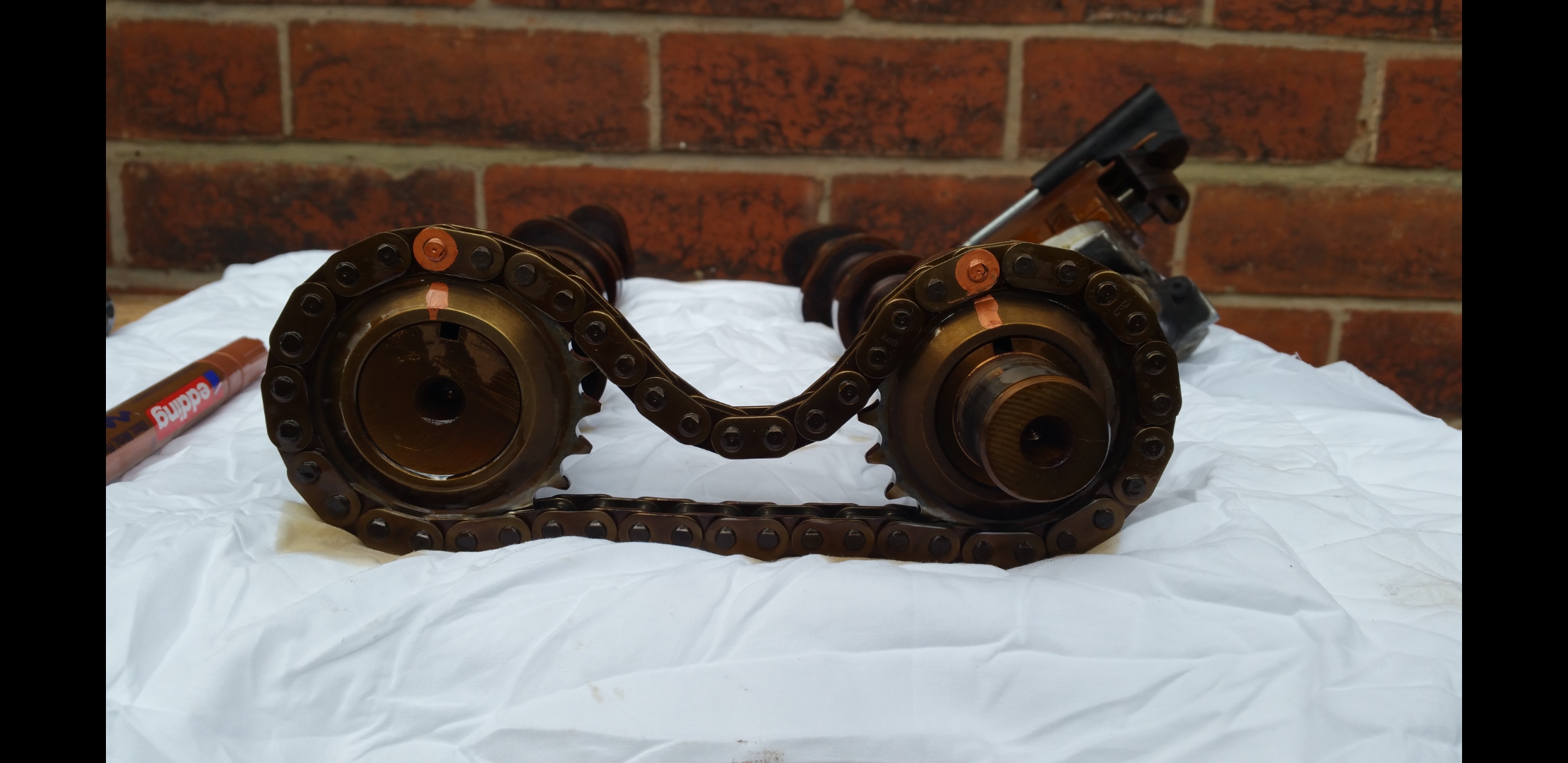

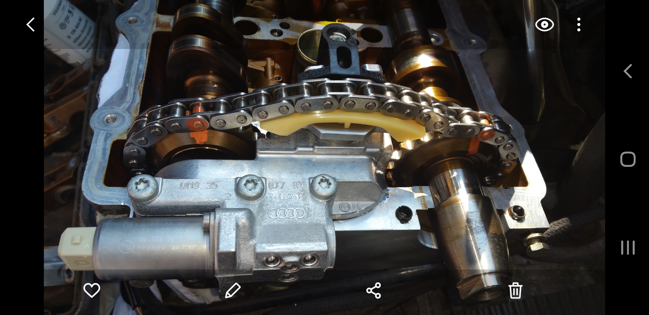

Be careful to mark up the cams and chain positions. If you are going to replace the chains I think you will have to completely remove both cams. I did anyhow. It makes reassembly less stressful.
There is a procedure for counting the number of links in the Bentley manual but I found it a little confusing. I found this way easier and as I say, less stressful because you know it will be as it was when it goes back. Simply lay the old and new chains side by side and replicate the marks.
