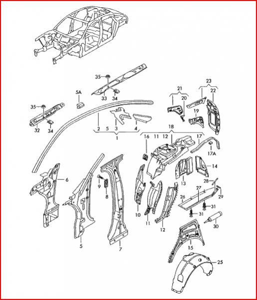

Old 20th December 2011, 08:19 PM
do these help Glyn? not sure what model you have!
Name:	D3 arch liner.jpg
ID:	2602   Click image for larger version
Name:	D3 Side & Rear.jpg

I think I will have to remove the arch inner guard and see what's holding the sill corner in/on
