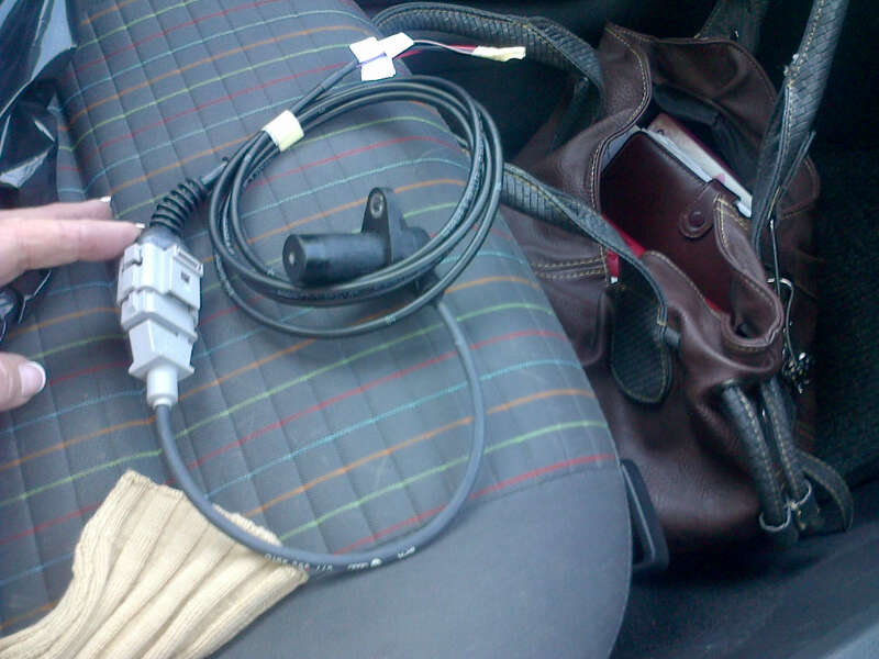

ok i got my crank sensor after waiting for 10 days for the stealers as A8 parts didnt have stock.and i get this now. so i am bit confused do i have to cut the existing cable and solder this onto it ? any help will be appreciated alot.

ok figured it out. i had to solder the new harness into the old one. so if this will help anyone else Audi had tagged each wire on the new harness pin 1black, 2red, 3purple. but when i wired it up like that it was incorrect and the car wouldn't start so i took a guess and wired it up like this.new harness 1purple 2red 3black.cars harness:1black 2blue 3grey. all is working now.
