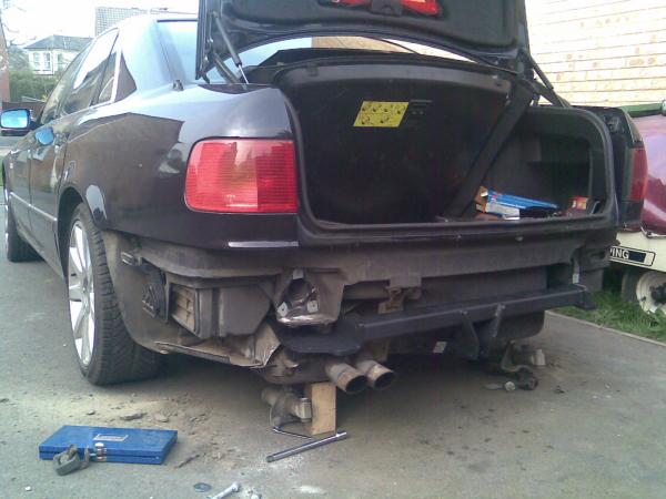

If you still have the plastics on the under side drop them at the rear, bumper is held on by 2 off socket cheese headed bolts that run through the impact pistons.
See the pic below, you can see where the impact piston goes where the 3 holes are, piston is on the floor under car and the bolts that hold bumper to piston you can just see in the bottom of the pic.
Name:	towbar fitting.jpg
