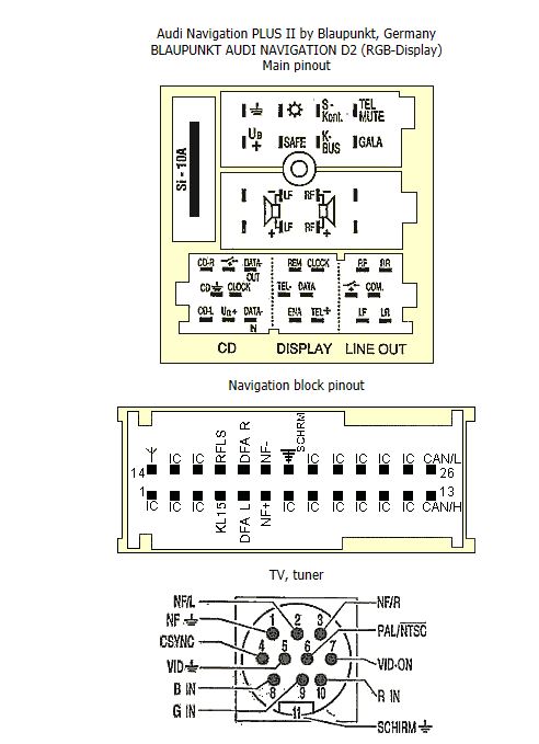

What did you have before, an RNS-D with Bose?
If so, see the attached connector diagram; Bose would use the 4-channel Line Out connector which includes an "amp on" signal (not sure what it is though).
Note that the 20-pin connector covering CD/Display/LineOut comes in 2 versions. One is a single block, the other is splittable and typically blue/green/yellow.

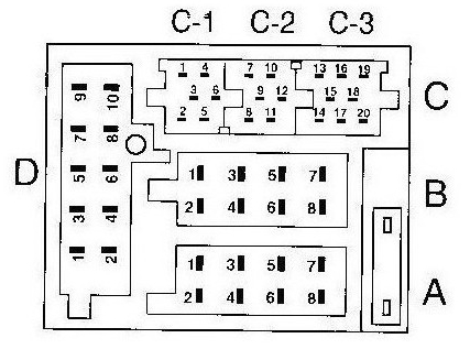

With Bose all speakers are driven form Bose amp, none directly from radio.
Connector C is actually three separate connectors dovetailed together. It may not be present at all - sometimes, only parts of it are present. It usually comes attached to the device it supports:
C1 - external amplifier or equaliser
Pin 1 - Line out left rear
Pin 2 - Line out right rear
Pin 3 - Line out ground
Pin 4 - Line out front left
Pin 5 - Line out front right
Pin 4 - +12v switched - maximum 150mA
C2 - remote control
Pin 7 - RXD
Pin 8 - TXD
Pin 9 - Chassis ground
Pin 10 - +12v switched - maximum 150mA
Pin 11 - Remote control in
Pin 12 - Remote control ground
C3 - CD changer
Pin 13 - CDC data in (bus)
Pin 14 - CDC data out
Pin 15 - CDC +12v permanent
Pin 16 - CDC +12v switched - maximum 300mA (+A)
Pin 17 - CDC data ground (+U)
Pin 18 - CDC audio frequency ground
Pin 19 - CDC audio frequency left
Pin 20 - CDC audio frequency right
Look at the connector C, looks like you got adapter kit for non Bose cars which only connects line-out for rear speakers and assumes front speakers will be driven directly from unit. You will need adapter kit specifically for Bose for all 4 outputs which connects all pins in C1.
You will probably need a kit that takes signal from speaker level output and connetcs it through resistors to amp as most aftermarket radios use 1.5V line-out but audi system 3.5V so if you run it from line-out it will be very quite.
Looks like this one should do the trick: http://www.ebay.co.uk/itm/Radio-Adap...item19e3871780

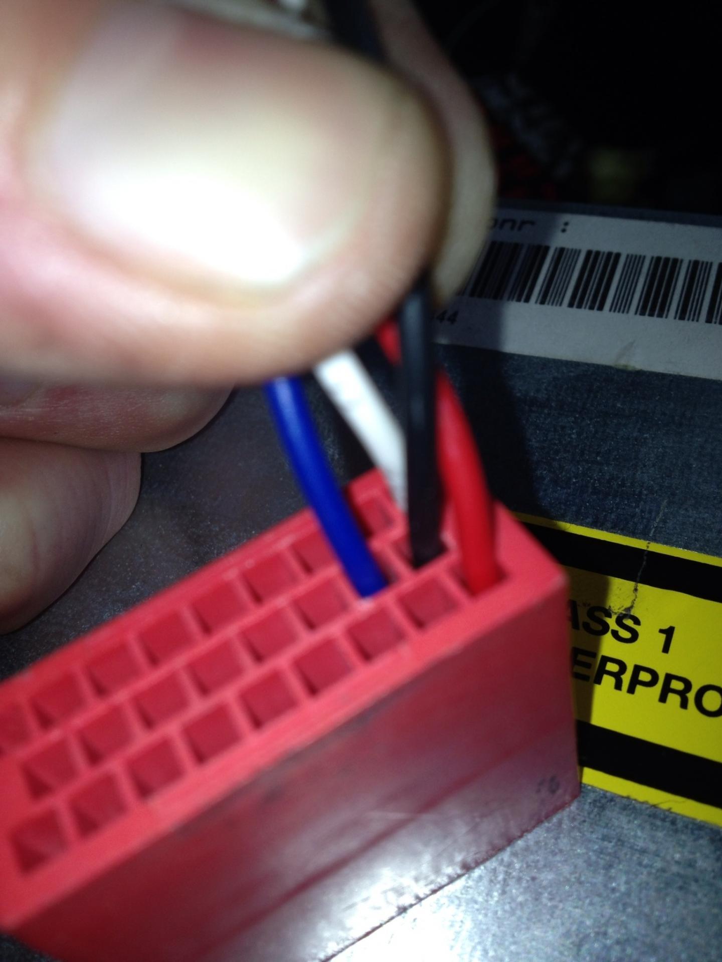

Had a bit of a look today and just to check popped the old head unit back in to check the front speakers and the worked fine! looked at my red adapter and the front speaker line outs are missing. my kit is for rear bose only!!
Cheers dave

Problem identified, potentially solved. And no sign of Ian.
