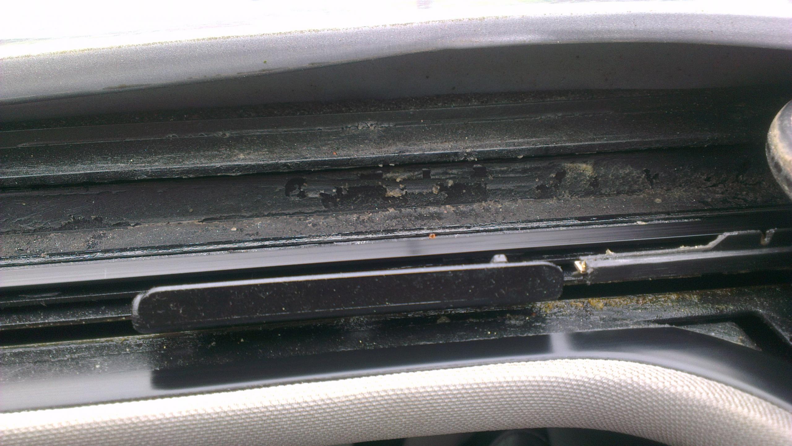

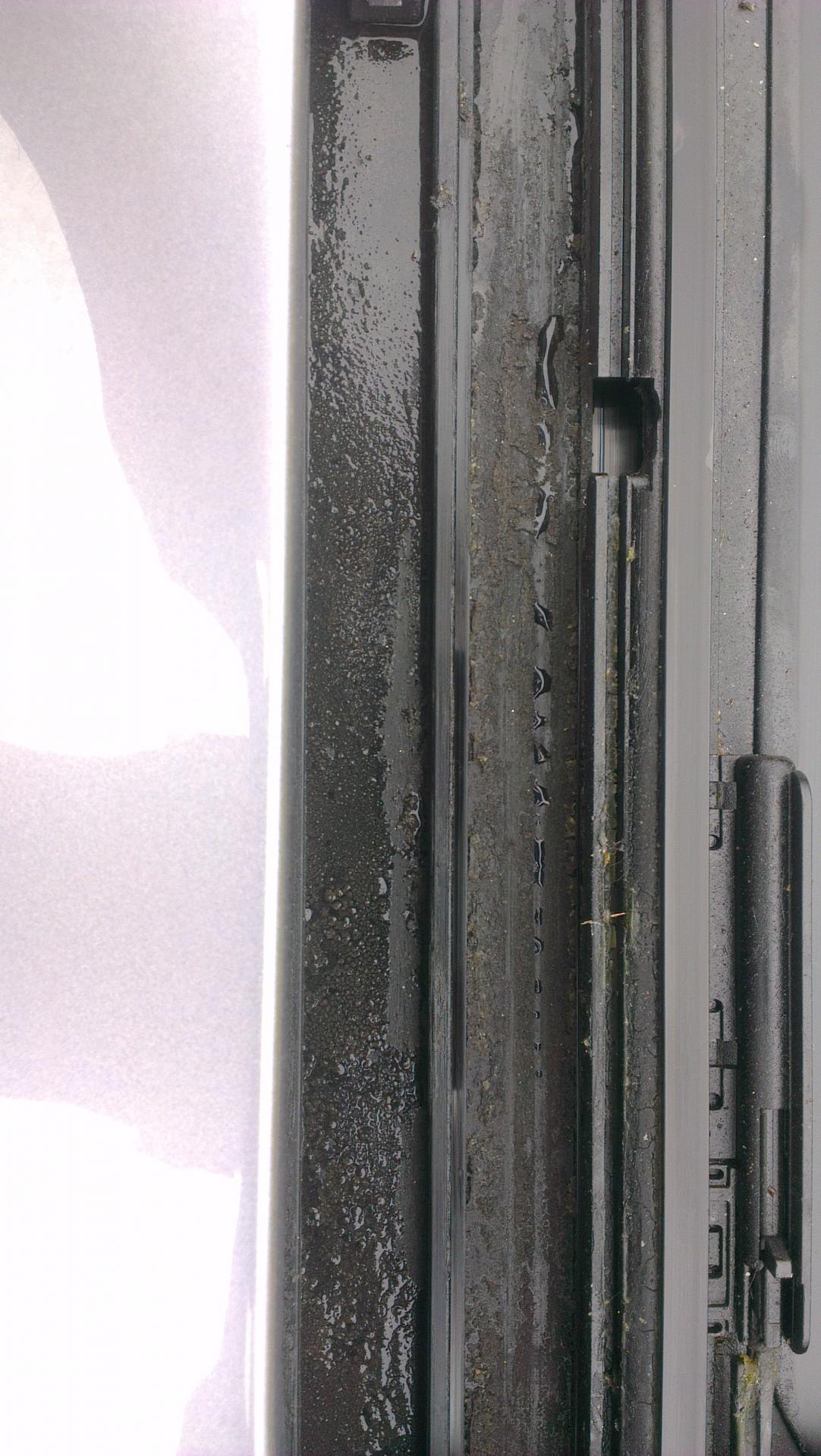

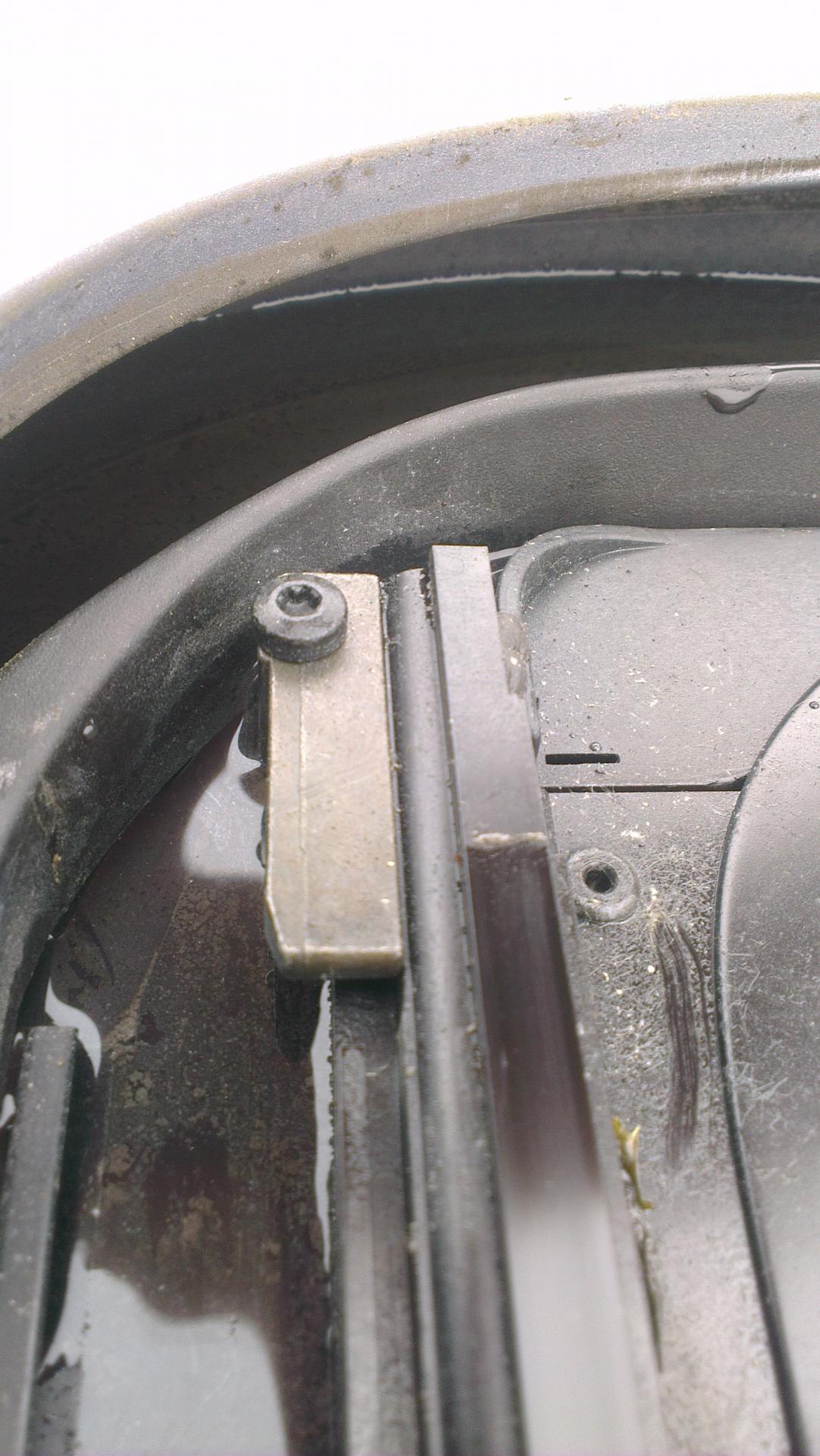

I was thinking about the sunroof today and for the short time it stopped raining I went out and took this video.
Is this the same noise as yours?
I also took some pics of the runners and you can see all the old grease dry and nasty.
I have a nice little pool in my roof as well.
I tried unblocking the drain hole but no luck.
Going by how much cable goes down the drain hole it looks like it gets stuck around the the wing area.
Does anyone the routing for the drains?

Old 5th April 2014, 06:21 PM
mannyo mannyo is offline
Location: Blandford, Dorset
Posts: 1,974
Mine groans when its closing, the sound is very simillar. I have a feeling the sound you are hearing is the wind deflector motor moving into position, on the D3 the roof, the sunblind and the wind deflector are all operated by separate motors.
Yep thats a blocked drain, mine was dry last weekend. As mine is a solar roof, your mechanism looks slightly different from above.
The video below show the electric wind deflector altering in height depending on speed, ok its on phaeton but the principle is the same.
https://www.youtube.com/watch?v=Zan9LVr4bO0
Apparently the motors can get noisy, and are easily replaced.
This video on youtube shows another sunroof making simillar noises, so maybe they are normal.
https://www.youtube.com/watch?v=RbJRcxMmyjU
